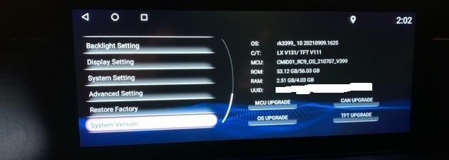

Update on the OS upgrade:
Did the update while driving to work and temperature sync issue is now fixed. Took a good 20 minutes. This upgrade will not erase your settings. I still have the trackpad settings and it auto synced to my phone and resumed on the last song it was playing.
To update;
Download the file.
Format USB to Fat32.
Copy the file to USB.
Insert USB to Android USB/Charge cable.
From the home screen, Tap on Settings ->System Version->OS Upgrade.
Wait for 20+ minutes.
Enjoy the new OS.

Here's the screenshot of my current OS
I guess if you ever get the expected file, just compare the version with this one.

I updated my OS it went well and only took mine 5 min to install. Lexion said OS file is the same across different models. It fixed graphic issue, temp 1 deg off, CarPlay now connects instantly but need to run a few more to see if it’s consistent. Happy with the bug fixes. File name is 20210909 so I assumed we have latest and greatest.
