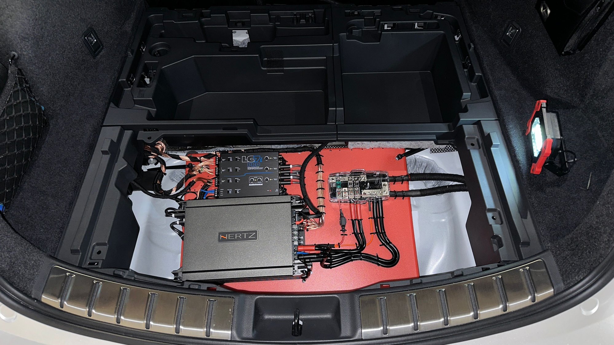

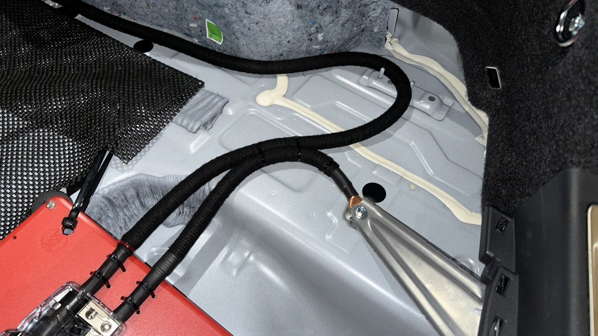

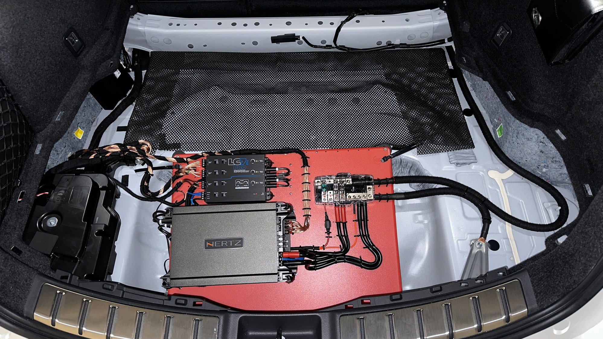

OK gotcha now I understand a little bit better my friend. I feel like people veer away from the front lower door speakers because it's a harder upgrade to do Due to the door panels having to fully come off and then if you're amplifying those speakers you're changing in the doors new wires will have to be run through the stock grommets in the doors which is one of the hardest aspects of installing in any Lexus. Also the oem amplifier only sends 60 to 1000 Hz to those lower door speakers so it's not a full range signal. Brand wise I feel like Hertz is very good because the build quality is great and the price point is very reasonable in comparison to other brands where you'll get lower build quality for equal or higher price. The front left and right dash speaker channels is a very clean full signal likely 400 to 500hz ranging up to 20K Hz. Because of that frequency range changing those speakers to higher quality drivers is going to give you a noticeable result without having to change amplifiers or wiring or anything of the sort. Will give you increased clarity and output depending on the sensitivity of the new speakers you'll be installing. Another reason why I like the Hertz brand is because they make OEM replacement speakers that can be powered by our stock audio systems and amplified and their very high build quality across their different lines. I'm running Hertz Deci 87.3 in the dash amplified and man Do they ever bring the entire system to life. I will definitely recommend to you is vet the shop that you're going to take your car into . Just assume that they will do a good job . Industry is saturated with people who think they know and can produce a temporary result but long term my damage or be harmful to your vehicle . Ask to see pictures of previous installs . You want to see clean wiring look how they connected the terminals for their wiring. Did they use pharaohs or is it just bare wire? If you're thinking about a place you can share their Google business here on this forum and I could check it out for you to make sure that it's a good reliable place that will do a good job. Also there is a lot of work involved in this endeavor so be prepared for a medium to high price point for this type of installation done correctly. If the price is too low for the installation I would hesitate towards the quality of the final result. It really is a lot of time and effort to do this correctly. Just letting you know my friend. Hope this helps and gives you a little bit of a starting point.
Here are a few pictures of my installs on my NX350 and ES350. Some of them may be mixed up a little bit between the two cars but this is just to give you an idea what the shop you're going to will be in for if they're planning to do it correctly. Hope this helps my friend.
