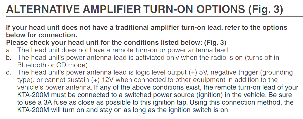

Thank you! I did find the cigarette lighter you're talking about w/ 12awg wire on Amazon now.
So, I THINK I found one that satisfies all conditions: Utilize rear 12V cig. plug, not overload the stock subwoofer, and acceptance of 12awg power wire. The model is Alpine KTA-200M. The only challenge that I currently have with this specific amp is that it does NOT have high level input so it won't turn on on its own by detecting the input signal (so I understand anyways...). Therefore, it appears that I need to tap the included "remote" wire into another vehicle wire that is associated with ignition switch on/off. I've included a screenshot from the manual. Is my best bet here maybe just posi-tap into the cigarette lighter 12awg power wire that I would buy from Amazon? Would that work? Or, would the fact that I've wired the power to this amp via the 12V cigarette lighter basically wake up the amp whenever I turn on the car without having to do additional wiring?
(The Kenwood one that I was looking at is KAC-M3001 but with it requiring 10awg wire, probably not a safe choice with my power wire being 12awg right...? This one does have speaker level input so I wouldn't have to worry about the powering on part but yea...)
