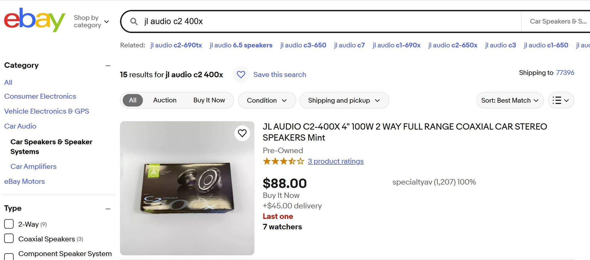

Originally Posted by goald
Did you ever end up finding one or purchasing a pair? I'm about to pull the trigger, if you have an extra I'll buy it from you, or vice versa.
Try eBay
