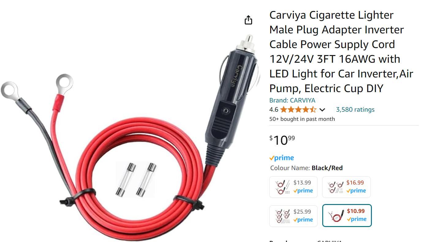

Btw, I am more than ok doing research myself once the parameters are set for the amp but since this is my first foray into this area, I am just a bit lost in terms of which amps that I am able to power by using the rear 12V outlet. What rating/specs should I look for when it comes to the amp so I know it's safe to use my 12V outlet along with the connector that the previous posters have all suggested.
Also, what is the ideal wattage of the mono amp should I be looking for to power our default Lexus sub and not potentially overload it?

My Pedestrian answer 10A looked it up in the manual,

The lighter's max 10 amperes outlet (in the case of a digital amplifier means 10Ax12VX0.8=100W) is consistent with the 50-100W load capacity of the factory subwoofer. Choose the possible smallest power (2 ohms) amp, because a strong amplifier can creates harmful resonances in the body in addition to destroying the sub - until the 10 amp fuse blows. If you put amp in a closed space it should be exclusively digital class, the A/B class can overheat. It is recommended to have a subsonic filter so that you don't plague the sub with unprocessable signals below ~30 Hz.

Fairly easy to do if you have the Hybrid model as the 12v battery is in the back, but more of a challenge if the 12v battery is in the hood compartment. The issue is that you need a much larger diameter power wire than is furnished thru the 12v cigarette lighter receptacle wire in the back compartment.... the topic has been discussed w/in the 300 plus posts.... (I've installed the Taramps amp and so far is trouble free and gets the job done-NX350h...)
