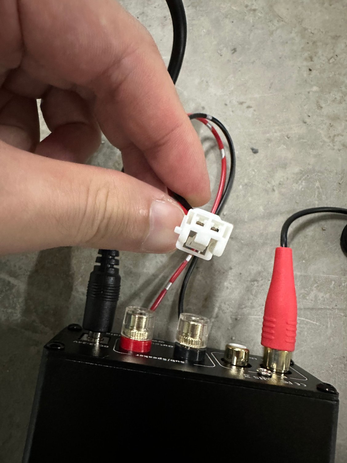

Hey buddy...I'm just done the fosi method and here u go on all the connection you need. Hope it helps.
This really does, Thank you for putting this together. Question - Which end do I connect to the purple/green wire? From the Fosi amp? Or the Converter? Also, how do I splice into the AC plug using the 12V Power Converter?

2nd photo (white female plug) goes on the RCA.
white male plug (plugs into the sub's female) goes into the amp's threaded **** connector.
Based on posted photos

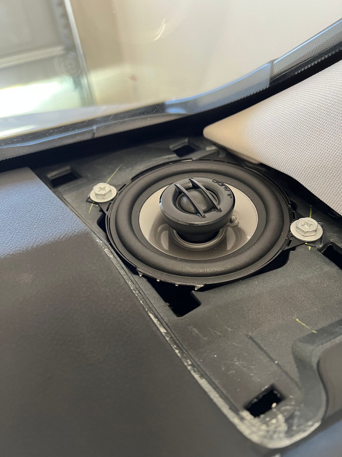

To people who may be interested in JL C2-400x on your NX 350h, I'm here to give my two cents.
  1. First off, don't worry about the size. It fits pretty well in the hole steadily with only cut off two tabs on the speaker itself. No issues with the screws, they fit perfectly even better than other 3.5" speakers.
  2. Coming to the audio quality, it sounds amazing to me. With only two corner dash speakers replacement, I'd say you'll get like over 60% sound improvement in terms of clarity, deepness, and smoothness (you name it).
  3. Budget wise, it doesn't hurt you much if you're already after JL C2-350x. With additional 20 bucks you'll get a noticeable amount of lower frequency and higher clarity imho.
All in all, I'm extremely satisfied with the result. If I were to further make any modification, the powered amp on the OEM sub would be the next.
passenger side with new JL C2-400x

Right, I did go through all replies under this thread before I decided to get my hand dirty, so I was aware of this. Because I was so into that marginally better sound quality that 4" speakers could bring, I eventually try both of them on dash just so I can compare both with my own ears. To me, the 4" speakers are indeed better than the 3.5" ones, regardless the size of the plastic grill above, thereby I finally went with the larger.
Again, this is only my two cents, and I do appreciate everyone in this community to make this happen easier! I can't and ever can't represent any other individuals, this is only my own experience.
