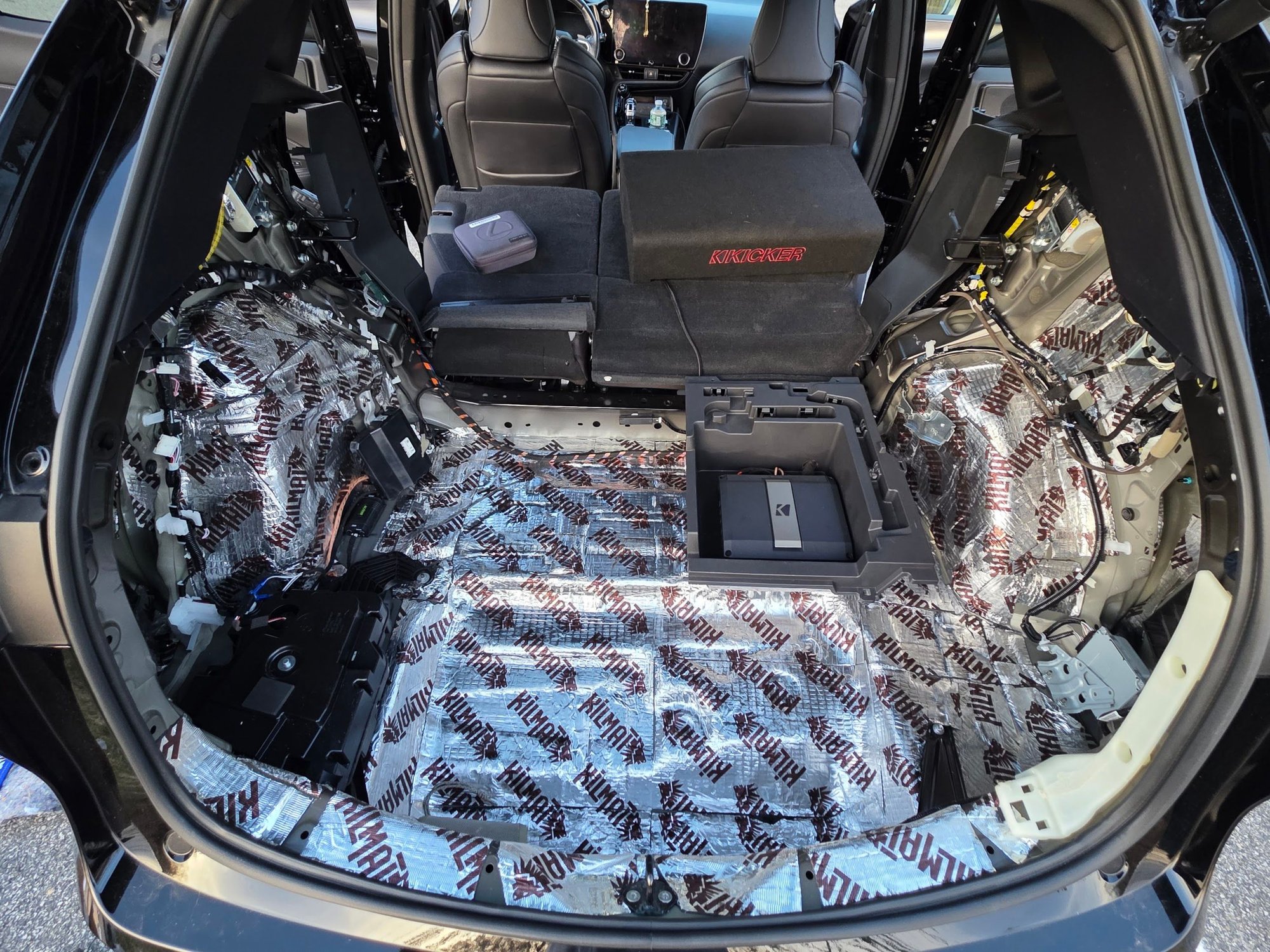

Originally Posted by hexpletive
So far it sounds great.
It's only been in for a couple days so I'm still running through a lot of my normal music listening for resonance issues. I haven't really found anything that is annoyingly rattling around yet.
I did lay some sound deadener directly under the sub but I didn't go crazy with it. I doubt it has much impact in this car with the factory deadener/sound absorbing material it already has. But I was already in there anyways and had some deadener material.
I'm running a pretty conversative gain setting on the amp. I originally set it just below clipping with a 40hz -5db signal at 50 volume on the head unit and it was too much for the rest of the system and was overwhelming everything else. And big boomy bass isn't really what I go for these days.
I thought I might try it up firing if I wasn't getting enough bass response down firing, but I don't think I'll be doing that anymore.
The trunk liner still has the hook on the right side holding it down. With the rear seats in the recline position those also hold it down pretty well. I have to put them up to the normal position to unclip it from the storage bin.
That amp looks like it should be fine for that sub.
Kicker 49L7TDF102
2-ohm total impedance
power handling: 500 watts RMS (1000 watts peak power)
Kicker 51LX850.1
500 watts RMS x 1 at 2 ohms
You don't technically need a LOC because the amp has high level inputs and signal sensing turn on. But some LOC's like the 47KEYLOC have additional features for more tuning options.
Completed the install over the weekend. Love the upgrade, what a difference!!

Great pictures and thank you for sharing them. I have to deaden my rear door on my NX as well and I'm wondering, did adding the sound treatment to the rear door like you did add additional weight and in any way affect it opening and closing? Once again thank you for sharing these pictures my friend.
Appreciate the feedback!! I have not noticed any difference in opening and closing the hatch. Works just fine from my experience. Fairly easy to take everything apart just get trim tools and go slow. Lots of nooks and crannies you can fit some material in. The more the better. inside the cabin sounds great and controlled now.
