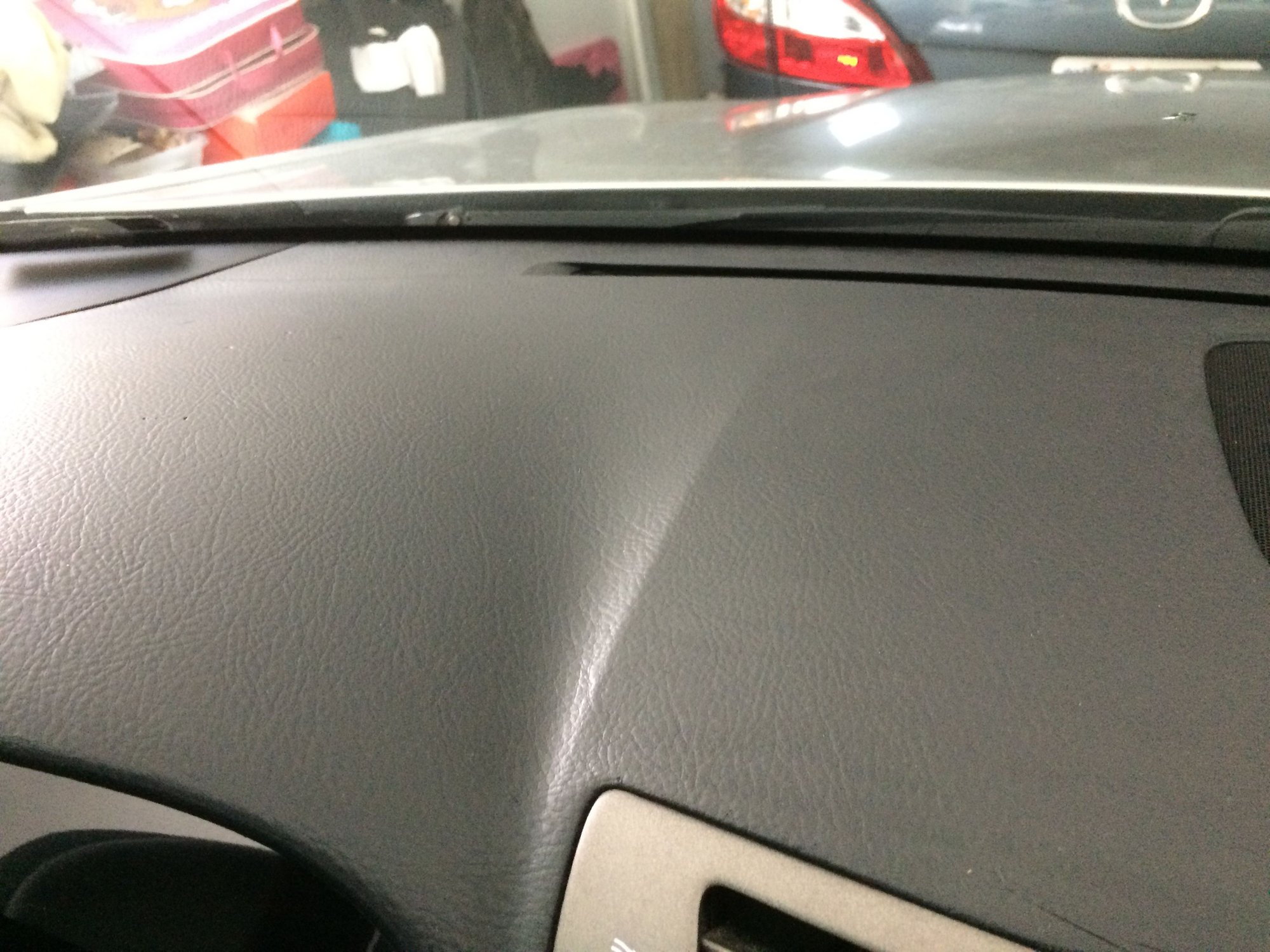

I also did the Sticky Dash Fix. I'm happy with the results and also used a small roller kit from Home Depot to minimize the streaks. In addition to the $50 kit, I bought additional surface coating. I was chatting with the vendor and he offered my two for the price of one for the additional surface coating and filler. Sugru was really helpful with cracks and divots. The SDF filler was not that useful as it was too much of a liquid for my repair. Attached are some before pictures.
Can you provide after pictures as well?

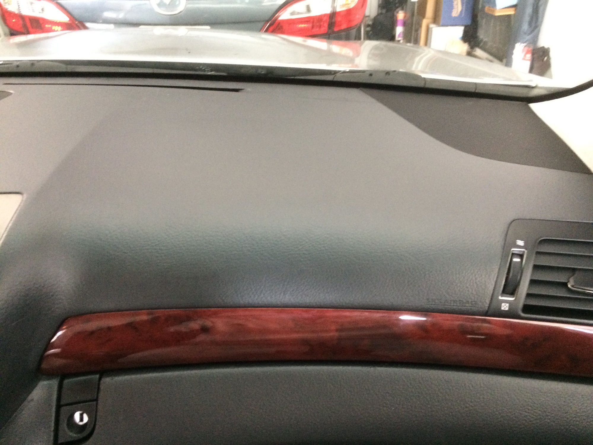

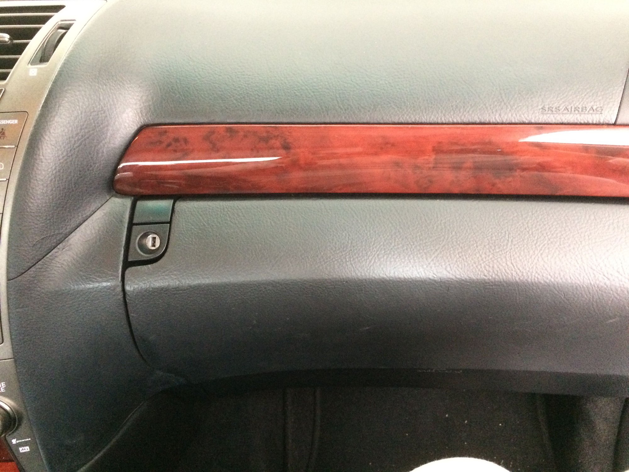

Here are some pictures as requested. Doesn't get all sticky anymore after treatment. Did around 2 coats on the dash and door panels and still have a little left over from my first surface coating bottle. Have my other 2 bottles in reserve as may need to re-treat in the future. Pretty inexpensive fix relative to other options even if it last only a short time.

Looks great - thanks for the pics
