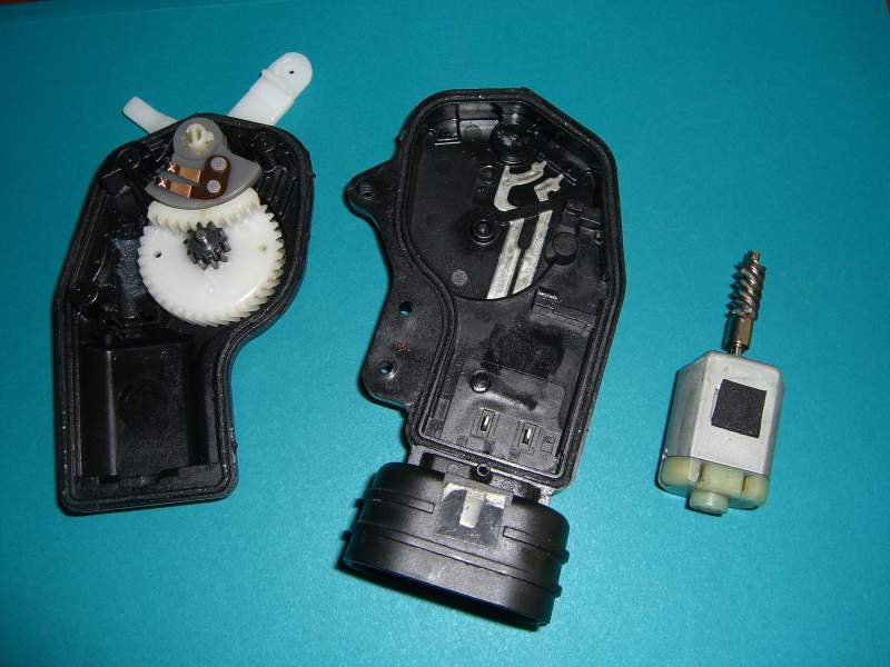

Originally Posted by jdm93400
Anybidy? Any answers ? Wish someone knew
I have fixed many door unlock/lock problems and 80% of them were caused by the badly clogged motor inside by the dust of brushes. Others were completely worn brushes, failed Posistor (too big resistance) and lubrication issues. 80% of them were OK after just cleaning the dust.

Chill bill. I was hoping for someone post pictures.thats all i wanted. Iv taken off iv nevr seen that black motor..now i know.. thnx im tear apart my actuator
