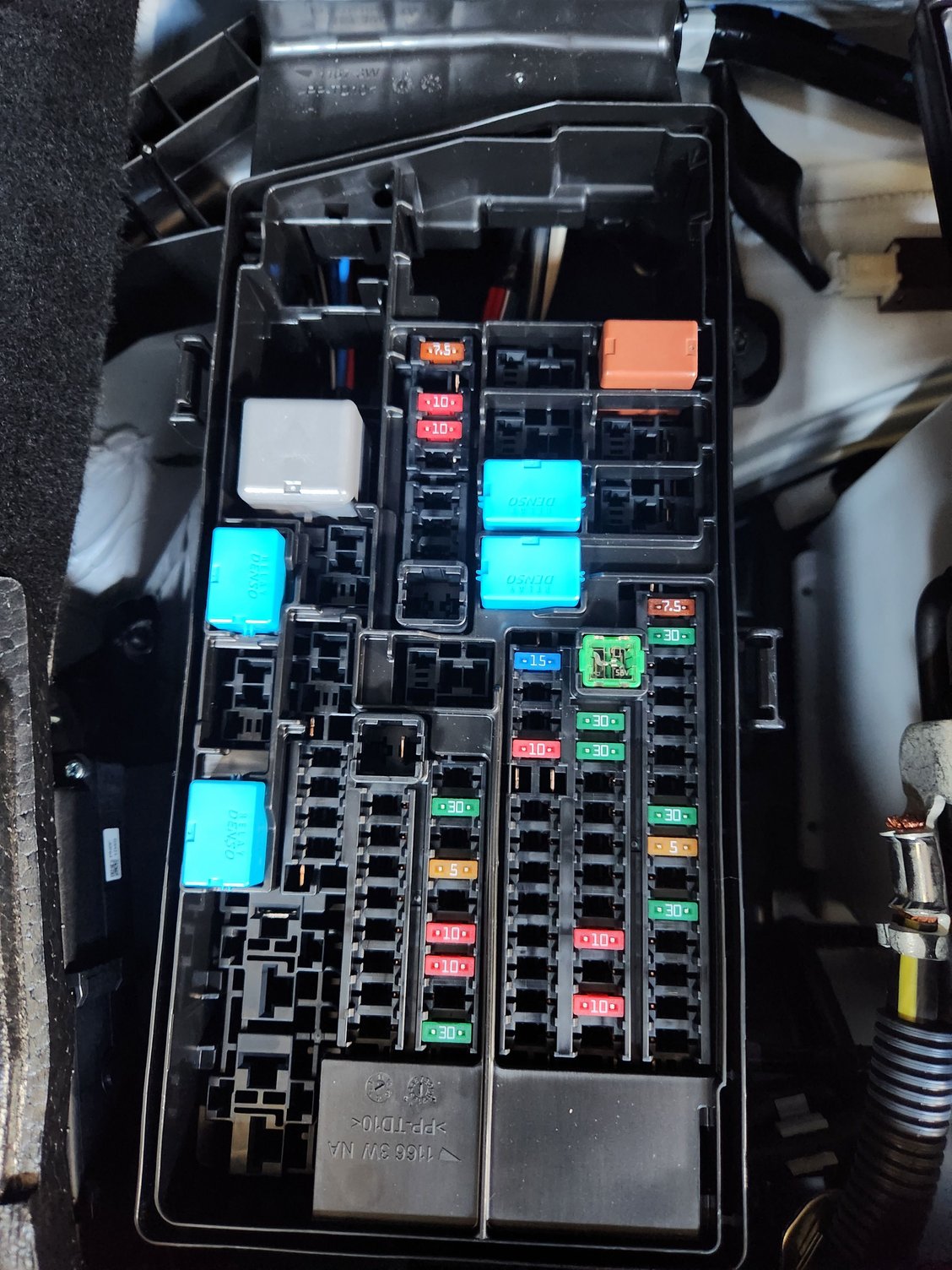

My box (2024) looks different than yours.
Show us the legend on the lid.
Mine is a 2019.
here it is. The same "EFI No.5" seems to be missing from mine.
I see it plain as day...just relocated. 2nd row from rt, 4 slots down.
Yeah but in OP car that fuse doesn't exist, there is no fuse in that slot in the earlier Pic
