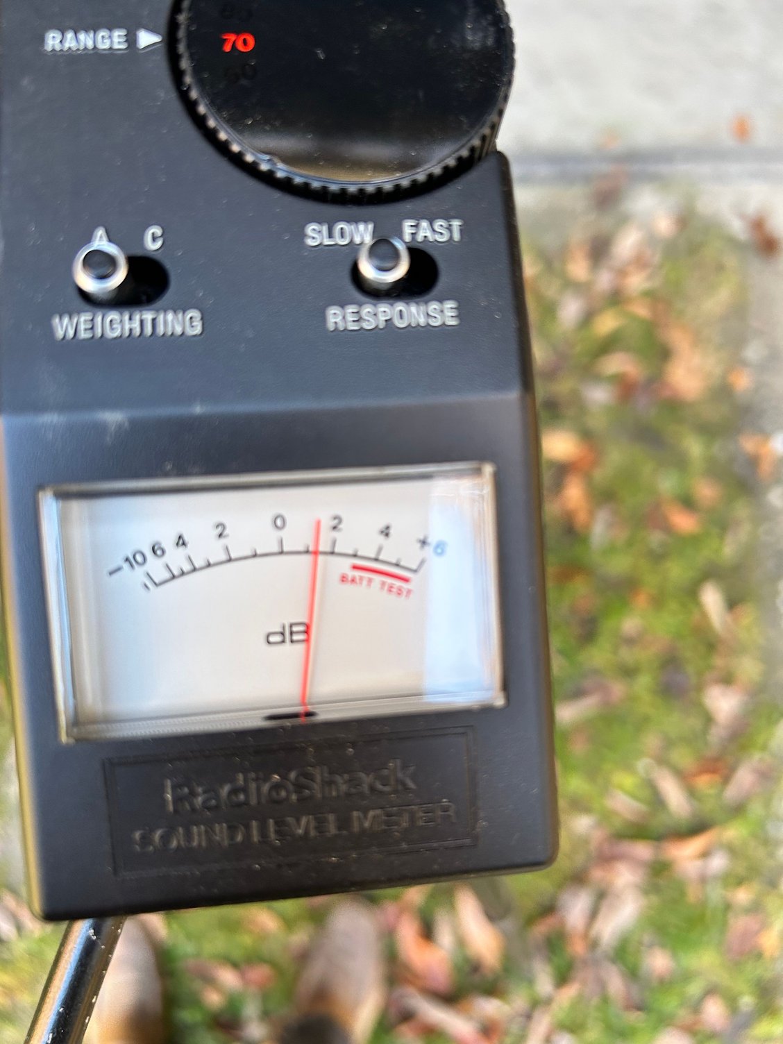

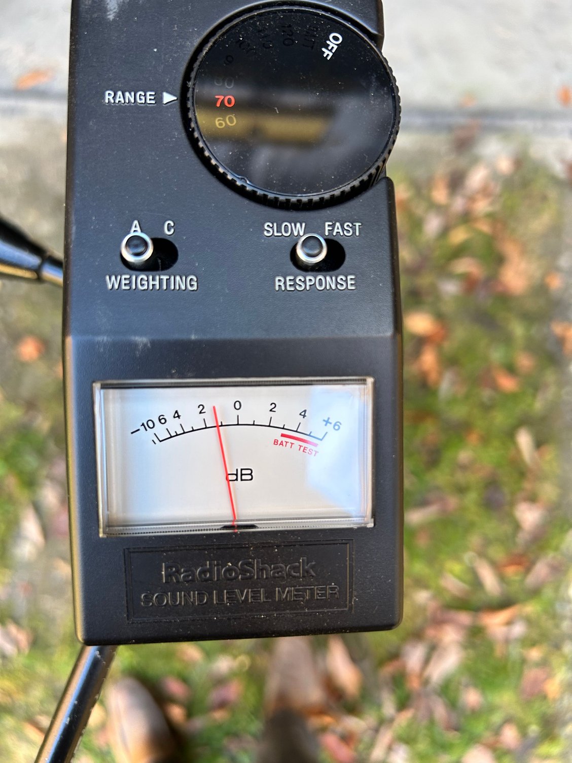

Magic blue pill installed…
Magic blue pill removed…
[img alt="…and here’s the magic blue pill! Removing it increased warm idle sound energy by 2 or 3 decibels (A-weighted scale). 2018 LC500, 37,000 miles. Big difference until you get the gas open hard, when the muffler valves would be open anyway. OBD showed no codes with this fuse pulled. Car sounds even more fantastical than it did stock, but no change I am aware of re fuel economy.
Lots easier than unplugging connections under the car. "]https://cimg4.ibsrv.net/gimg/www.clublexus.com-vbulletin/920x2000/img_5145_4673712df71d2c2b355bca359cc2e4013e808749.png[/img]
…and here’s the magic blue pill! Removing it increased warm idle sound energy by 2 or 3 decibels (A-weighted scale). 2018 LC500, 37,000 miles. Big difference until you get the gas open hard, when the muffler valves would be open anyway. OBD showed no codes with this fuse pulled. Car sounds even more fantastical than it did stock, but no change I am aware of re fuel economy. Lots easier than unplugging connections under the car.

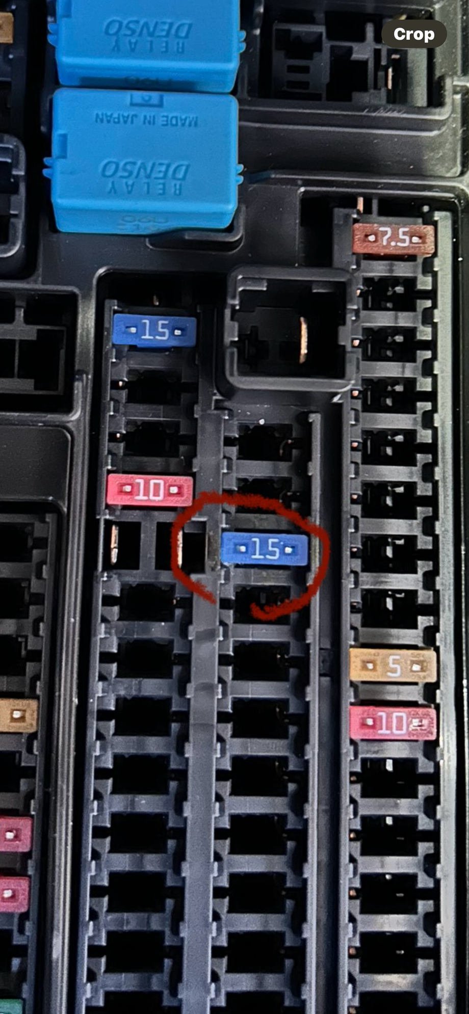

Sorry. Here’s the magic blue pill: 15-amp fuse. Photo didn’t originally post.
