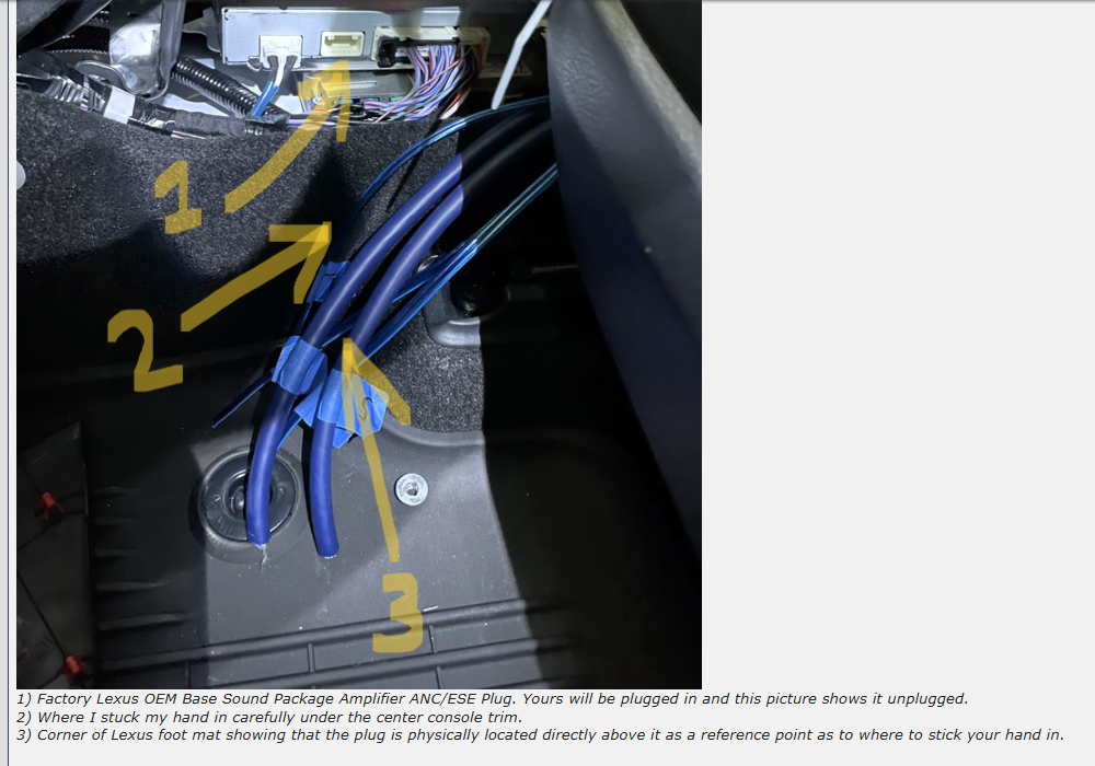

Please how did you de activate Active Nosie Control (ANC) after your subwoofer install?

hello guys we just did a full system in this car I mean the customer said Lexus and every other shop told him you can’t turn that radio up more than 48-50 without it turning off but it sounds horrible. Well now the radio at 35 sounds amazing. We put 2 8” speakers , 2 4” behind the seat 2 4” in the dash, and a 10w7 jl in the back, problem is that car never fully goes to sleep the active cancellation Mic was the hardest part

I believe it is as simple as pulling one of the plugs on the amplifier in the trunk area, as least in the IS models. I think I read that in another thread.
