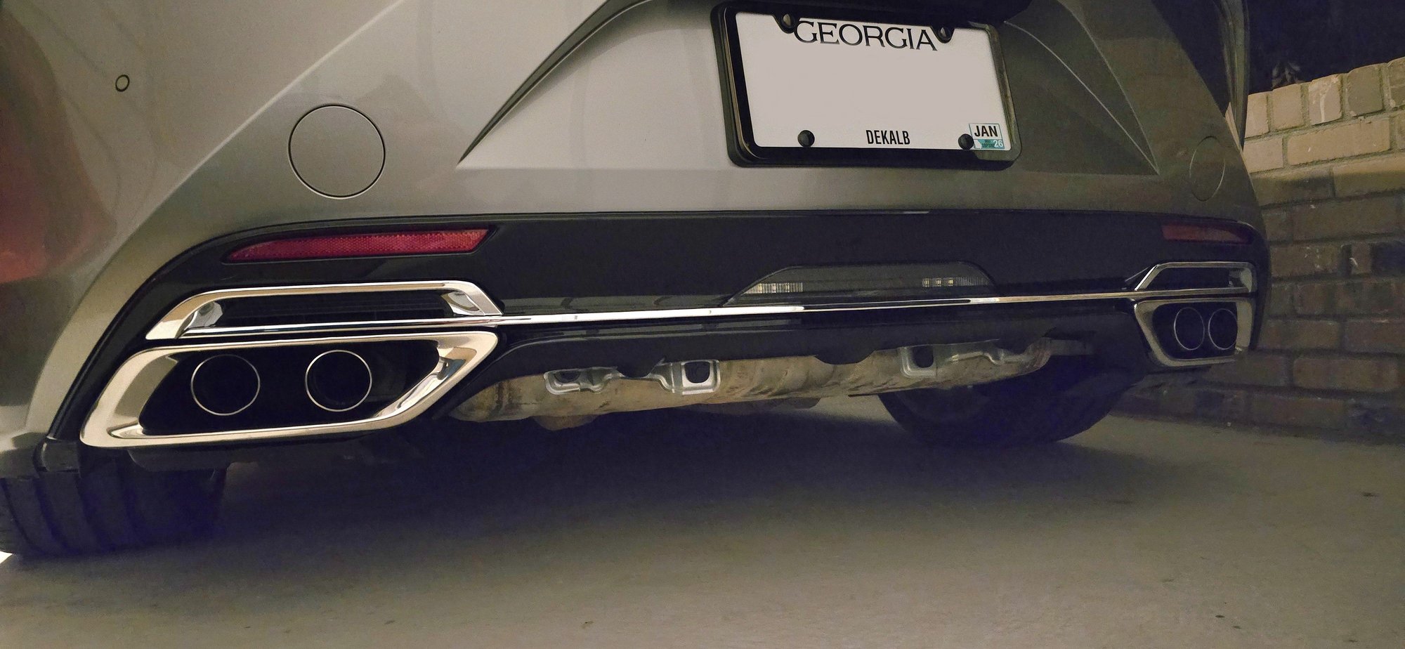

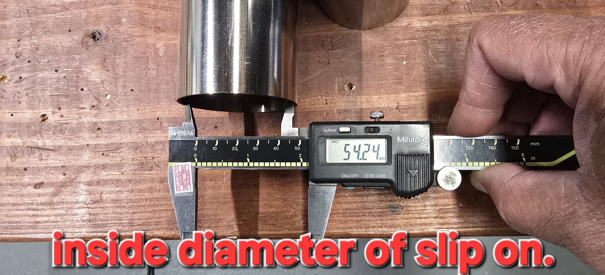

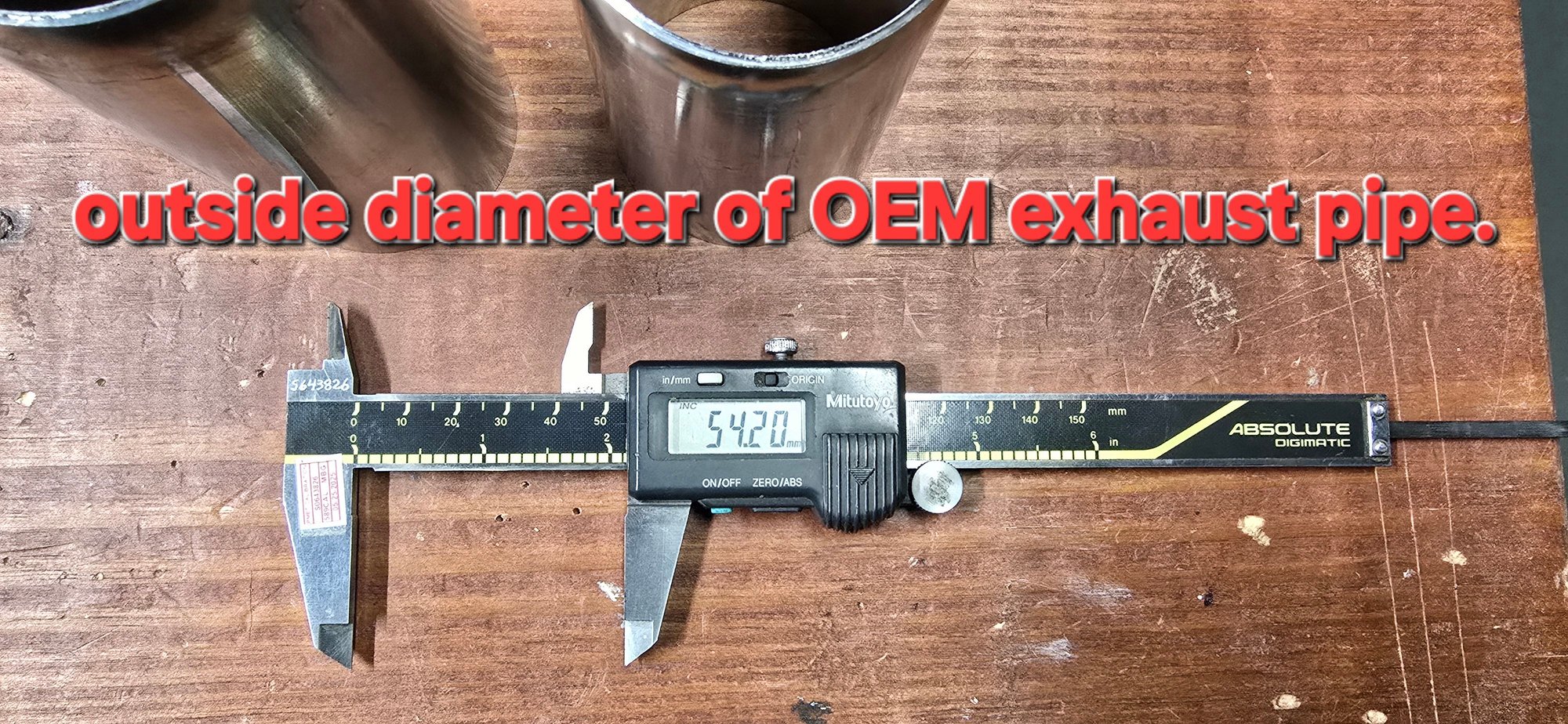

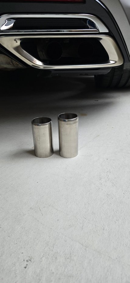

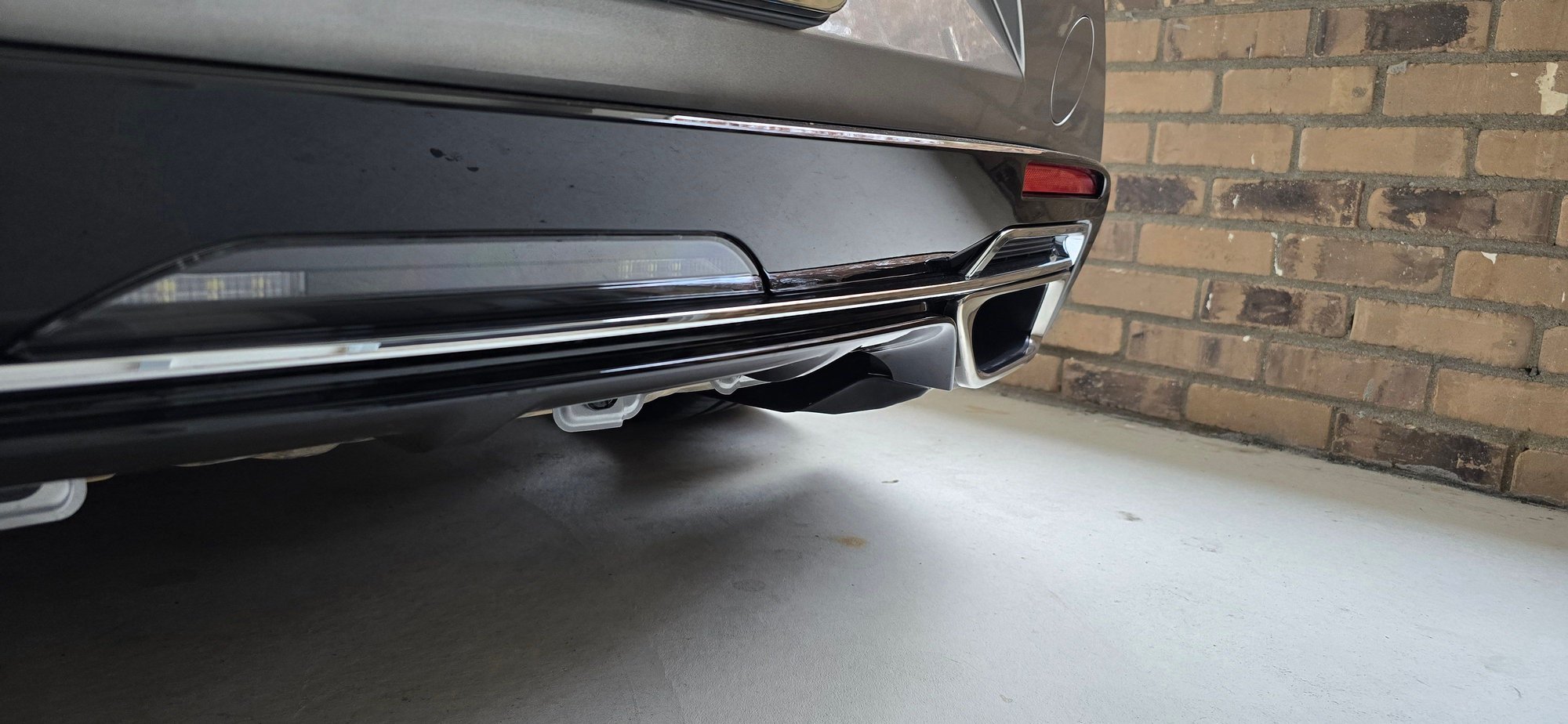

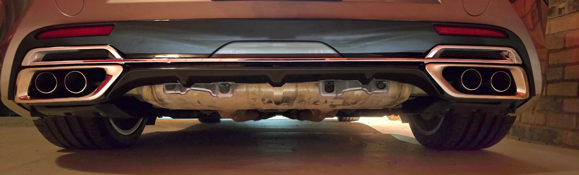

A few pics of my custom Tim Tip's. I wanted to keep the look of the exhaust surrounds with a tip that didn't look too big.
57mm x 1.5mm x 500mm is the perfect size piping to slip over OEM exhaust pipe.
Amazon.com: Stainless steel hollow tube 304 Stainless Steel Pipe Hollow Straight Metal Tube 54mm57mm60mmOD1mm1.5mm2mm3mmWallThickness 500mmLength,57mm*1mm*500mm(60mm*1mm*500mm) : Industrial & Scientific Amazon.com: Stainless steel hollow tube 304 Stainless Steel Pipe Hollow Straight Metal Tube 54mm57mm60mmOD1mm1.5mm2mm3mmWallThickness 500mmLength,57mm*1mm*500mm(60mm*1mm*500mm) : Industrial & Scientific
Just not very visible.
quad exhaust is invisible.
quad exhaust...WHERE???
There they are.

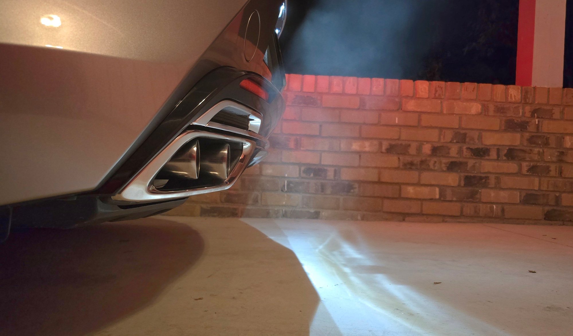

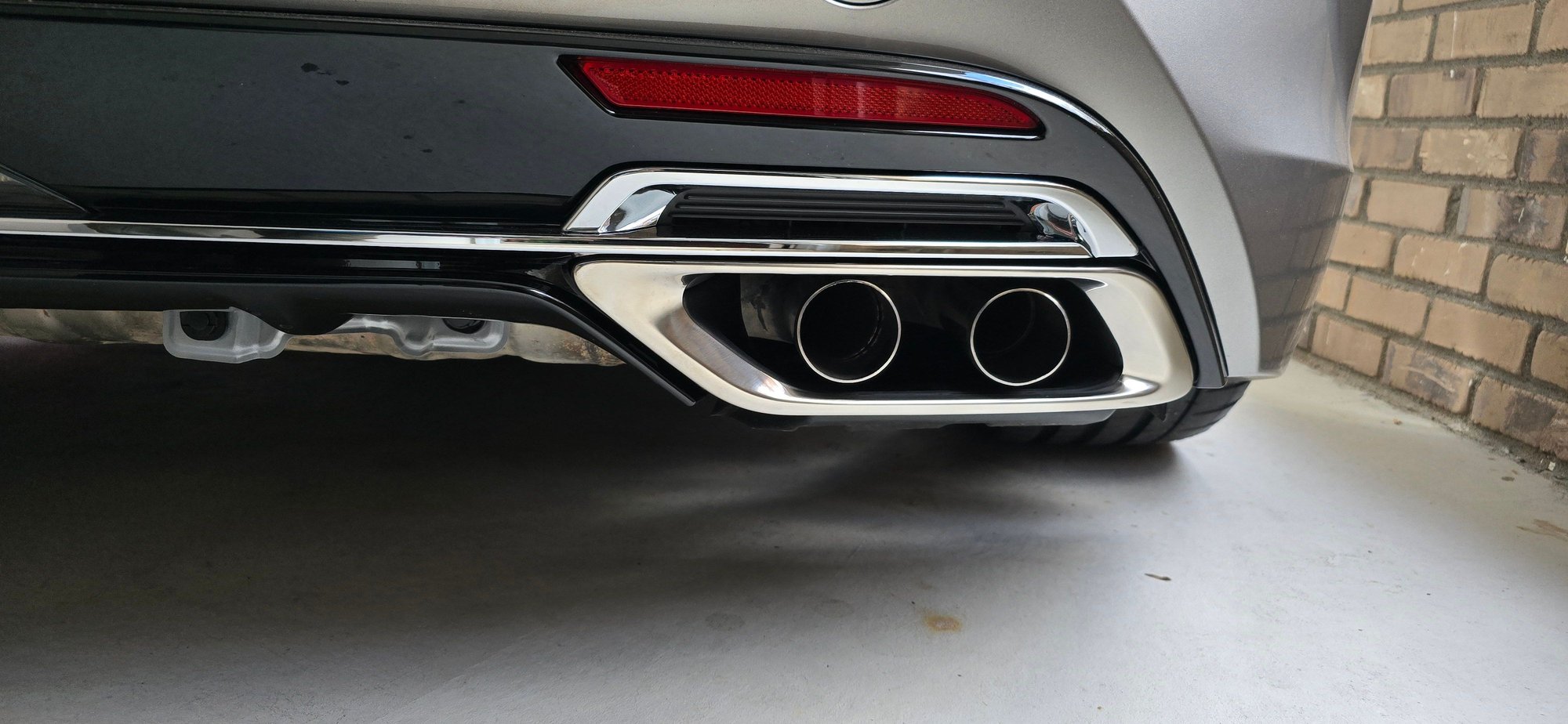

There they are...Tim Tip's. Juuuusssst enough to show off that big V8's quad tips.
much better look.
much better look, in my opinion.
nice slightly rolled tip, typical of pipe cutting.
nice, slightly rolled ends, typical of pipe cutting.
stainless steel.
stainless steel product.
inboard/outboard tips.
pipe cutter.
pipe cutter.
maybe not exact but pretty accurate.
I'll apply a bit of this exhaust sealant around the tip of the OEM exhaust, before I slip on the Tim Tip's.
Another option are these 2.25" clamps. (if clamps are used, cut a few 1" slits into the Tim Tip's before slipping them on).
Amazon.com: EVIL ENERGY 2.25 Inch Exhaust Clamp,2 1/4 Amazon.com: EVIL ENERGY 2.25 Inch Exhaust Clamp,2 1/4" Narrow Band Muffler Clamp Stainless Steel for Pipes,Mufflers,Catalytic Converters 2PCS : Automotive

Thanks, you're very welcome...haven't done the permanent install yet and not marketing them. Just a lil DIY project for myself. I've done all the heavy lifting; you guys can take it from here...LOL.
I thought about extending them a tad bit past the bezel but finally ended up liking this look better.
I'm going to clean them up a lil then spray with VHT Flameproof Clear Satin finish.
Here are a few more 'dry fit' pics of the overall look. Thinking of blacking out the upper chrome trim pieces too. Definitely going to paint those lower metal brackets black.

I really like the profile, looks good. At first I was thinking it might be better if the tips extended further out, but after seeing your additional pics, I think it's spot on for me. It looks more sophisticated and OEM, less of a speed racer look. I like the straight forward install, but not sure about the cement. If the tips started to discolor i want to be able to remove them. From one LC owner to another, i appreciate you sharing & doing all the heavy lifting for us!
BTW... Im not a fan of how Lexus engineers designed the bezel surrounding the tips as well as the chrome looking piece above it. I haven't seen any aftermarket options I like. Some of the carbon options are nice but kinda pricey for what they are. So far the only thing I've added was the Key Card, otherwise it's stock.
