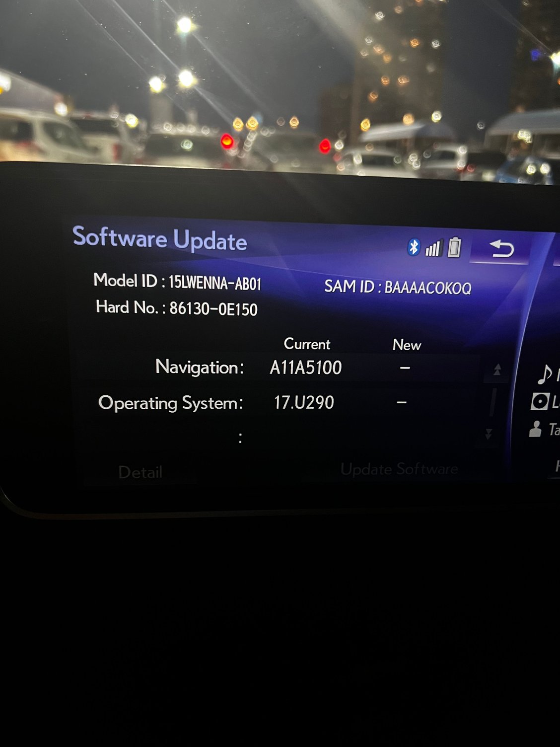

Hi. I have a 2016 GS (350 F-Sport w Nav) and my firmware updated from A11A5100 to A11A5770
The file that the Lexus Download site chose for me when entering VIN is 15LWENNA-AB01_0003.kwi, is that incorrect, should I try updating to the 15LWENNA-AB01_0006.kwi?
Since I have the 12in screen I believe the 0006 is the right version but its not available on the website.
