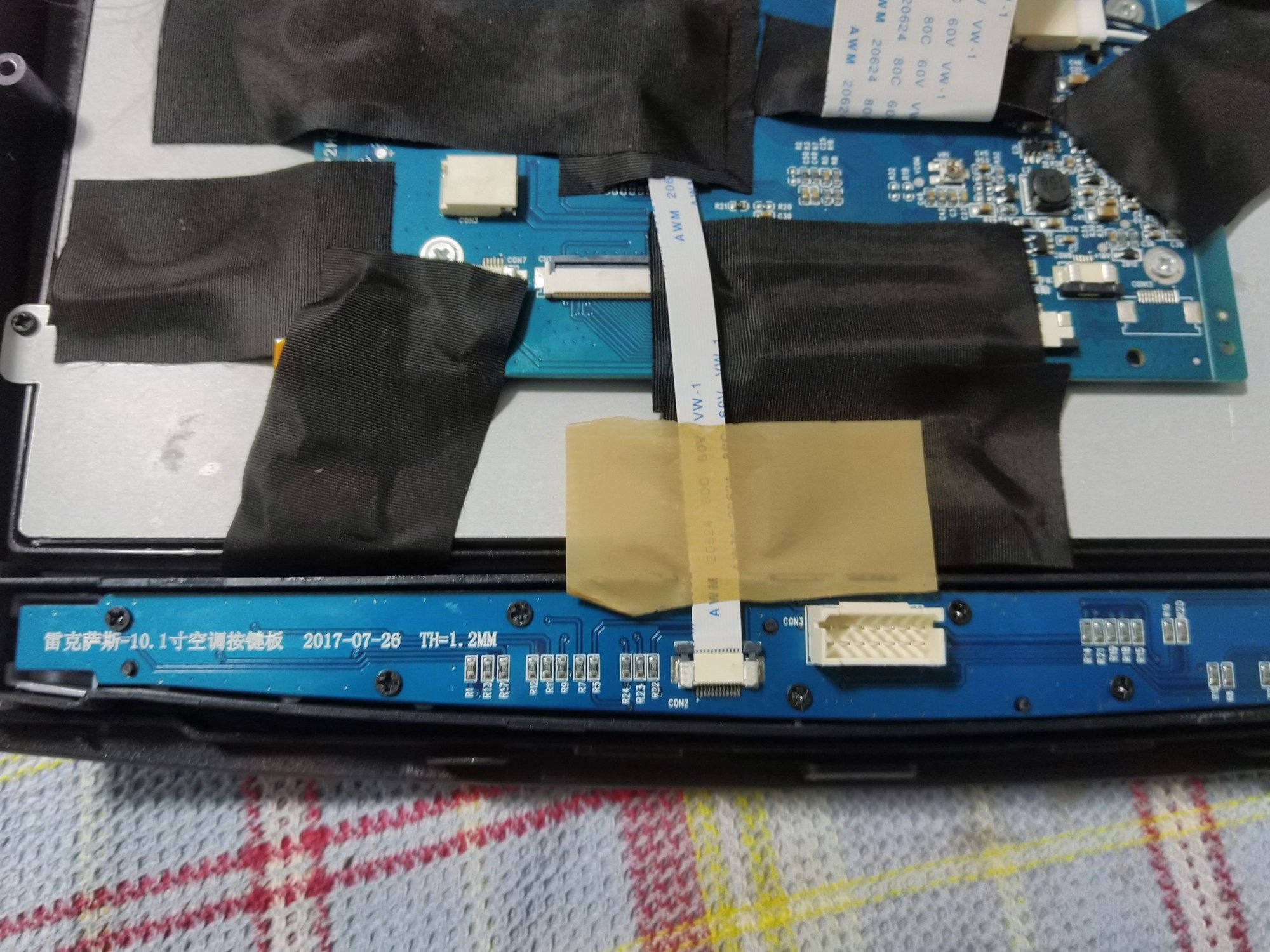

Slight update on my install. I was send a new board by the seller as my Hazards didnt work. Fitted the new board and same issue.. everything works great apart from the hazard button,
Am I right in saying that the wire for the hazards is in the black that fits on the side of the Nav? I believe it is but having trouble confirming. The saga continues. I think Im going to ask for a new loom/wiring set.
Edit: Just checked and its position 12 on the block. Looking at the loom, I have a wire going in but no pin in the block.. think I might have found the issue!
I have the same issue even more AC buttons dont work could you please help . Is there a wire I should connect in the lower motherboard ? Thank you

That plug you can see in my pic should have a cable plugged in when you fit the unit.
Is it all the buttons along the length of the unit that are not working?
Yes all the buttons are not working. Do you remember if the cable is coming from the car to the unit or from the unit cable harness ? Because I didnt plug any wire in that plug

Yup, i think you just havent plugged in the small cable on the loom into the back of the new Nav
Its just a small cable that you havent plugged in I think, its not from the car but from the new cable loom that comes with the nav
A pic with a circle around the area Im meaning:
