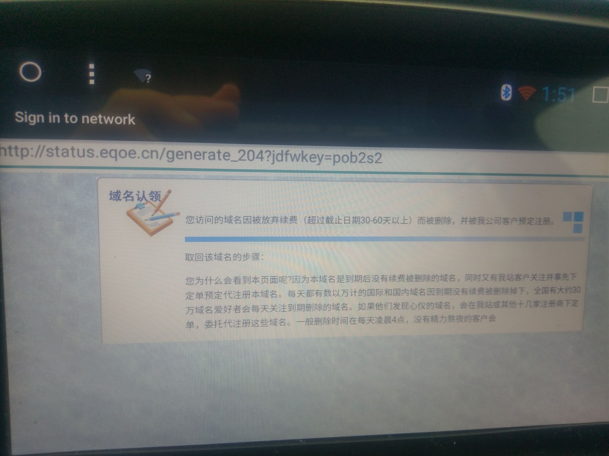

Anyone know the reset password for the device? My Wifi says connected but no internet. What's wierd is that the internet does work for Google Play and signing into account. Worst part is when I connect my phones wifi hotpot, I get a message that I gotta log in and I see this. I don't have the device rooted, which I thought I did. If I can root it I can probably fix this problem.

I may know why this is happening and it's probably due to a Google update. Resetting the device does nothing to fix this I'm told. The solution though may need root access.
Code:
Finally there is a solution for this problem. At least for rooted devices.
1. Device must be rooted
2. In the terminal emulator (app from Playstore) execute the commandsCode: Select all
Code:
su
settings put global captive_portal_server google.com
3. Reboot device 4. Connect wi-fi manually 5. Reboot device After reboot, it should connect automatically
Here's a better explanation why this happens.
"Each time your Android device connects to a Wi-Fi network, the system performs a Captive Portal Check. Android aims to ensure that your device has not only received an IP address from the access point, but can actually reach targets on the Internet. This is necessary, for example, for the detection of portal pages of WLAN hotspots (e.g. in hotels). Android sends a request to the address "connectivitycheck.gstatic.com" for verification. If the request is successful or is answered with HTTP Response Code 204, the Internet is accessible. With this request, the system transmits information about the IP address of the connection, the time of Internet access and which browser is currently used to Google.If you block this request to Google via AFWall+ or anywhere else in your network, a small cross will appear on the Wi-Fi icon in the Android menu bar. Depending on the Android version, a message will also appear that no Internet is available. However, privacy-conscious users in particular do not want to send a "ping" to Google every time they go online. There is now a solution that works on rooted and non-rooted devices."

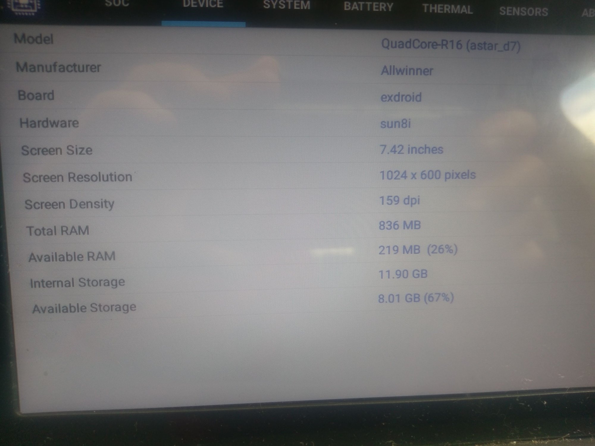

Originally Posted by BabyGate
I don’t think this unit can be rooted. Post a screenshot of your android and mcu version. If it is the same as mine, i can send you the firmware file, and you can try flash it.
Thanks, here's some photos from CPU-Z.

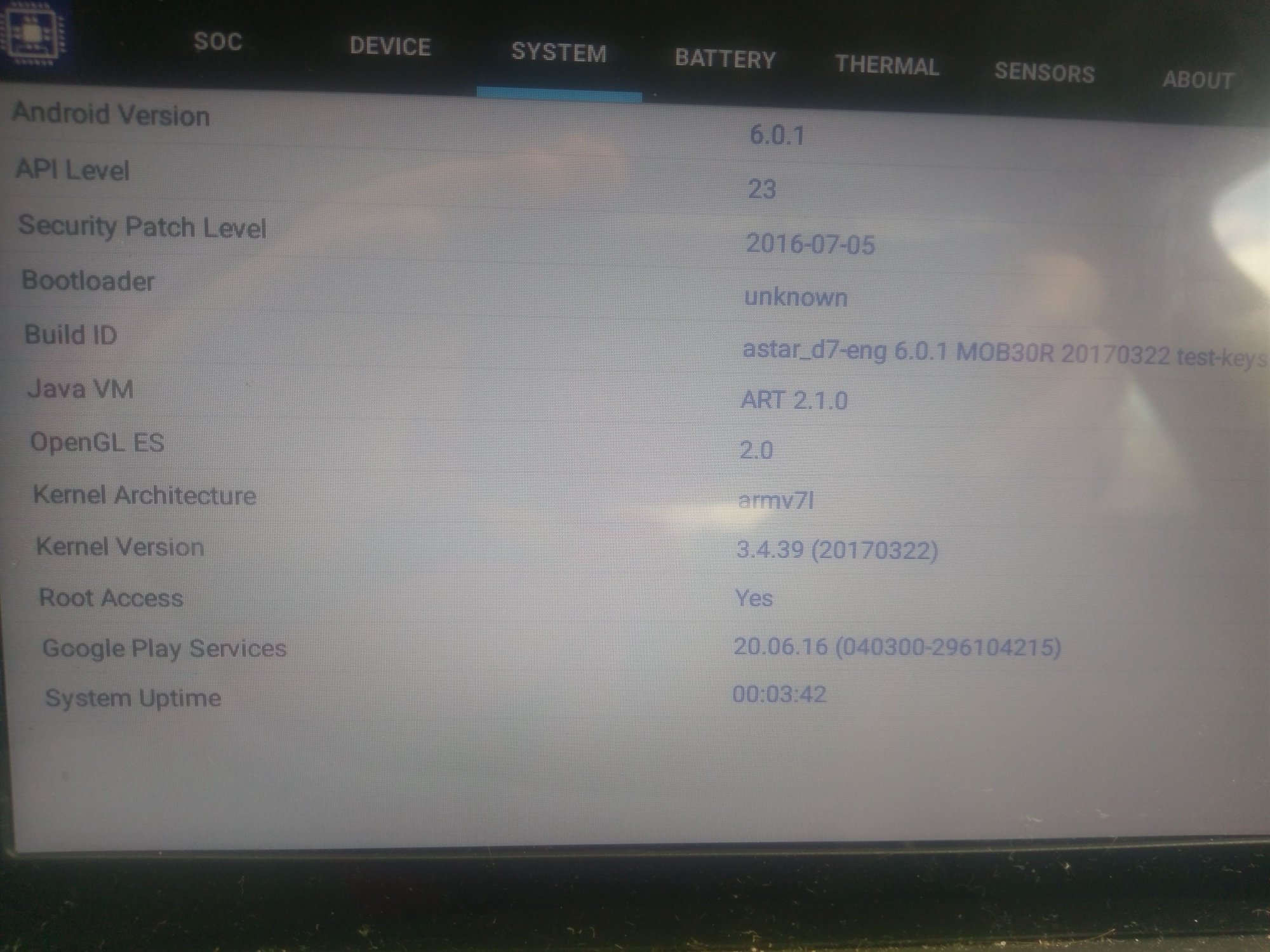

Just realized that CPU-Z doesn't show the MCU. So here's the MCU info.
Ah. Mine is Android 8, while yours is 6.0. Sorry the firmware (V9.3.1) i have won’t work on your unit. Try google the exact system version you have and see if there is a copy out there.
