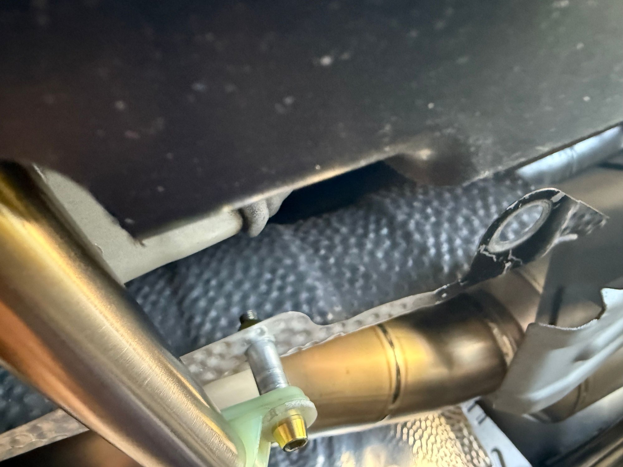

Originally Posted by Rossi

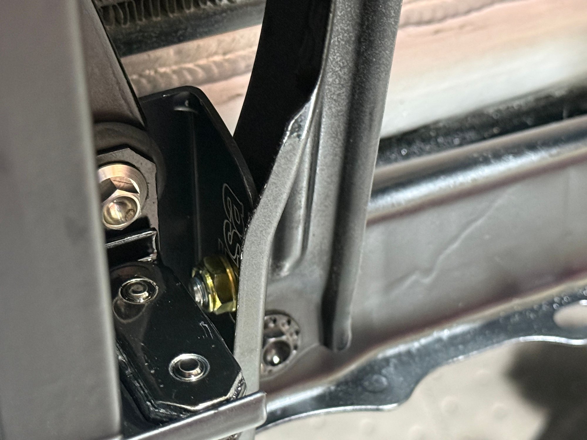

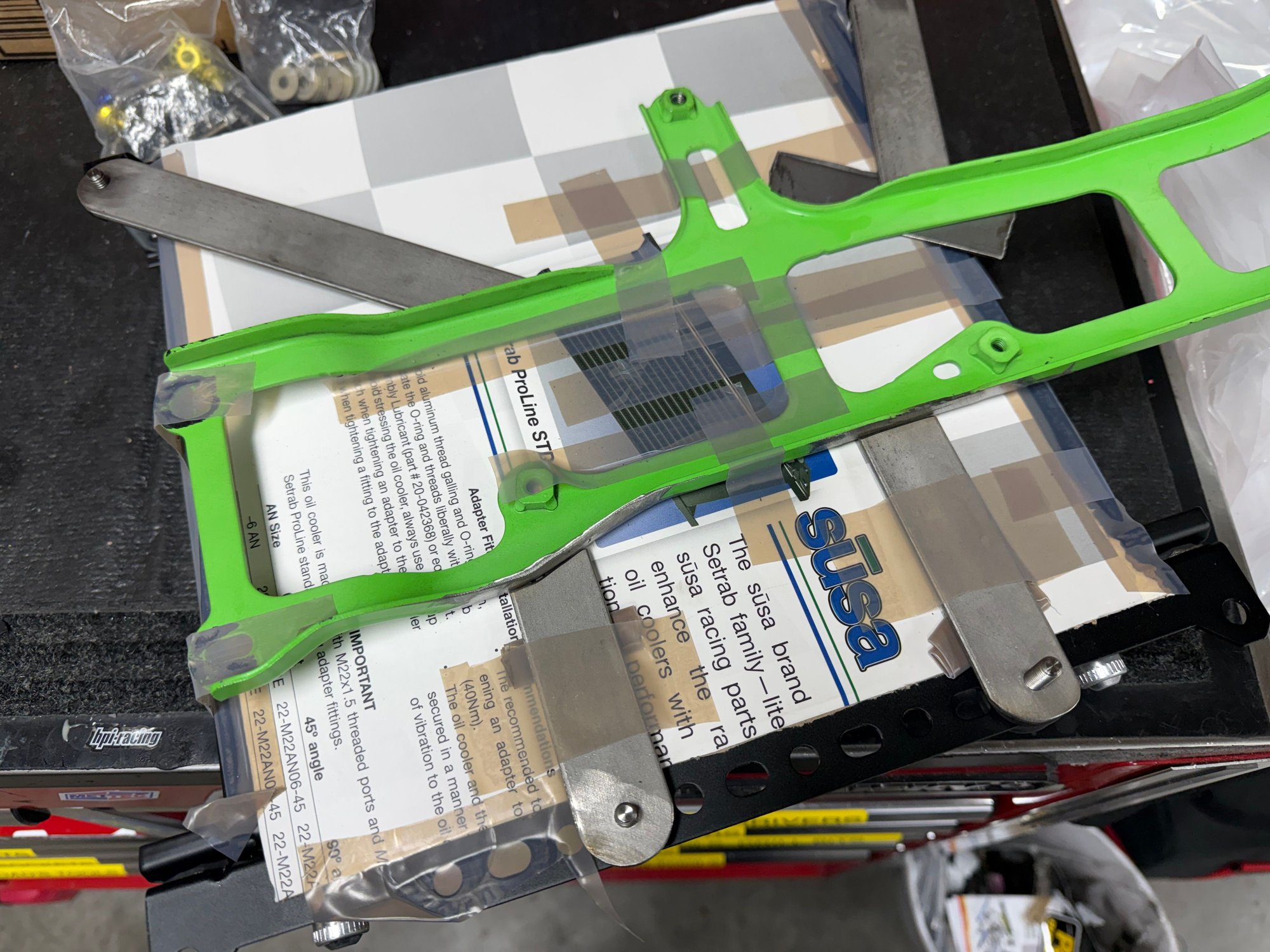

Ron, what are you using to fasten the heat shield? I searched your thread, could find the note of it. I saw @funshine made custom brackets in post #52 (Lexus F-Sport Underbody Chassis Brace on IS-Fthread), I wanted to see what did you ended up doing or how you going to address that.
as I recall, you only lose 2 points of heatshield attachments and I basically just left them unattached, no issues with rattle or anything. I had to trim the plastic underneath though and I attached them to the brace with some loop clamps hopefully visible in this picture.

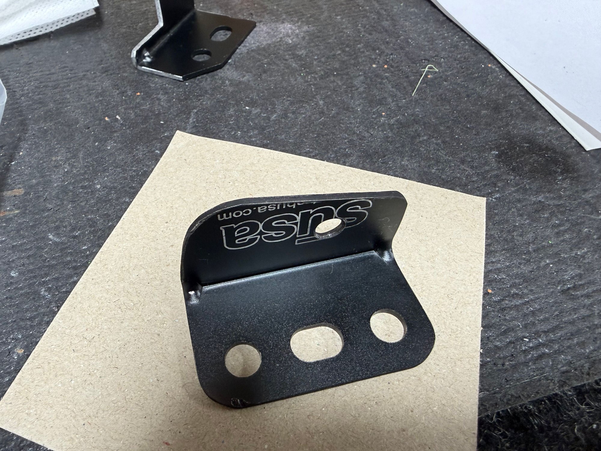

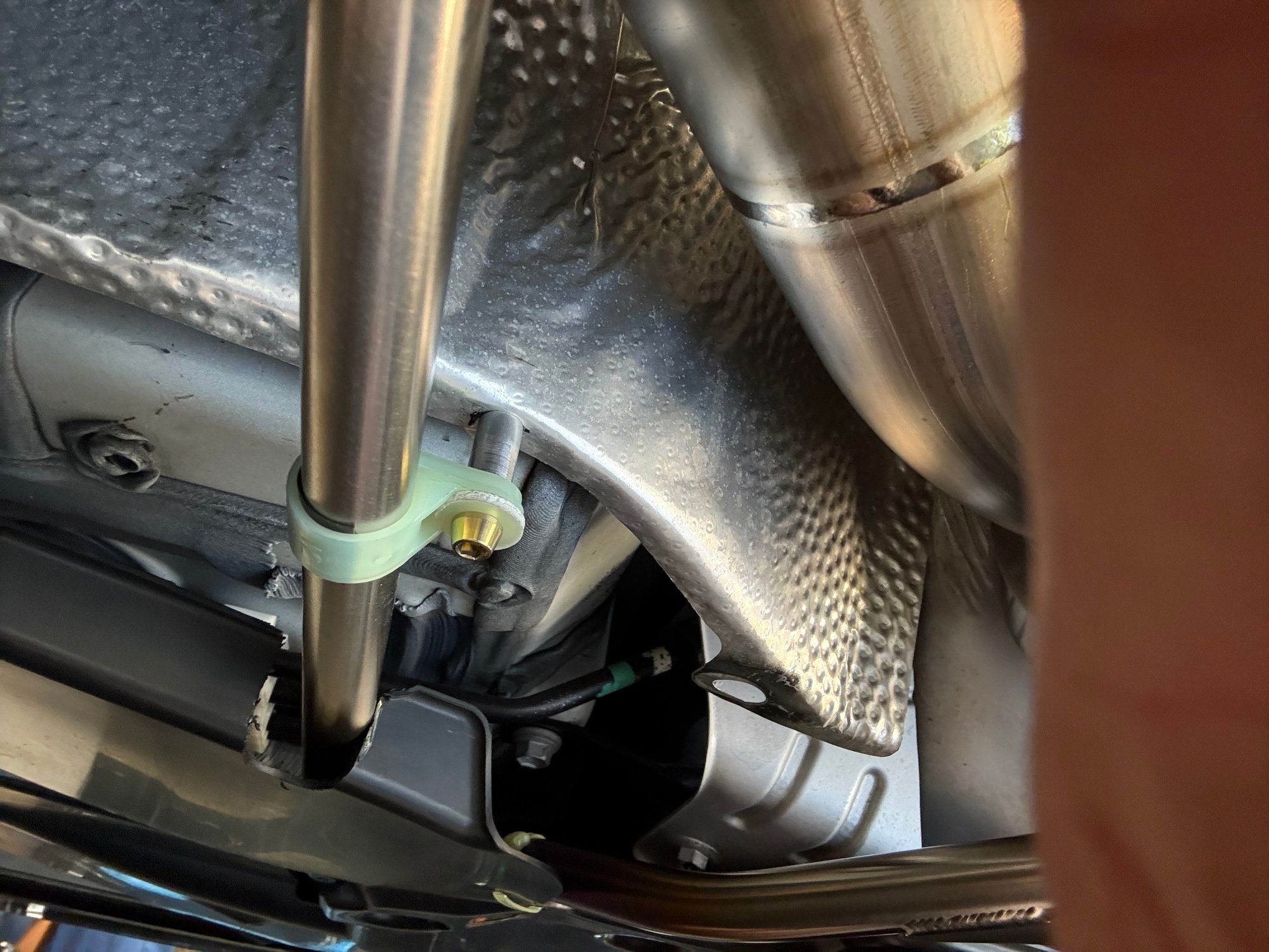

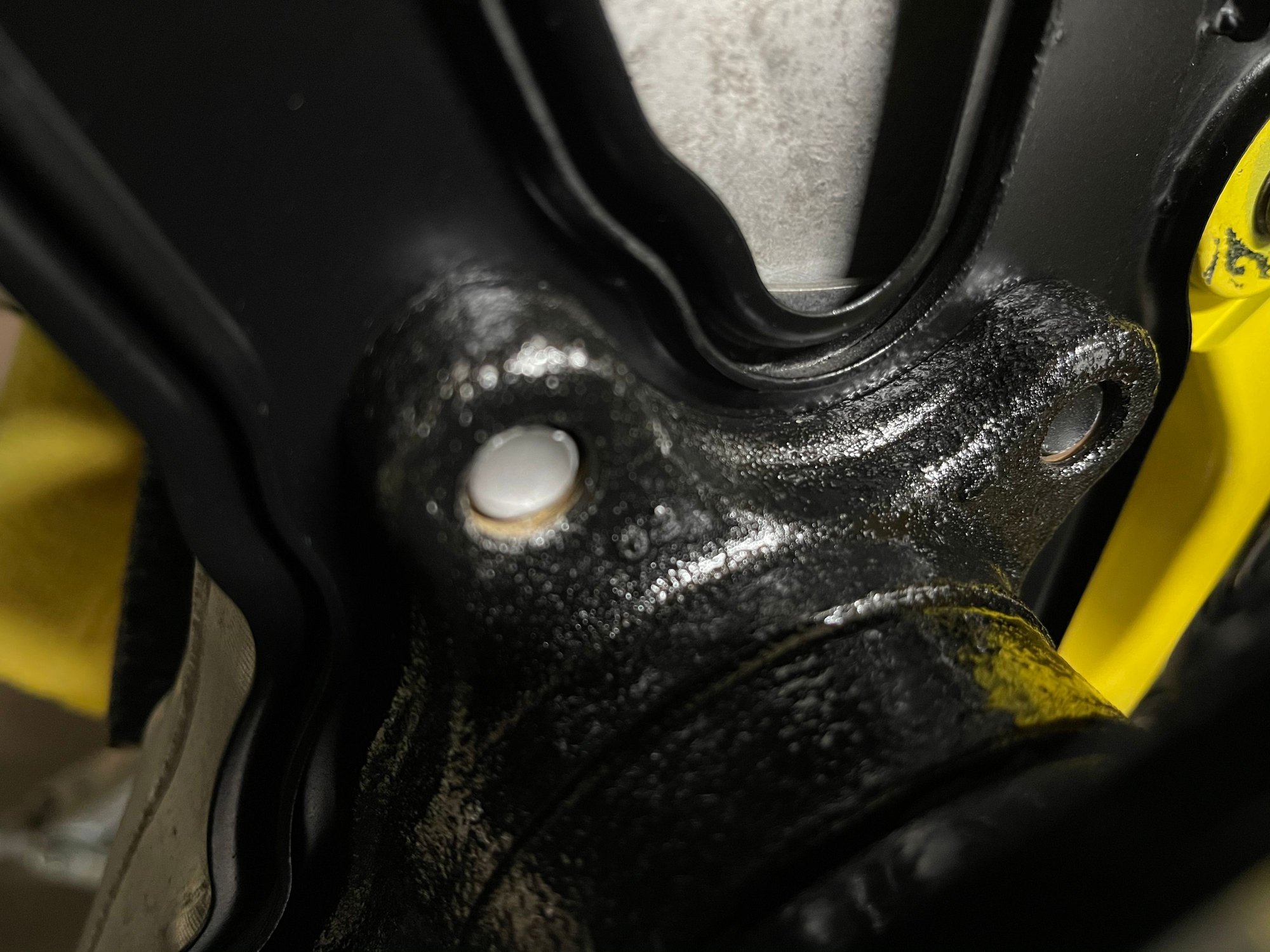

@Rossi I went ahead and secured the heatshield anyway even though I didn’t have any rattling issues. So here’s what I did. They’re about 3” from the original attachment points.

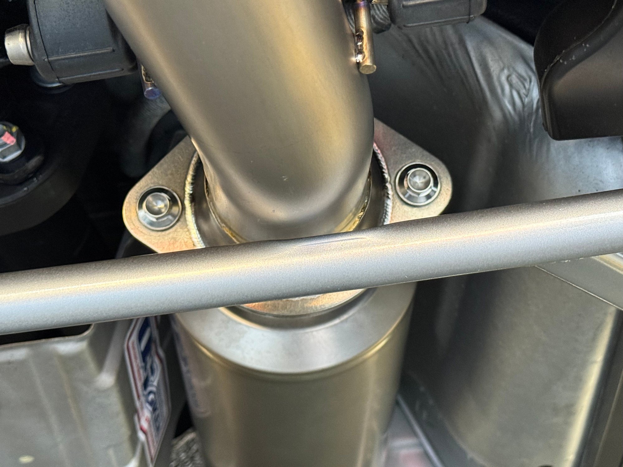

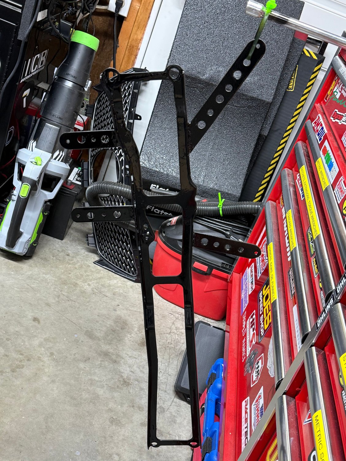

Since the TOM’s rear lower chassis brace became available, I went ahead and got one. I will be selling the titanium F Sport copy brace and the F Sport brace.
The TOM’s looks like it retains most of the attachment points for the splash shields but still no heat shield attachment points.

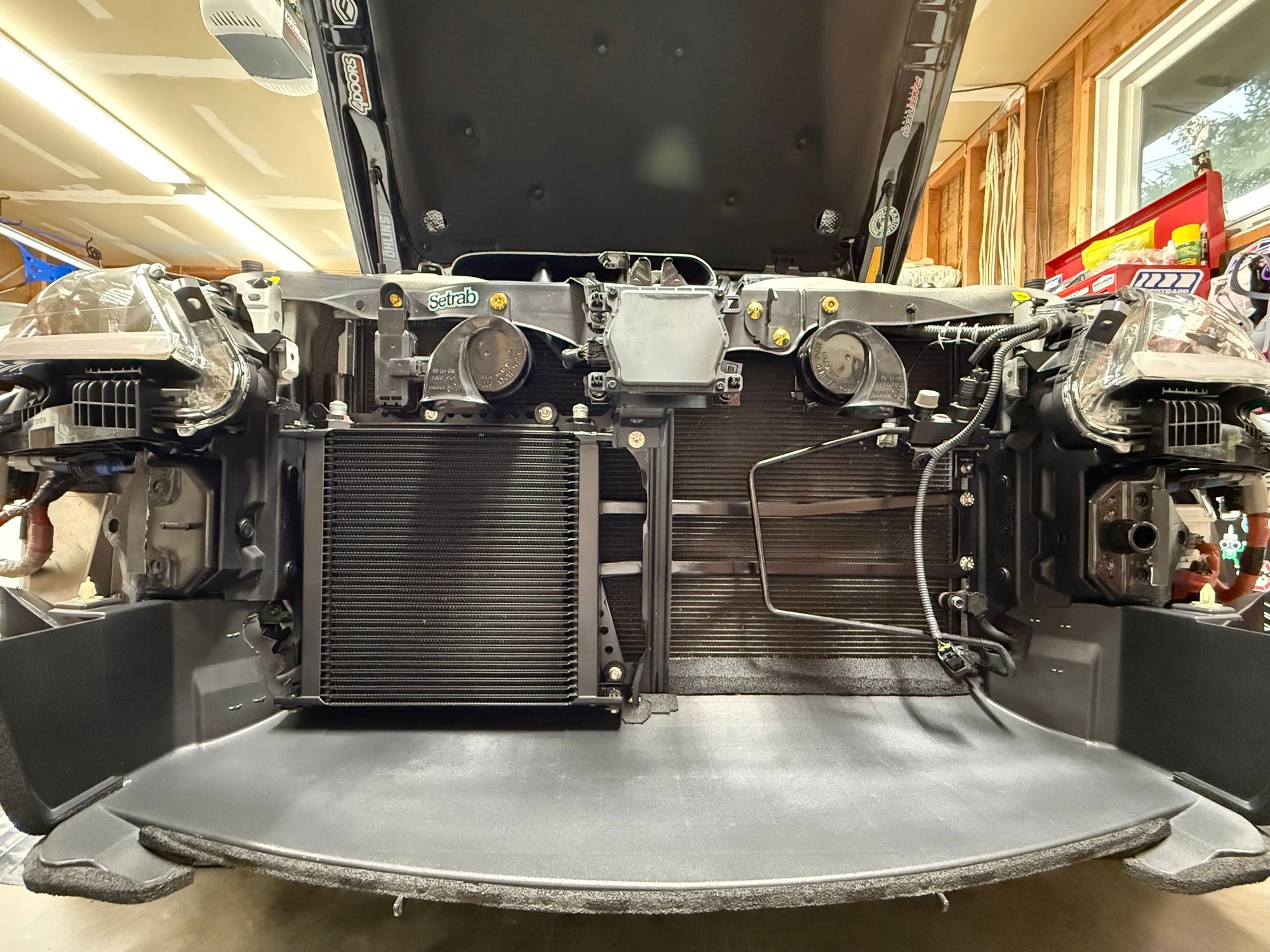

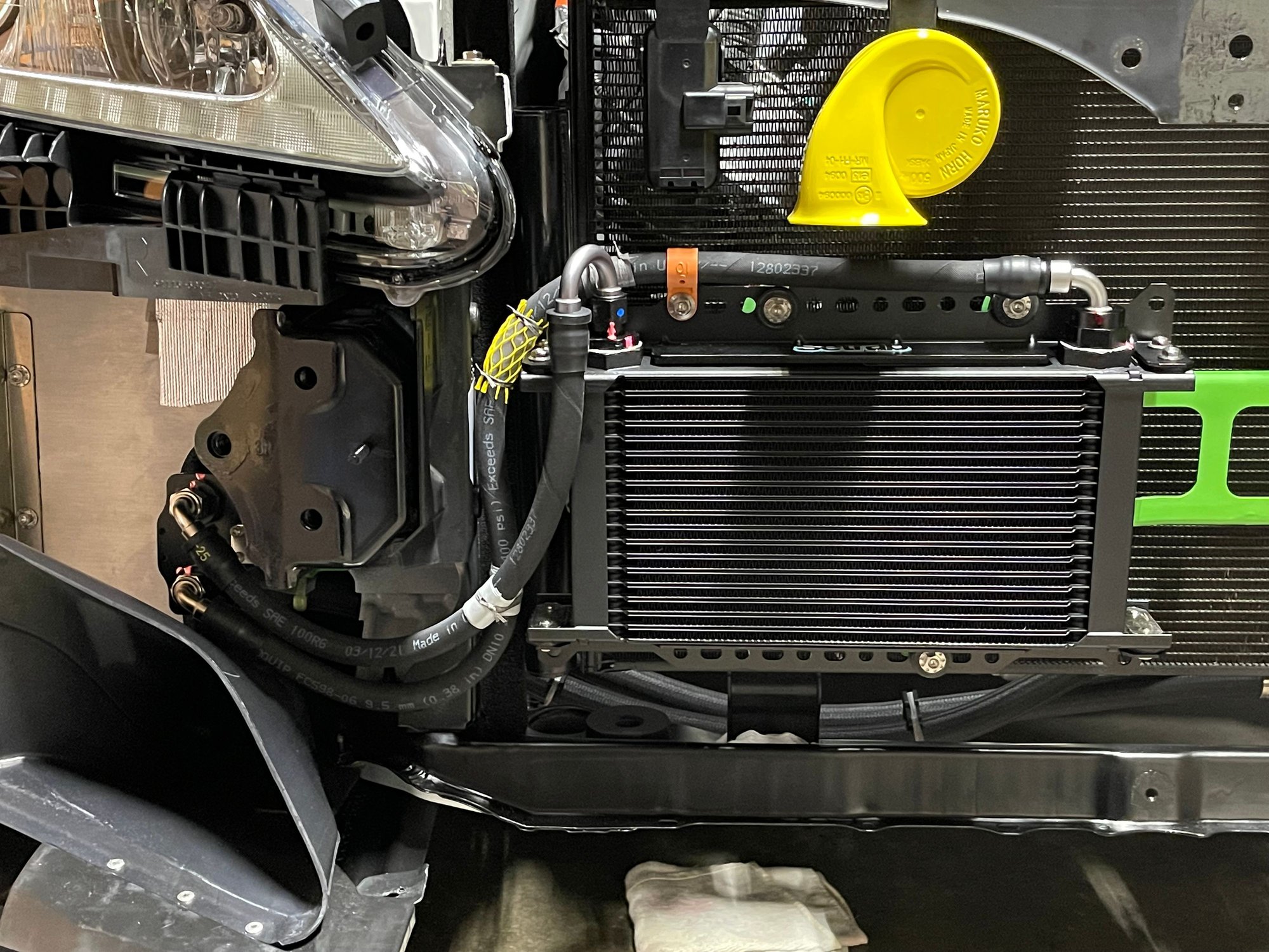

Going from a 19-row to a 34-row transmission oil cooler.
19-row
19-row
34-row
34-row

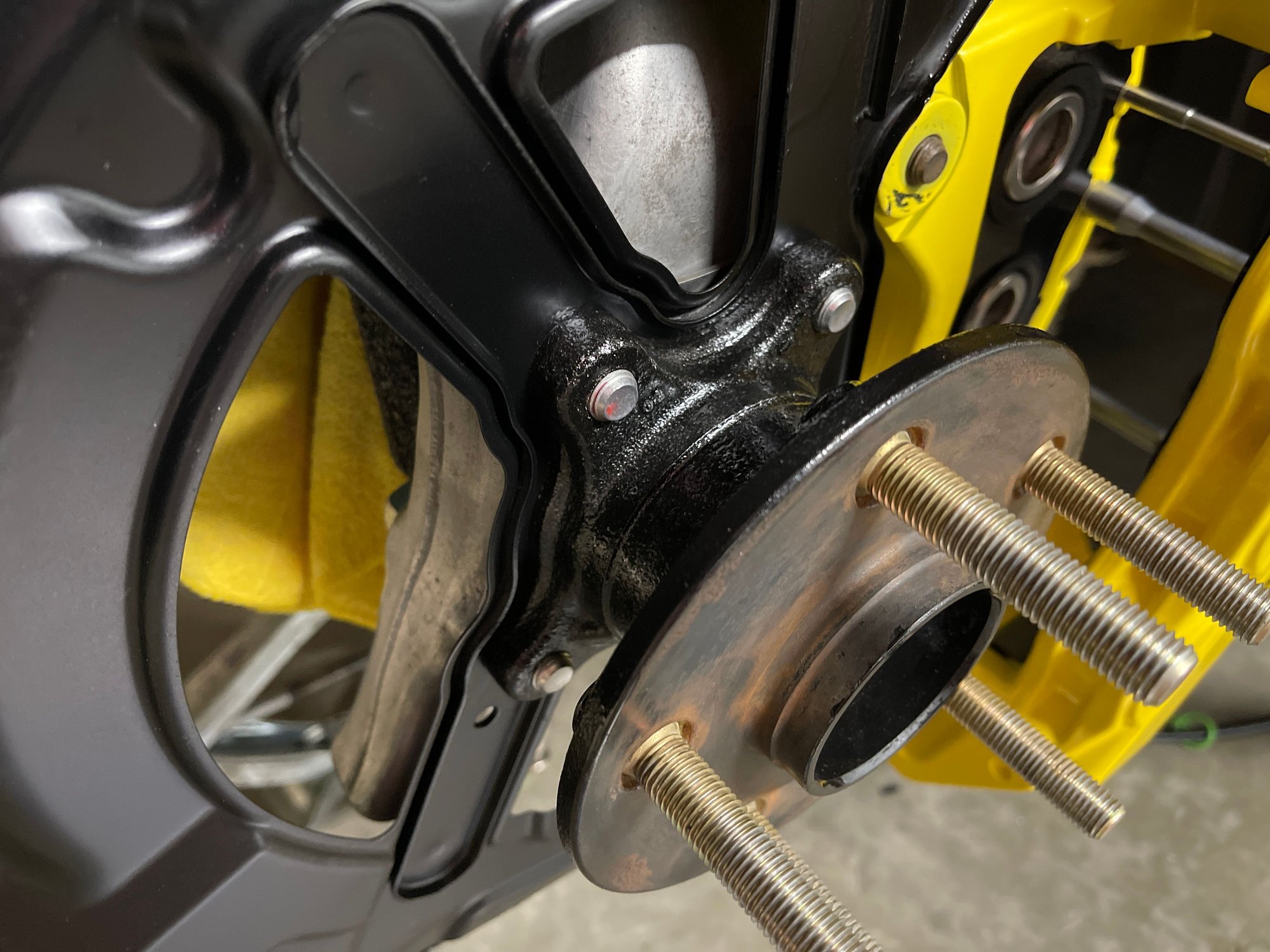

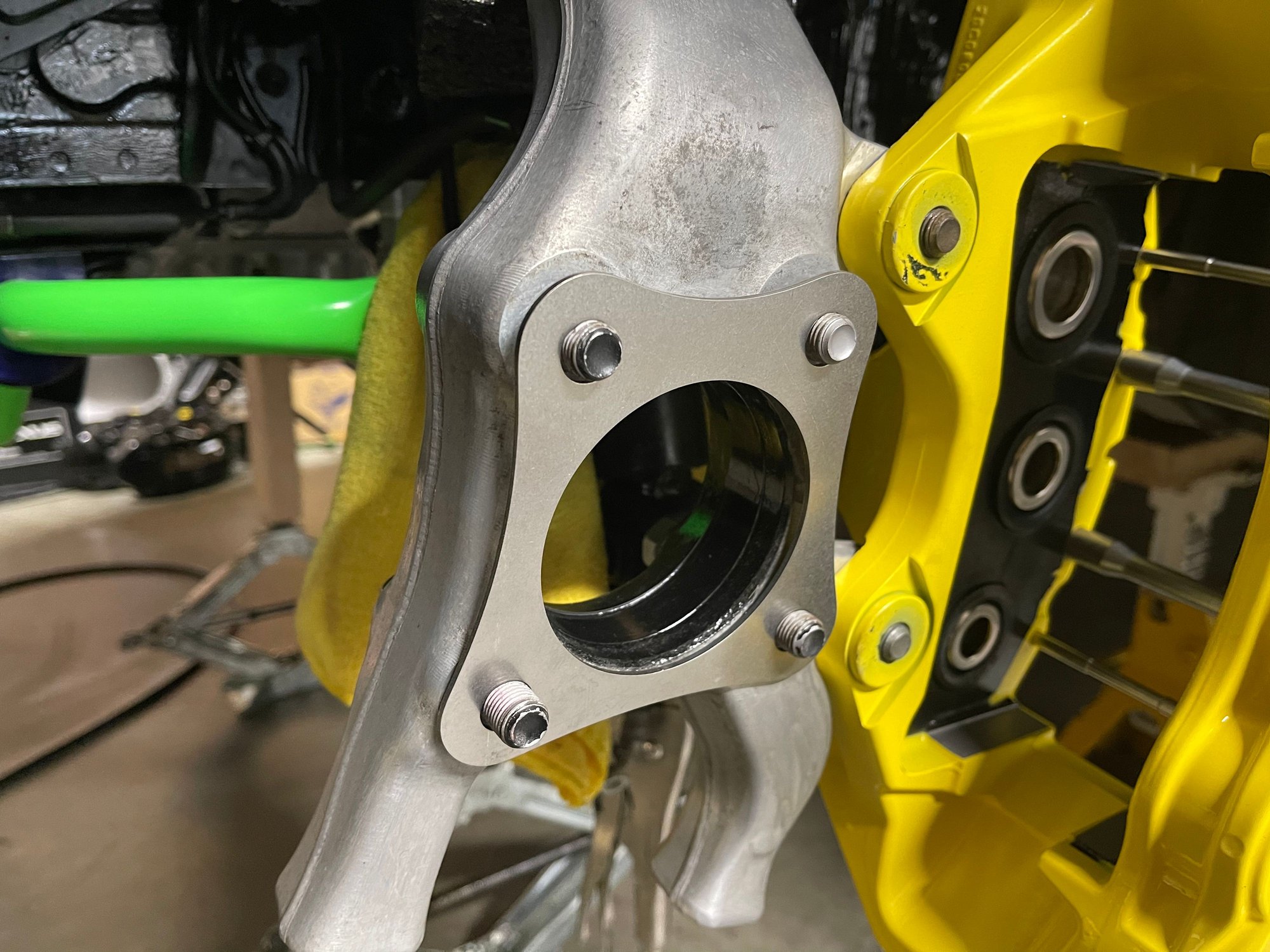

Got my hub shims from Mike! Just now waiting for the rotors and this upgrade is complete! These shims are 1.8mm thick so the factory bolts ended up short by about 1.5 threads. I ordered some rear lower front link bolts and they are the perfect length.
Factory hub bolts:
Rear lower front link bolts:
Thanks for the advice and help from the other thread. Now that I know I can go down the shim route instead of adapter route (to use RCF calipers with stock 2011 ISF wheels) I think I'm going to explore this route seriously.
Can you link me to the exact part number for the 'lower front link bolts' that you used to address the shorter factor bolts? And I assume I need 8 total (4x each side)?
Also, maybe a dumb question but does it have to be the figs 380mm Racing Brake rotors, or could I also use the RR racing Girodiscs as well?
Just to confirm, theses are the exact shims I should buy?
https://shopfigs.com/v5/FIGS-RCF-GSF...191?search=2mm
Thanks again for the help.
The bolt part number is 91672-G1265, yes you'd need 8 total. The rotors would have to be the 2-piece FIGS/RB IS F specific 380mm rotors as they have the proper IS F offset. I'm not sure about the RR girodiscs, but I believe those are stock replacements. Are the 2011 wheels 19x8.5 fronts? I know the setup fit the 2012+ wheels but not sure of 2011's. I'd bolt up one caliper and test fit to be sure, then add the thickness of the shim to the caliper to wheel clearance. And yes, those are the hub shims.

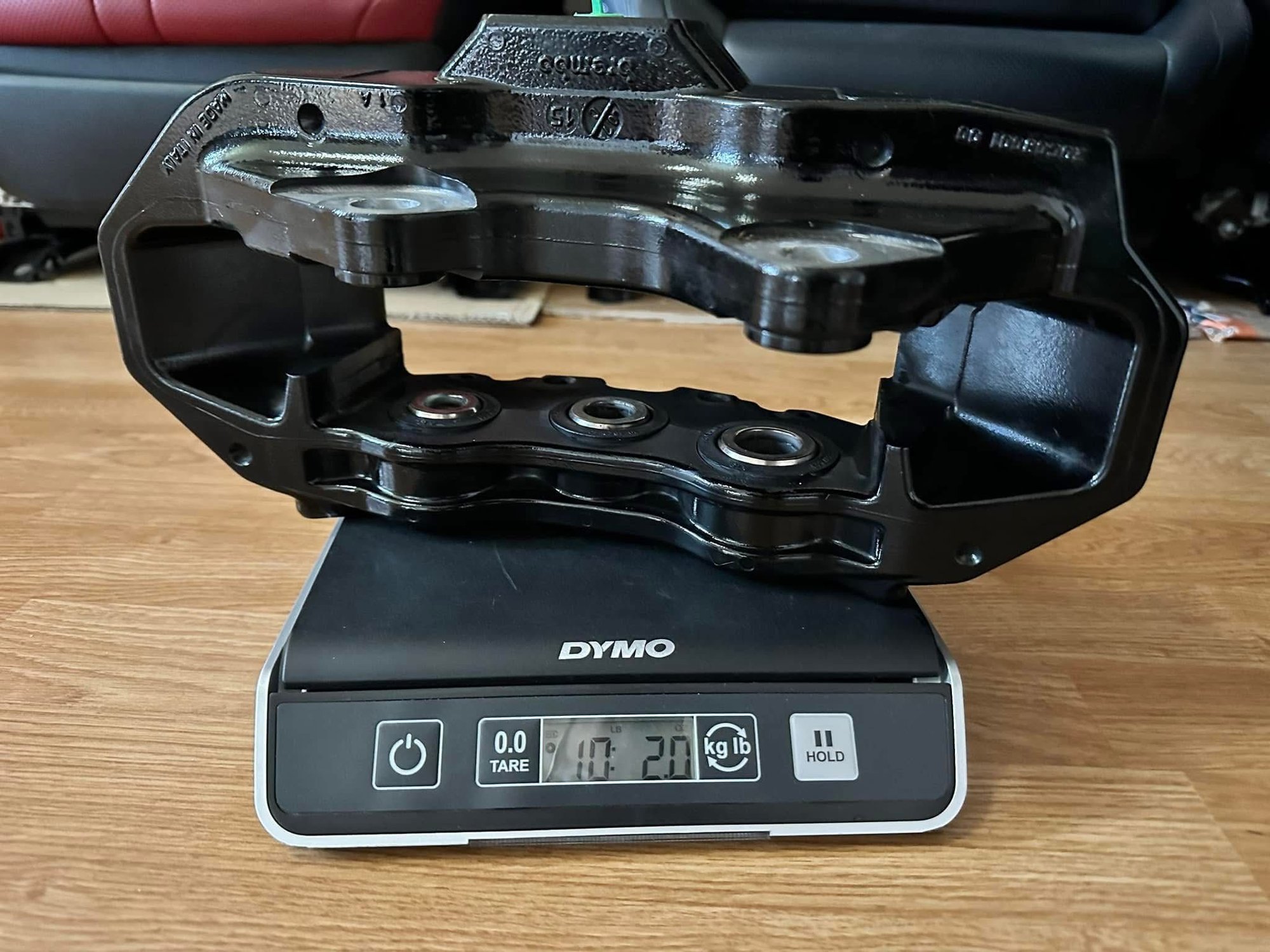

Any chance the calipers have been weighed? Curious if the RC F/GS F calipers are heavier than the OEM IS F calipers. I suspect they are. I'm not willing to pull wheels today to find out, but I might later. I have suspension work to do on both cars this coming week and might be able to accomodate this check.
I don’t remember weighing an IS F front caliper. But, here’s an RC F front caliper with some brake fluid
in it.
