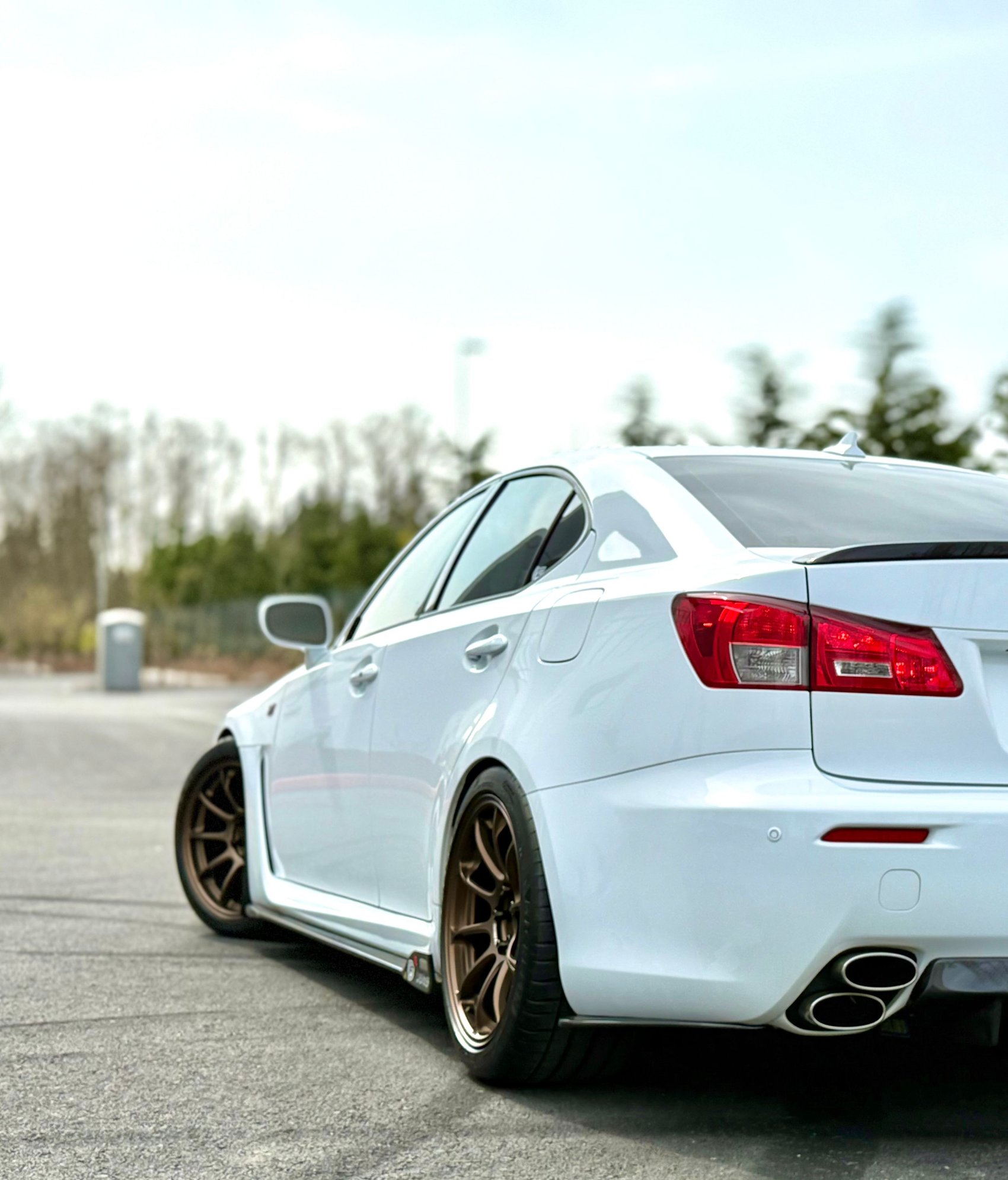

Btw did you have to roll your fenders to fit those wheels?
I'm sure you've probably mentioned it somewhere in your thread
Rear fenders are only half rolled (some lip left) but front fenders are untouched, just flattened plastic fender liner protrusion.
rear fender.
rear fender.

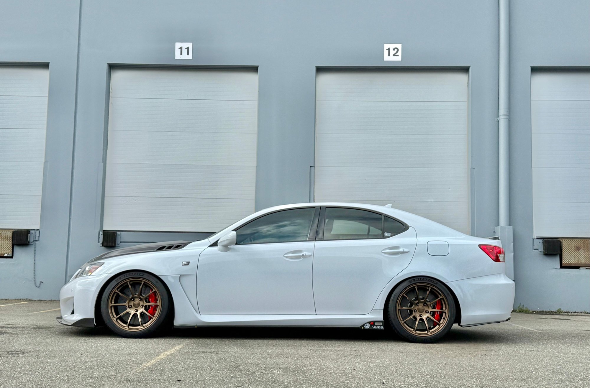

Thanks, but did you need to do any fender work for the below wheel setup? seems to have enough of a gap for the wheels to fit, but not sure if this would have needed fender work as well?
No, picture shows current fender. no added fender work with the bronze wheel setup. bronze wheels are only 0.3 mm more aggressive than the apex wheels as far as poke.

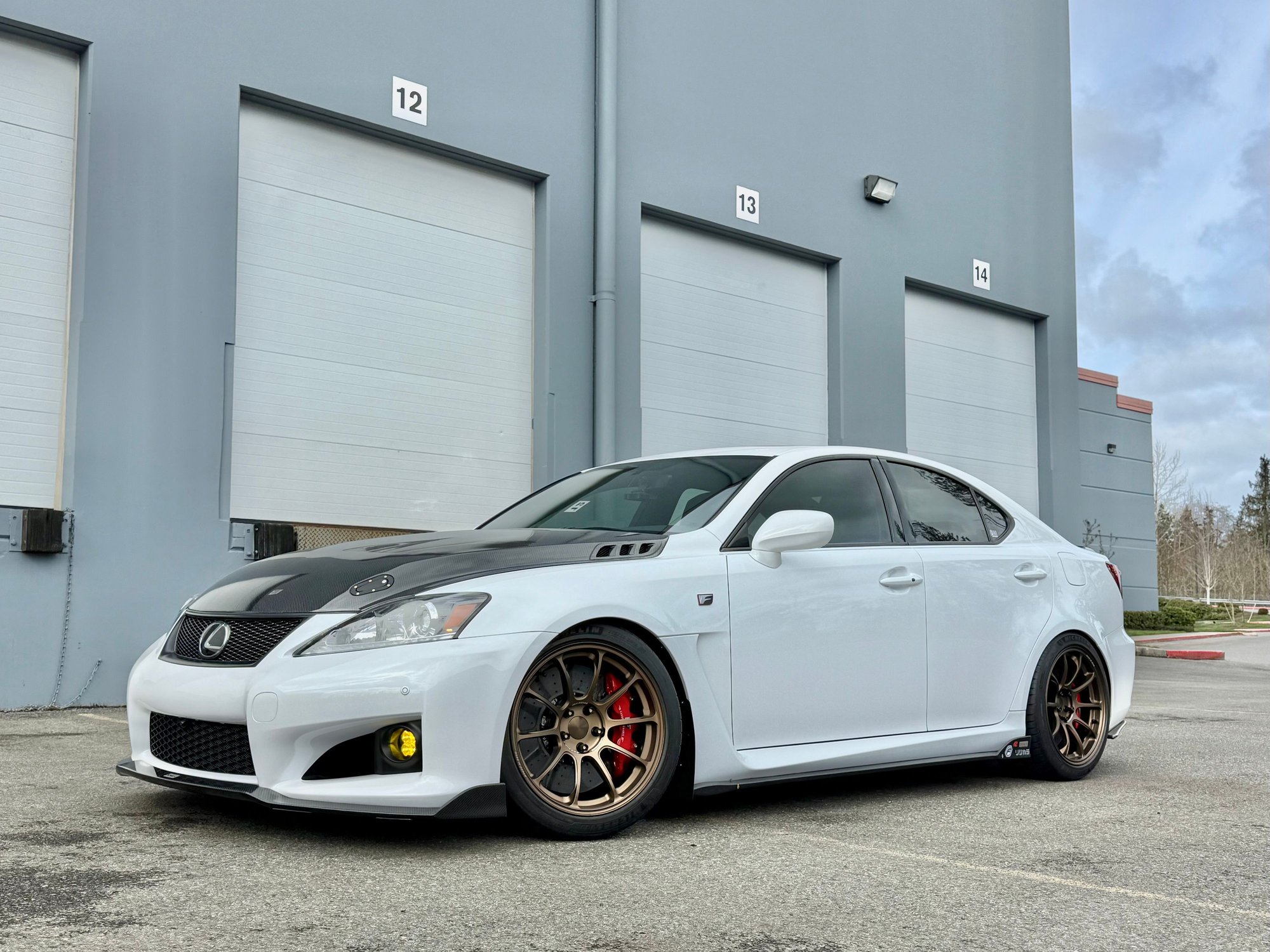

Ok, so I understand that someone would still have to do some fender work to fit this bronze wheel setup? or no because they aren't as aggressive?
I'm assuming the bronze setup are the Volk ze40 18x10 +39. square setup 18x10 with 275/35?
If stock fenders, yes, the rear need some rolling or shaving with these Volk ZE40's in 18x10 +39 with 275/35 tires. And they are definitely more aggressive than stock.

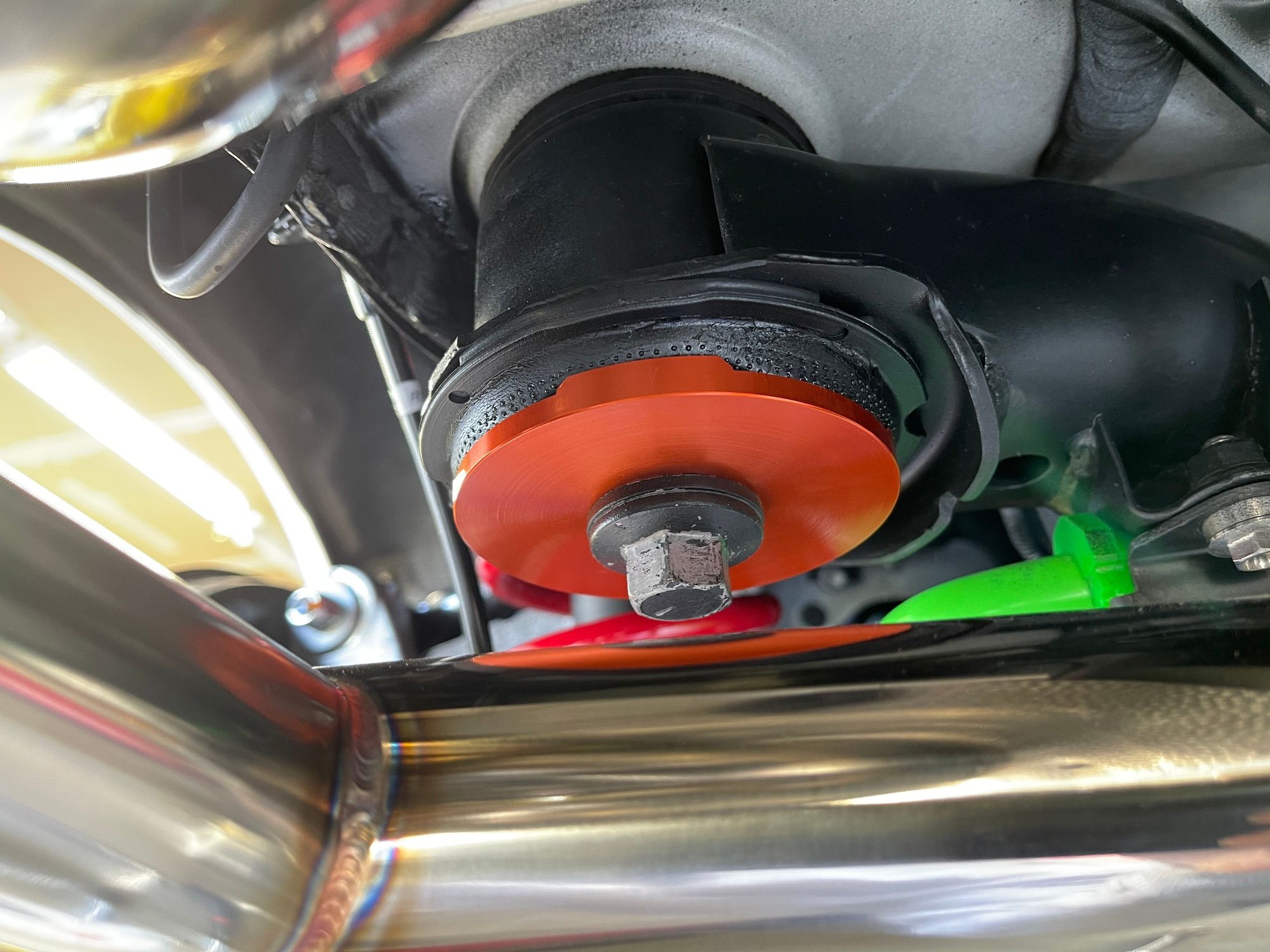

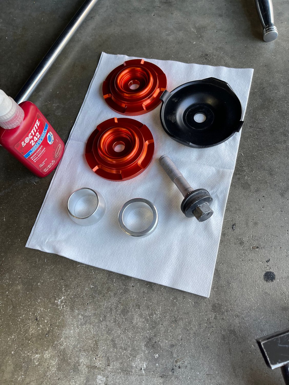

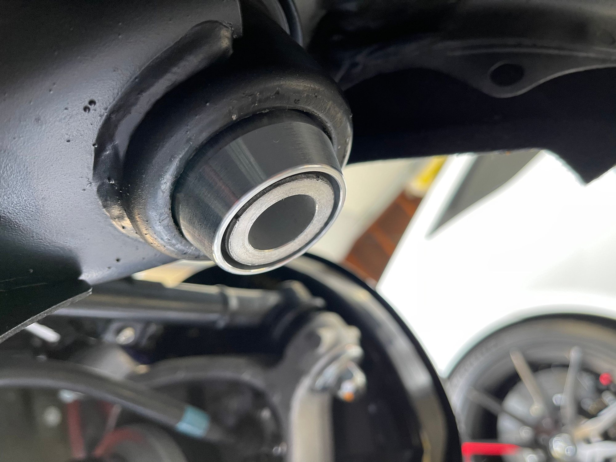

Installed this Super Now rear subframe bushing collars kit.
Rear mount before:
Rear mount after:
Front mount:
Ron, what is the advantage if getting these?
Tightens up the factory rubber bushings for less movement.
