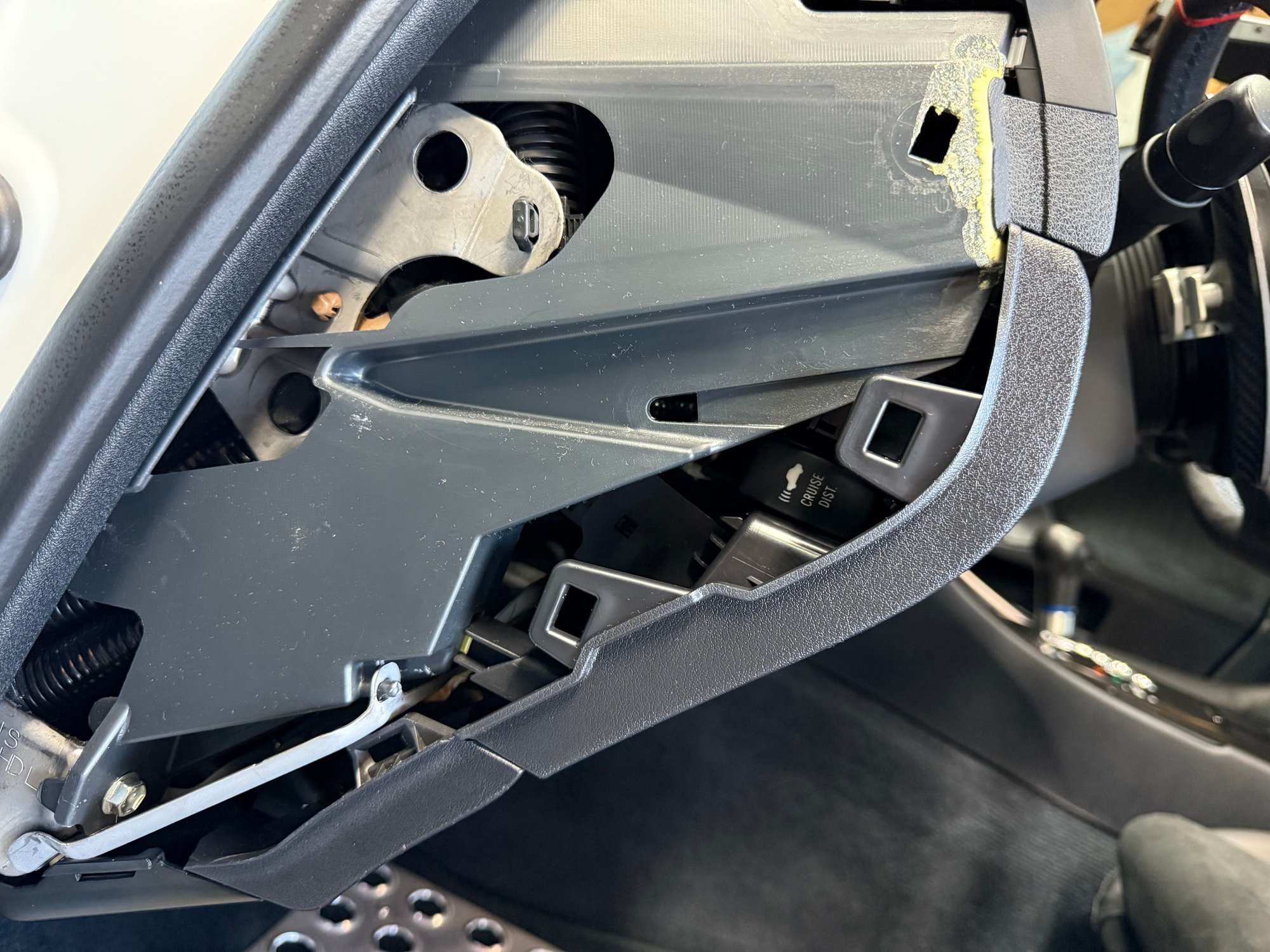

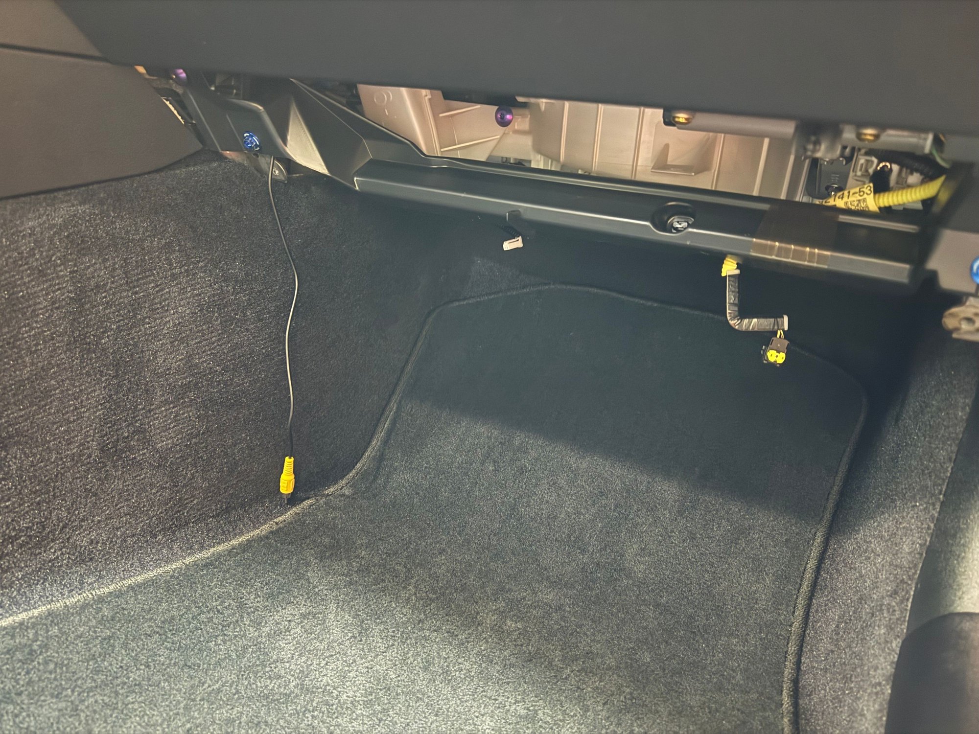

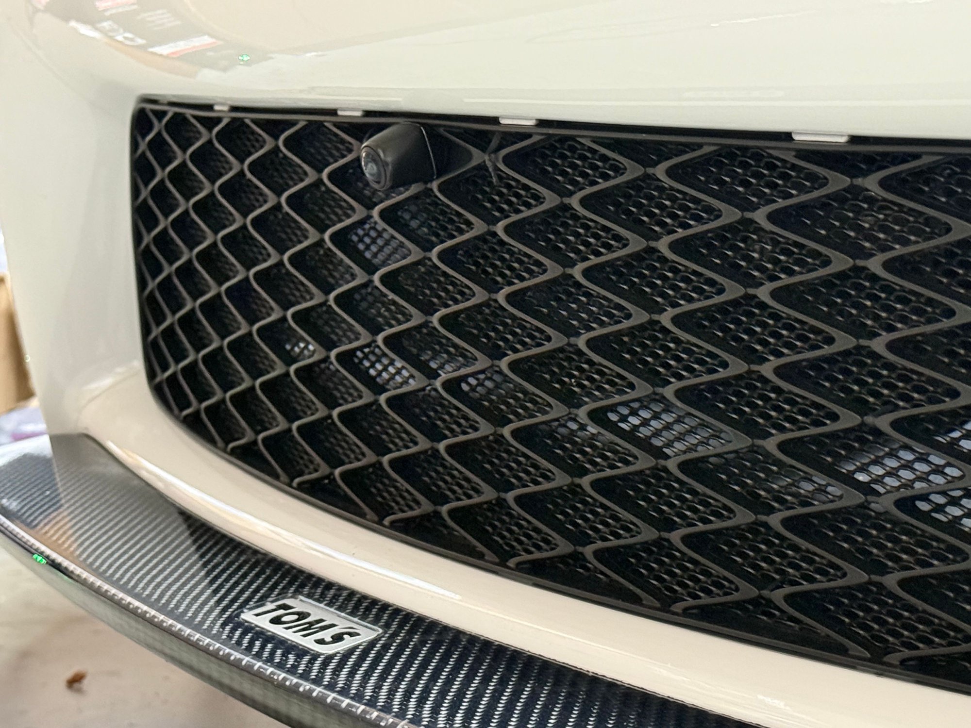

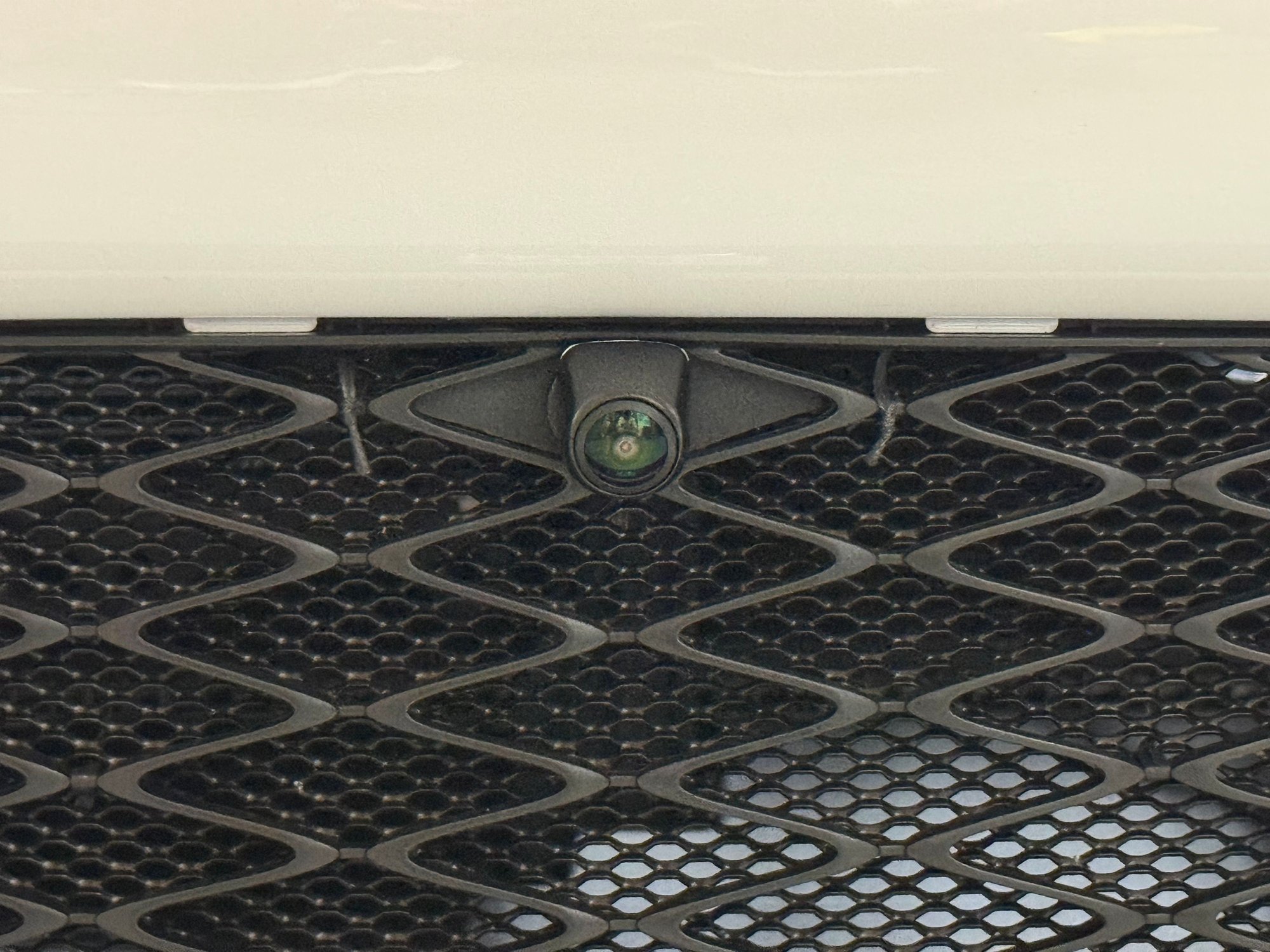

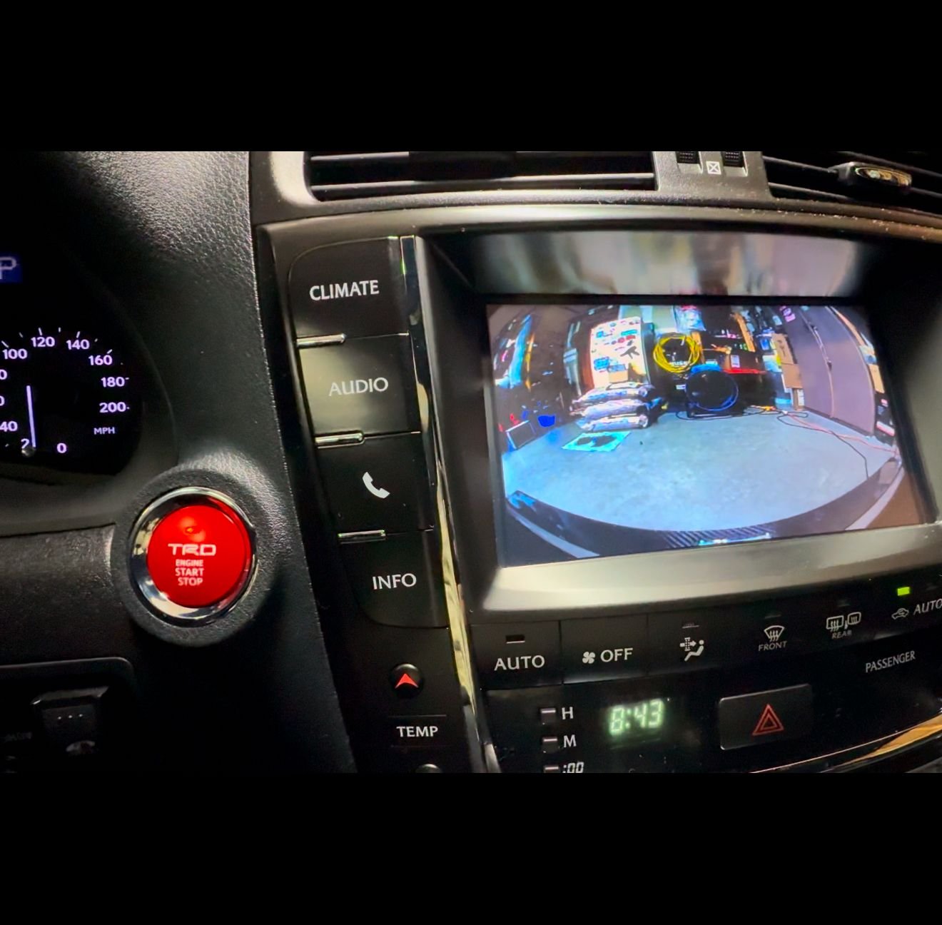

Camera mounted.
Camera mounted.

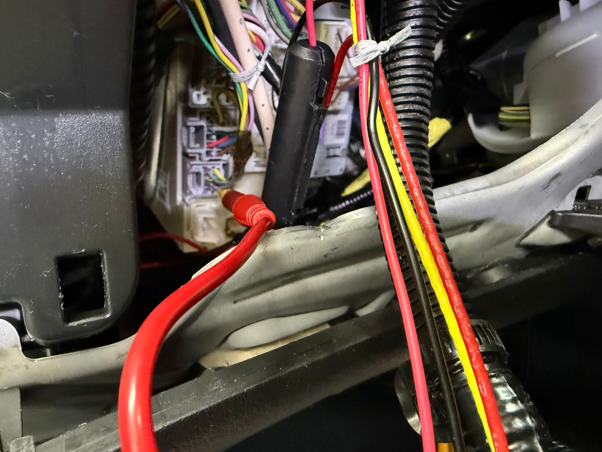

Looking for proper 12V source.

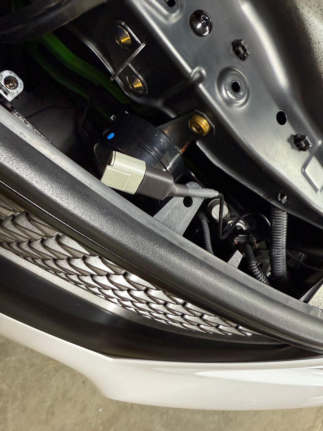

Cut wires and installed connector, for when bumper needs to come off.
Radar cruise distance button tucked away since I never use it. Camera switch will take its place.
Waiting for Grom VL2 VAUX harness, can’t believe it’s not supplied with the unit.
Waiting for GROM VL2 VAUX harness, can’t believe it’s not supplied with the unit.

That FF camera is next level, awesome.

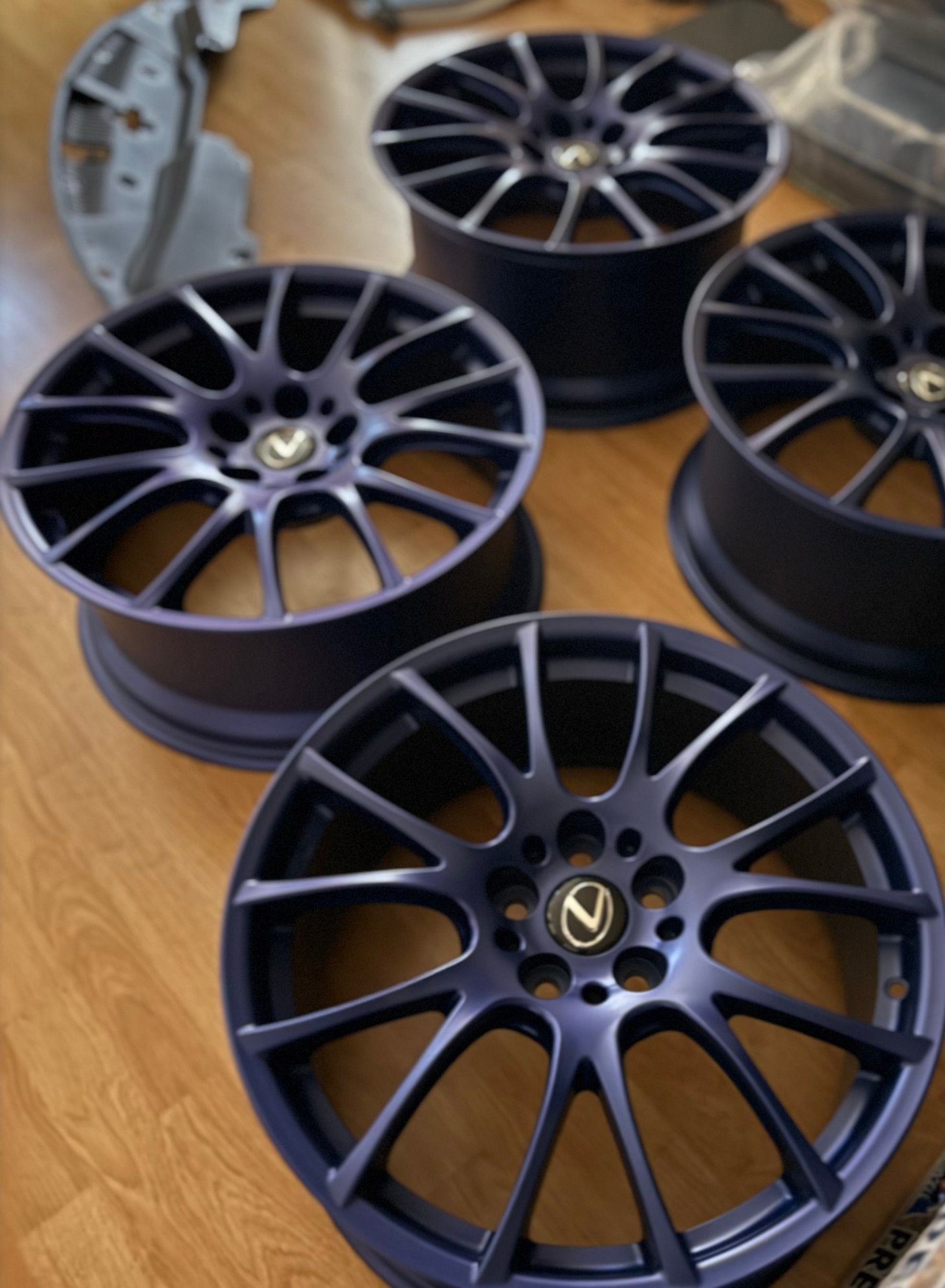

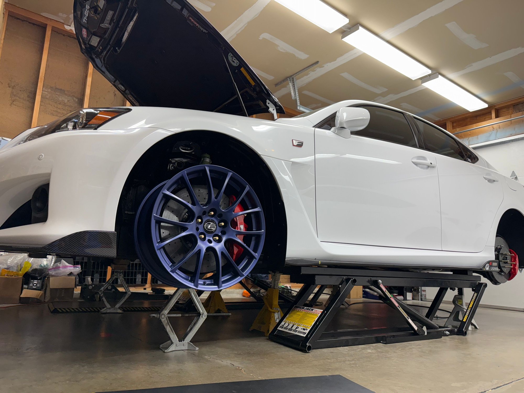

Refinished factory wheels.

I did the same, but with my car being black, I went for black gloss. I also discovered the Tacoma lug nuts fit on the ARP studs with OEM wheels perfectly. I ordered a set in black for a full black out on the wheels after running OEM studs and chrome lugs for quite a while.
I was hoping for a little less bright blue, more like matte anodized look. But, I dunno, I think I'm starting to like this more and more.

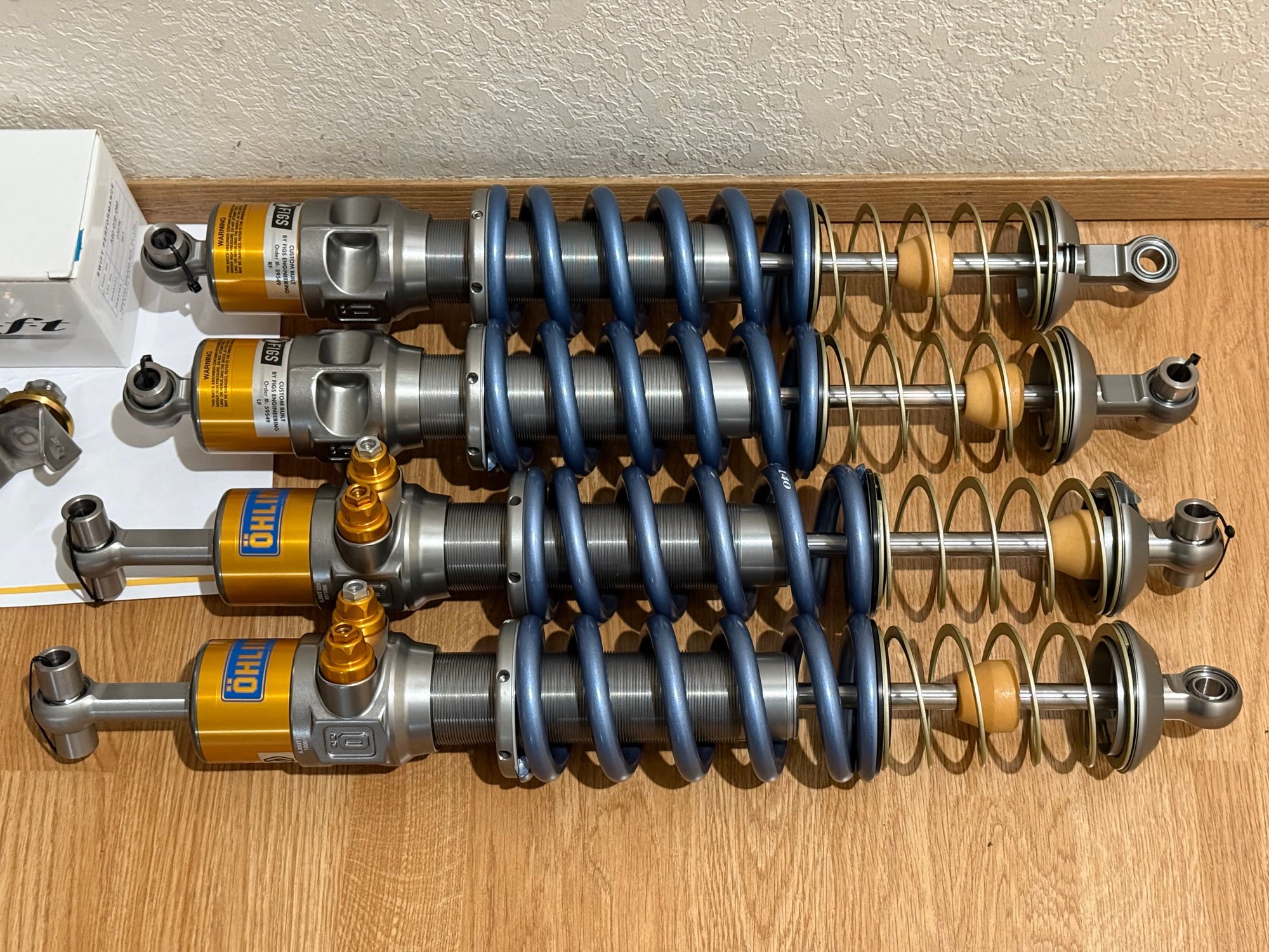

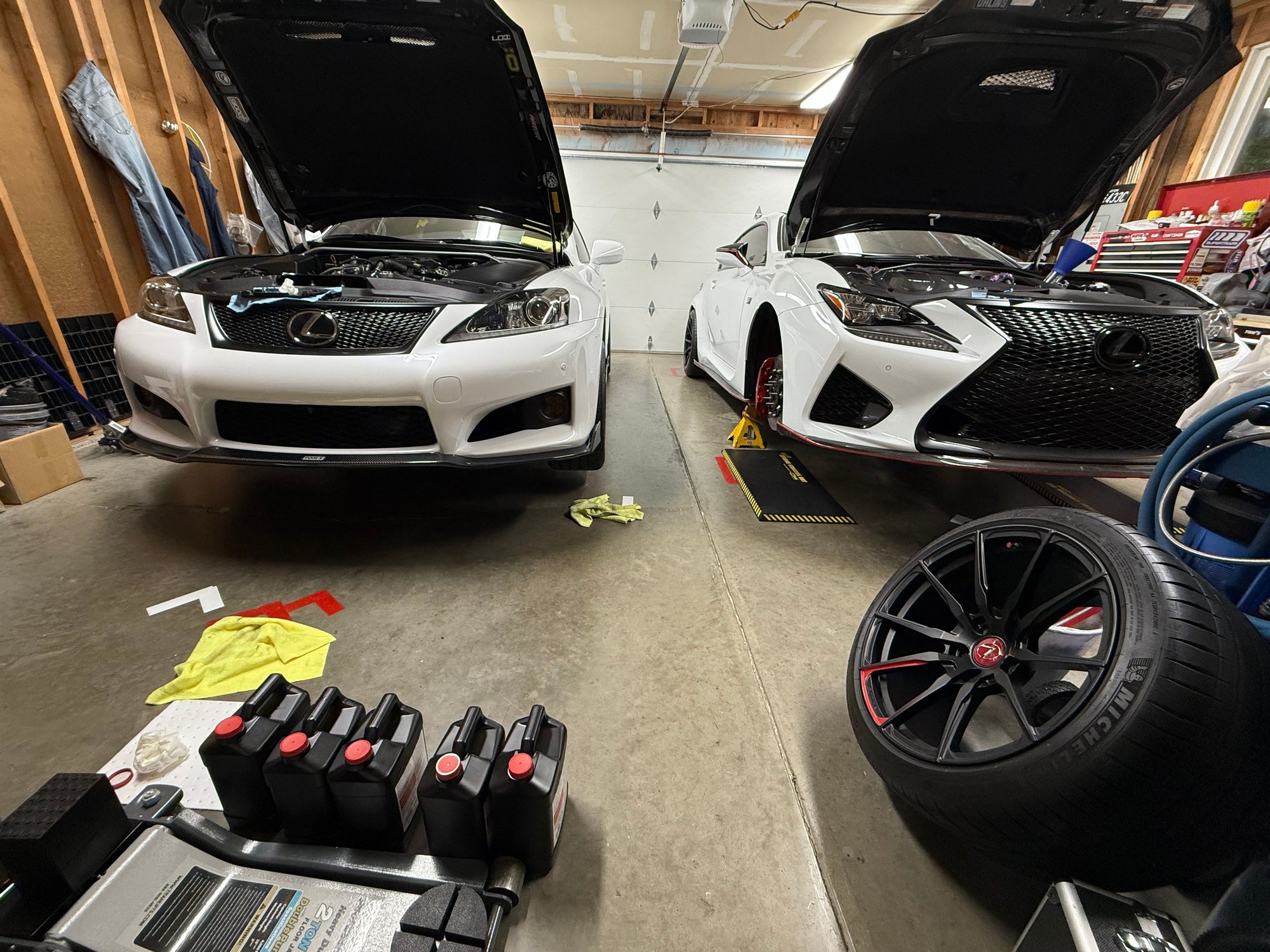

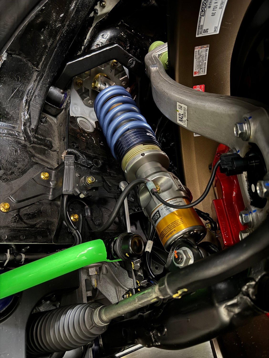

Time for a little update! Got the @FIGS spec’ed/built 4-way Ohlins TTX coilovers. Mike also made custom titanium upper hats with titanium studs for me.

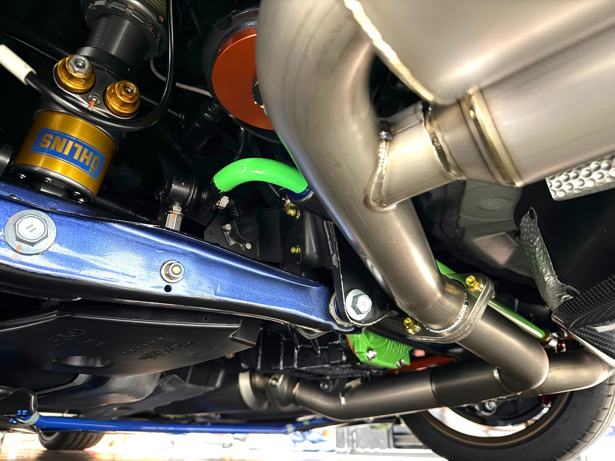

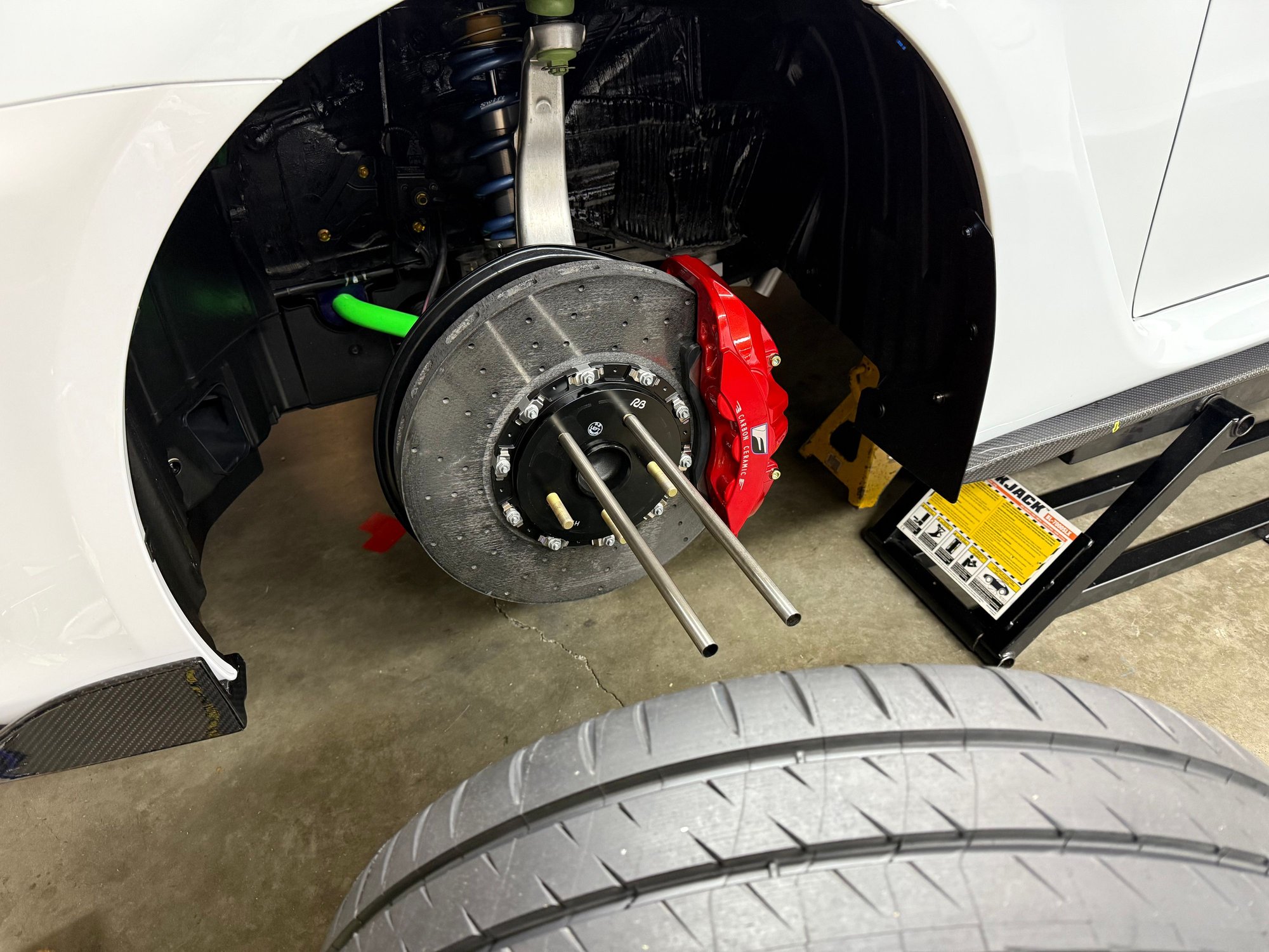

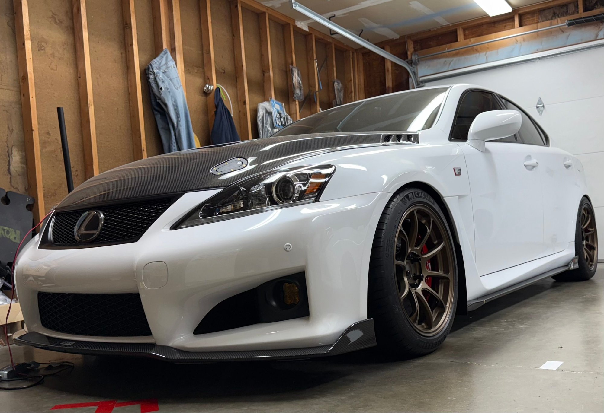

New Ohlins TTX/ILX coilovers installed! Ride height set. Fresh oil. Ready for spring and summer fun!

Old Mar 16, 2025 | 01:53 PM
  #627

Very nice, very clean, Ron!
I’ve been eyeing the Ohlins R&T coils, but now you have me curious about the TTX coils.

Thanks! Can't go wrong with R&T. But TTX is just the next upgrade from them!

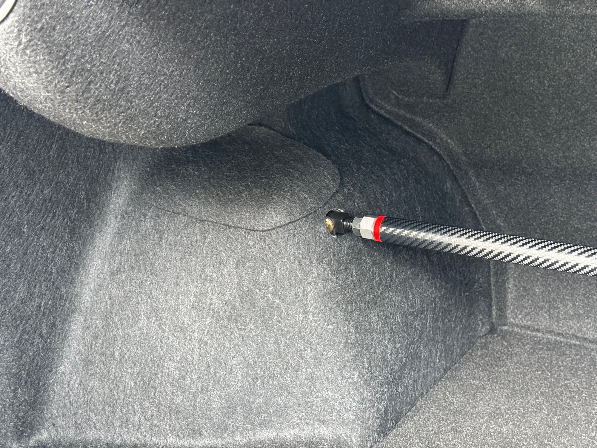

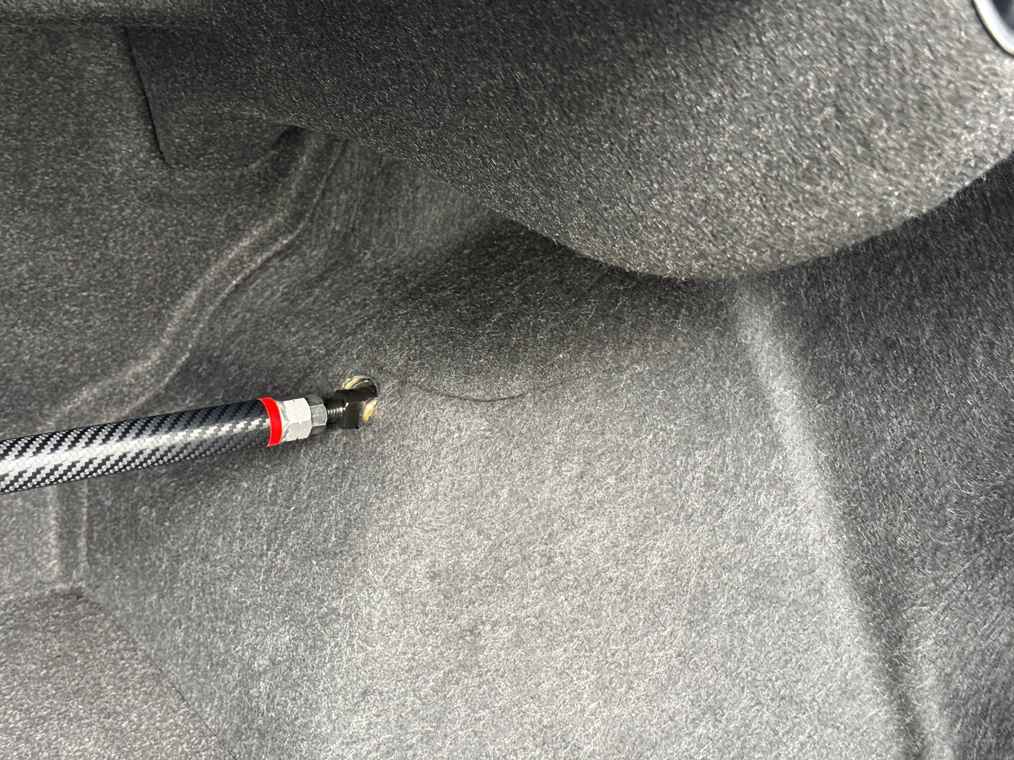

Put together an adjustment tool kit for the Ohlins TTX and installed some magnets for the shock tower covers, an idea from another F owner.

^^^^ great idea and design.
