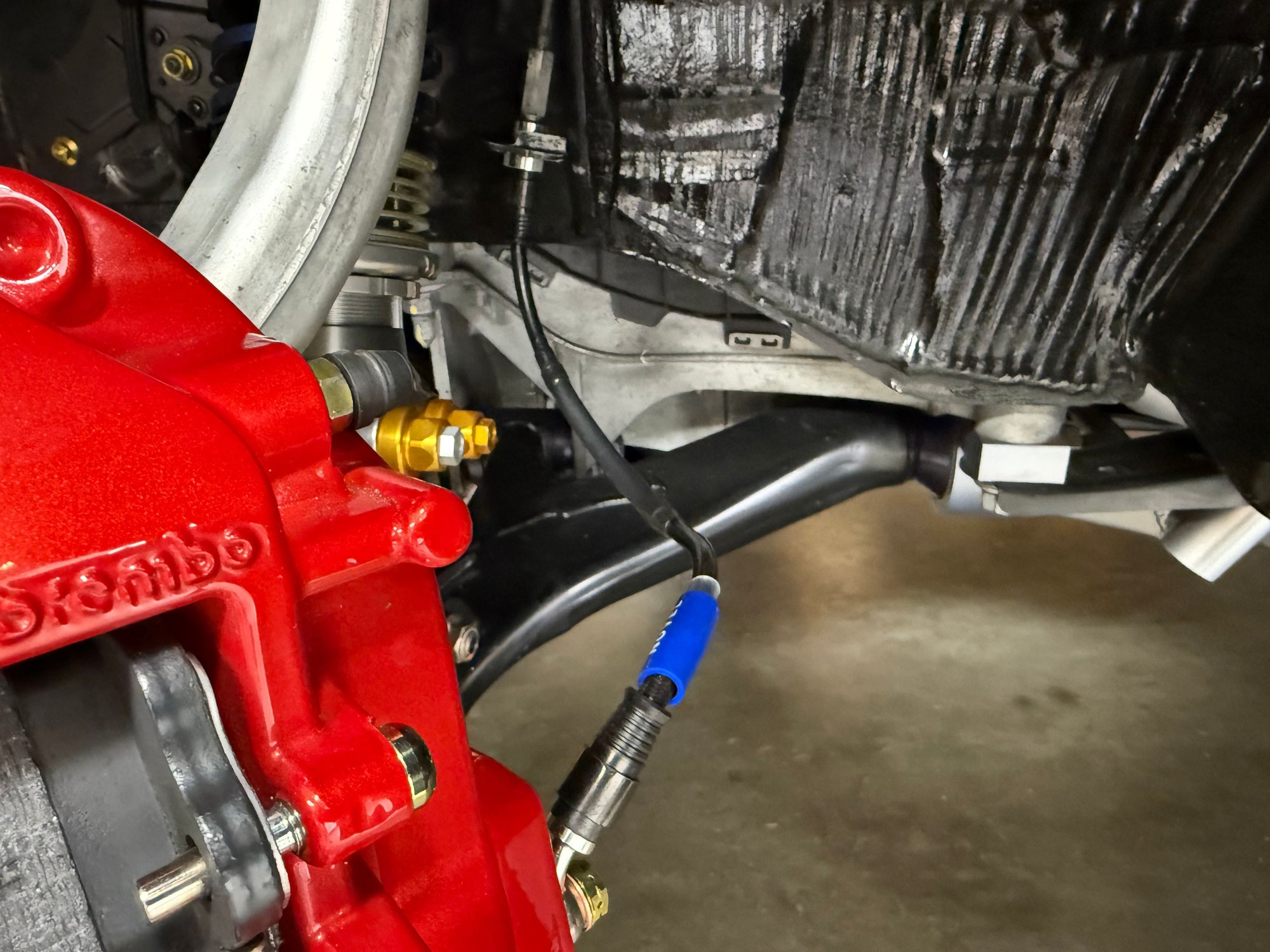

Installed some Novel/Endless RC F front brake
lines. These are ~1” longer which works perfectly with how I had to clock the caliper fitting away from the coilover *****. Stock length looked a little short when at full turn.

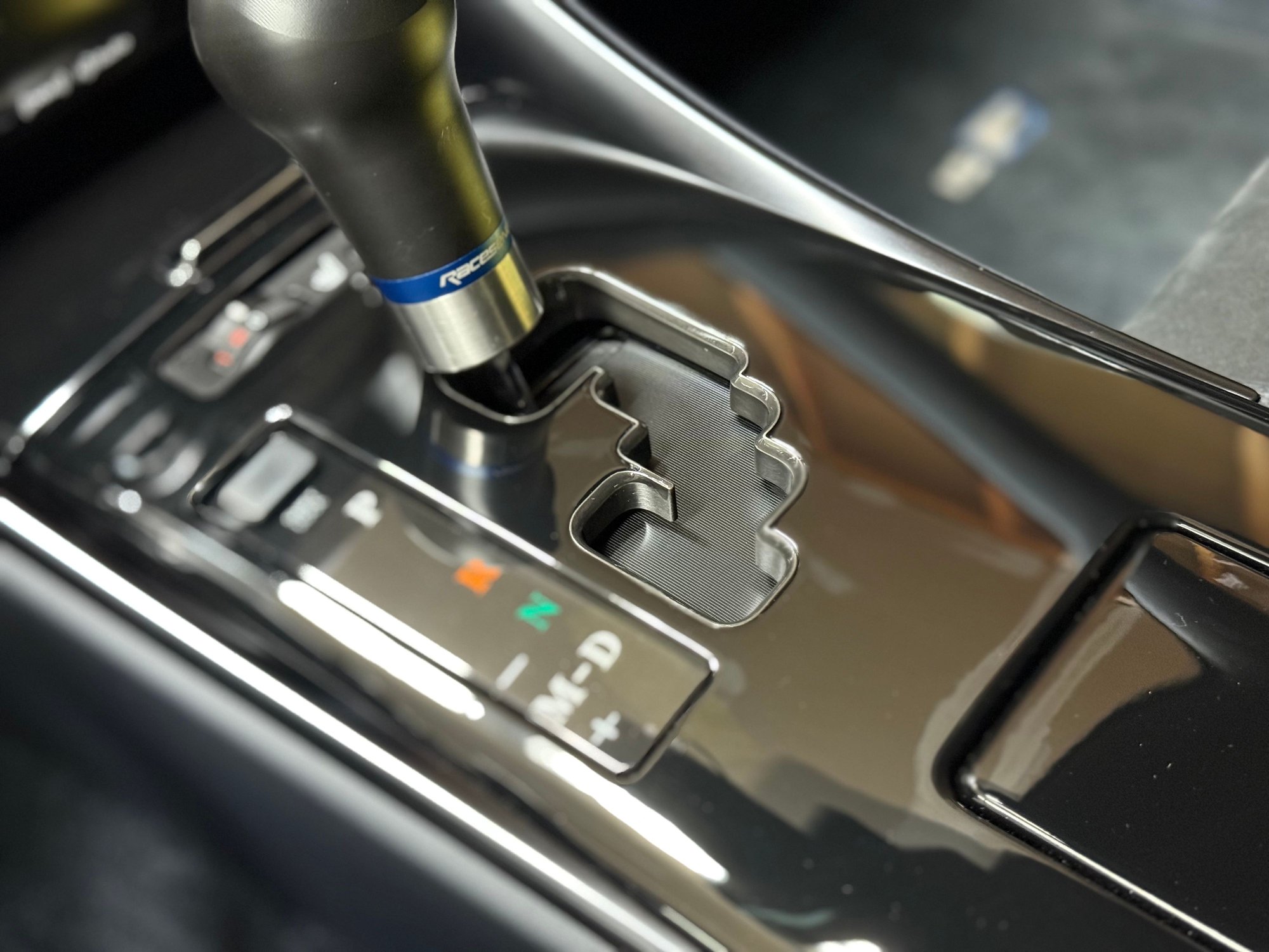

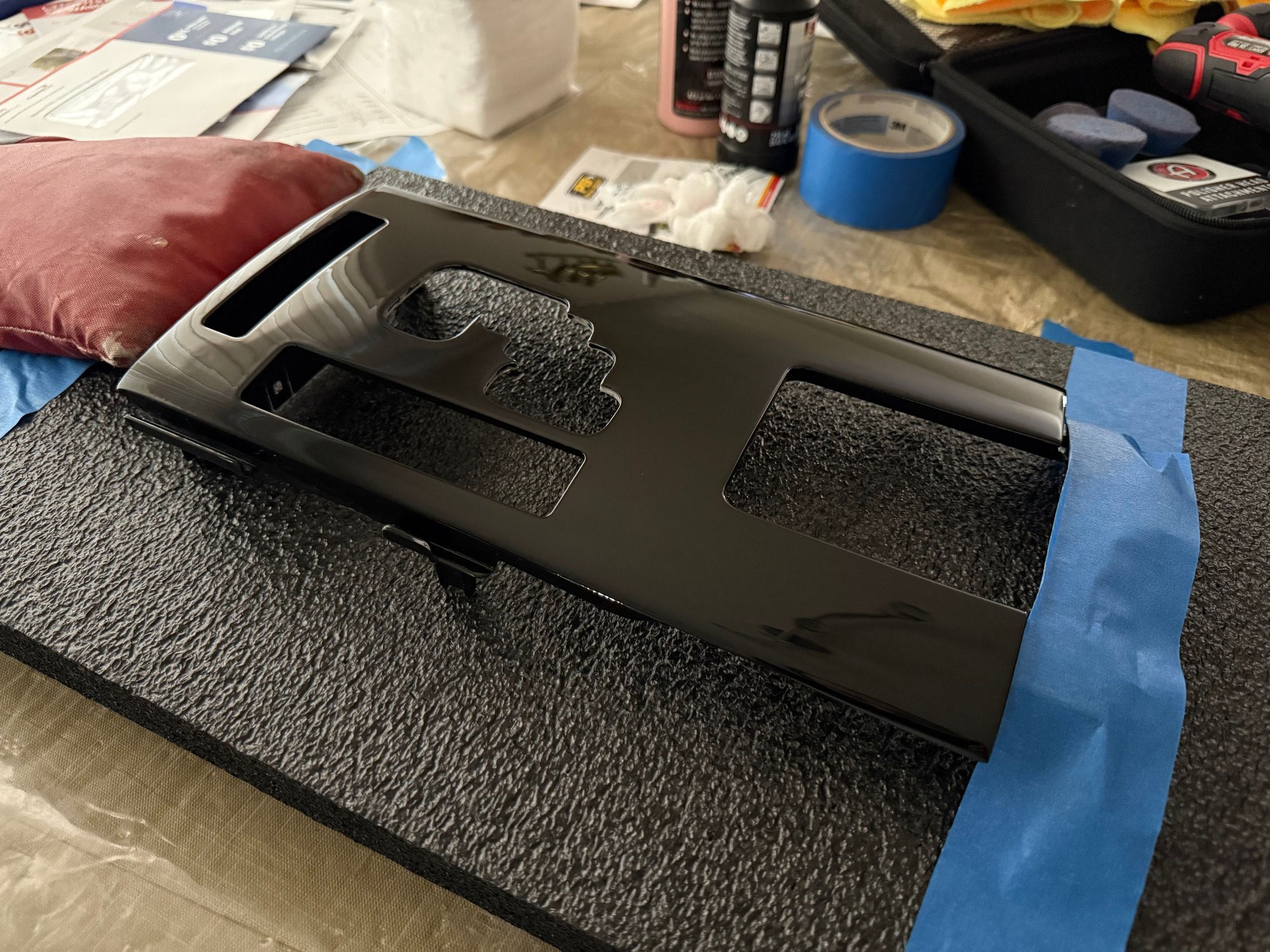

Redid the center console clear coat and decided to try a different finish on the shifter gate trim, I think it turned out to be almost like a brushed titanium look

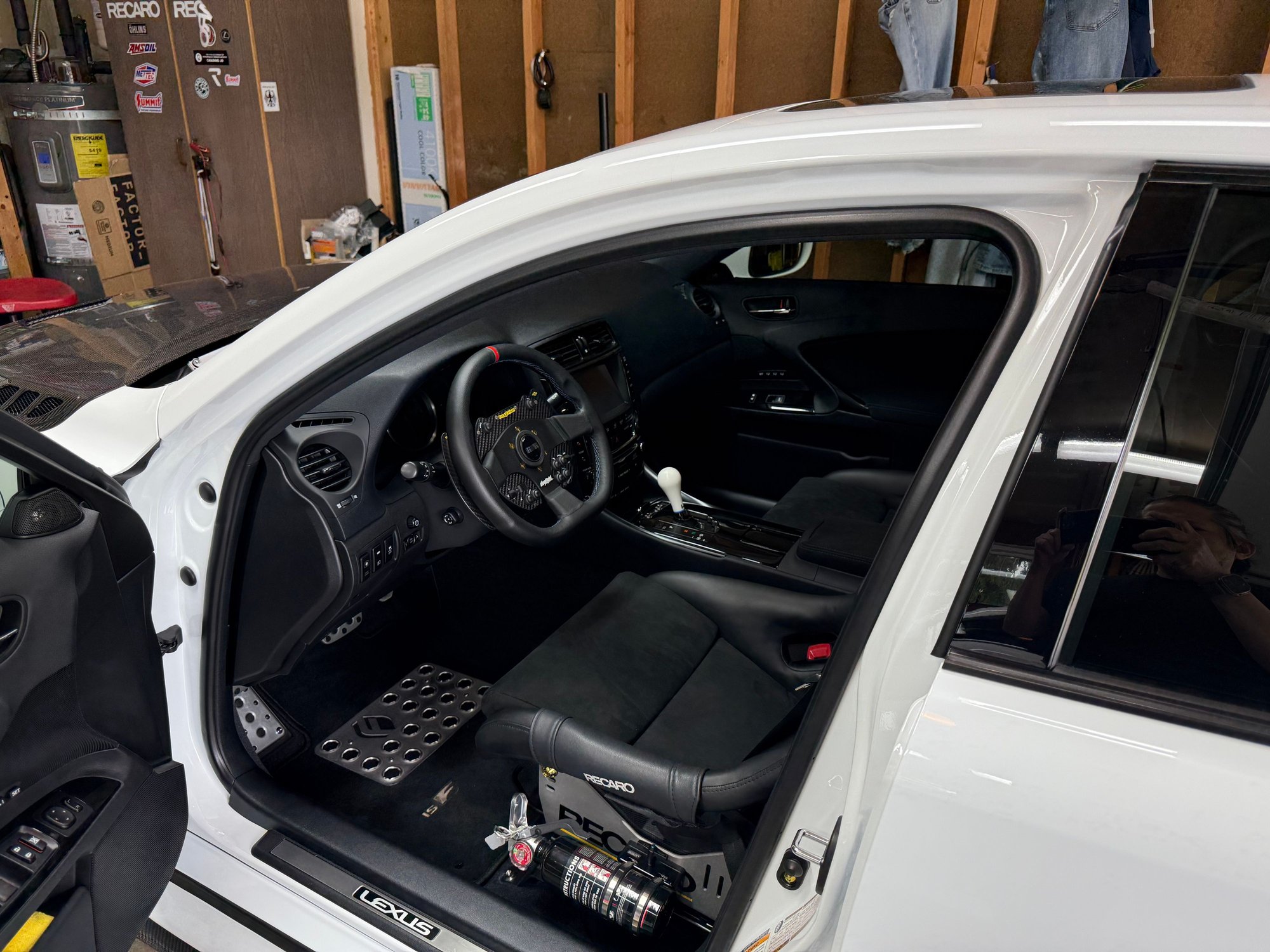

Changed up a couple things. Bloxracing Honda shiftknob and black CF (hydrodipped) mirror covers.
White shiftknob was not available with M8 threads so I ordered the M10. Drilled, tapped, and used a thread insert.

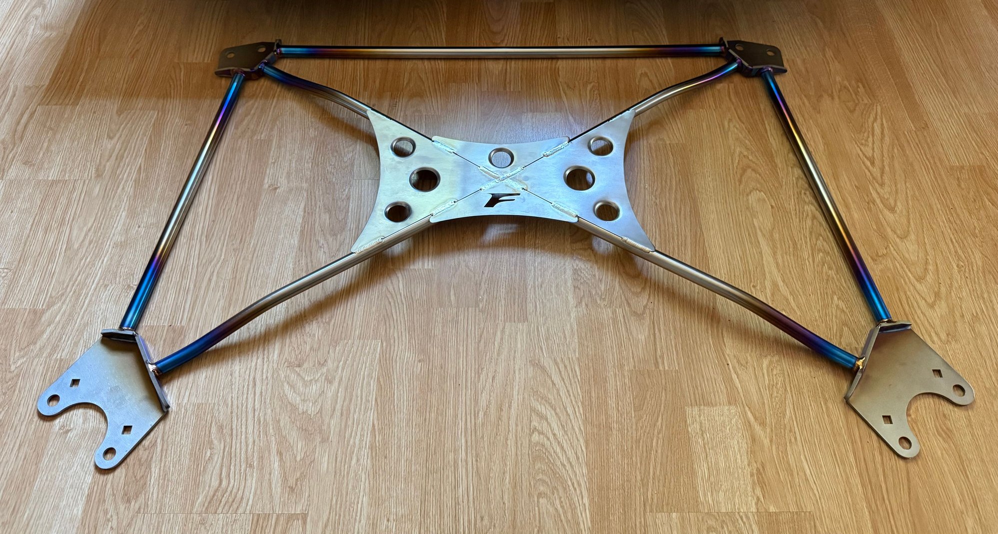

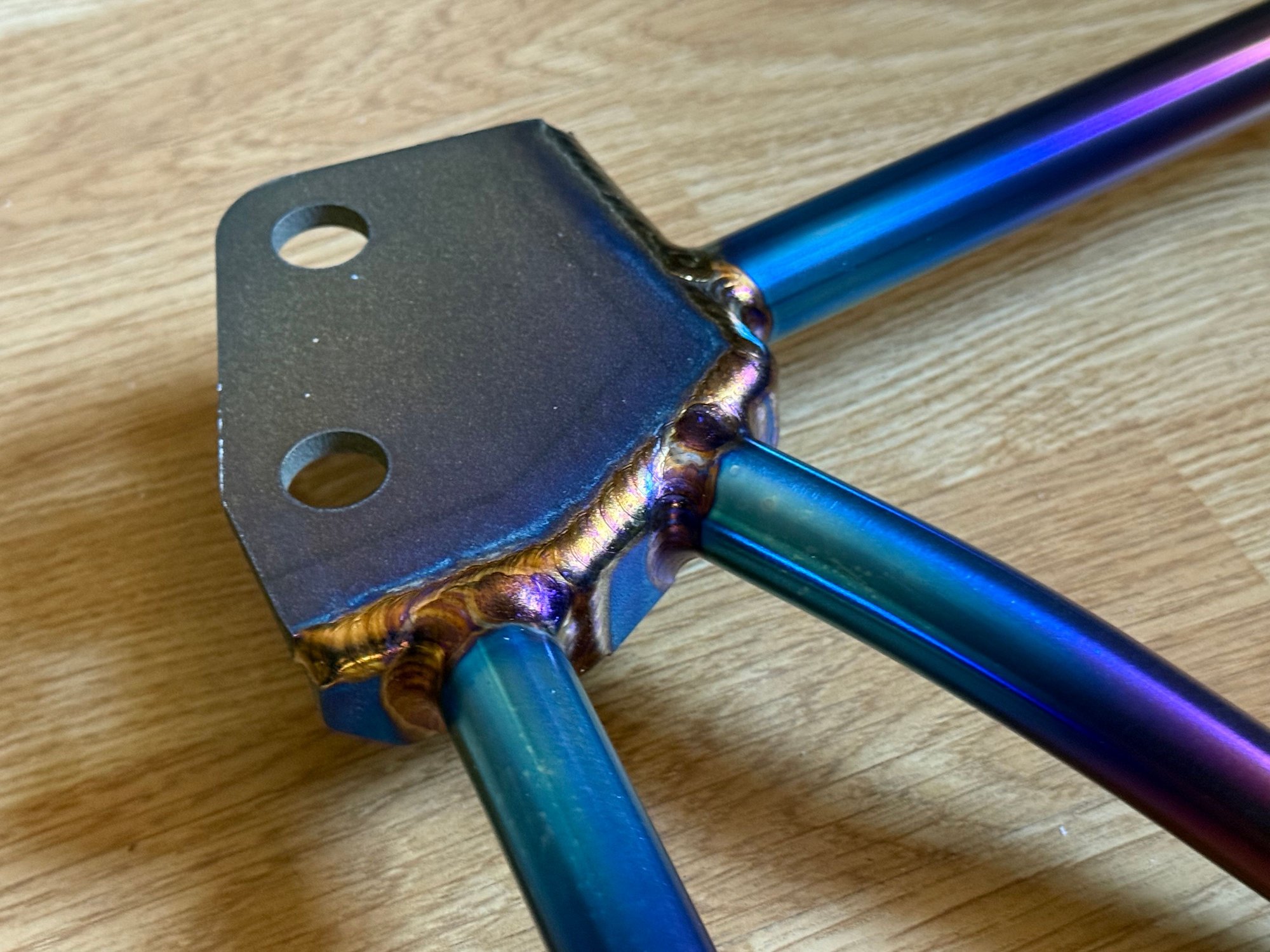

Titanium rear underbrace!
Nice!
I remember seeing a post from the guy that had these Ti braces made. I knew it was just a matter of time until one of these found its way onto your build. 🤣

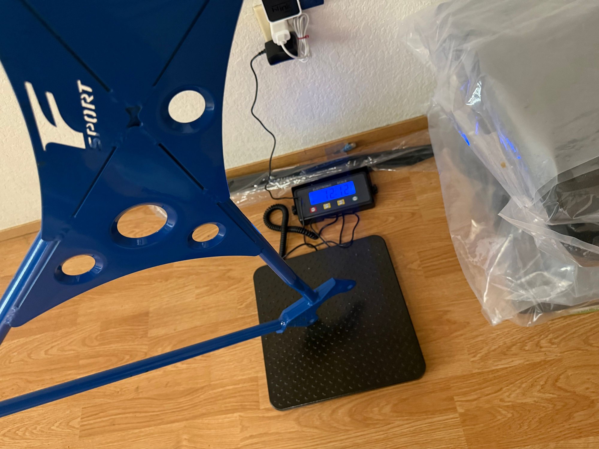

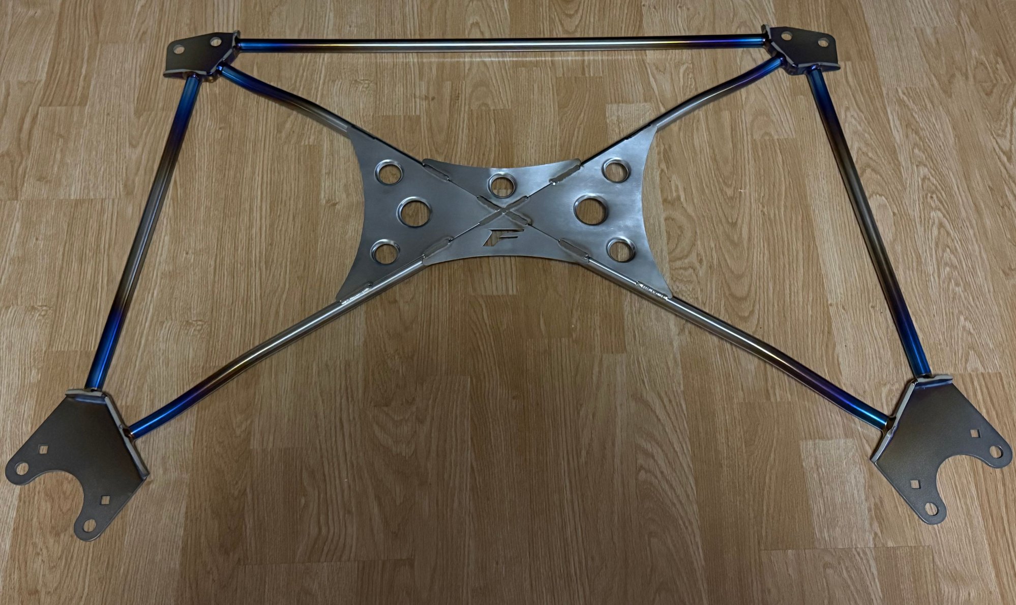

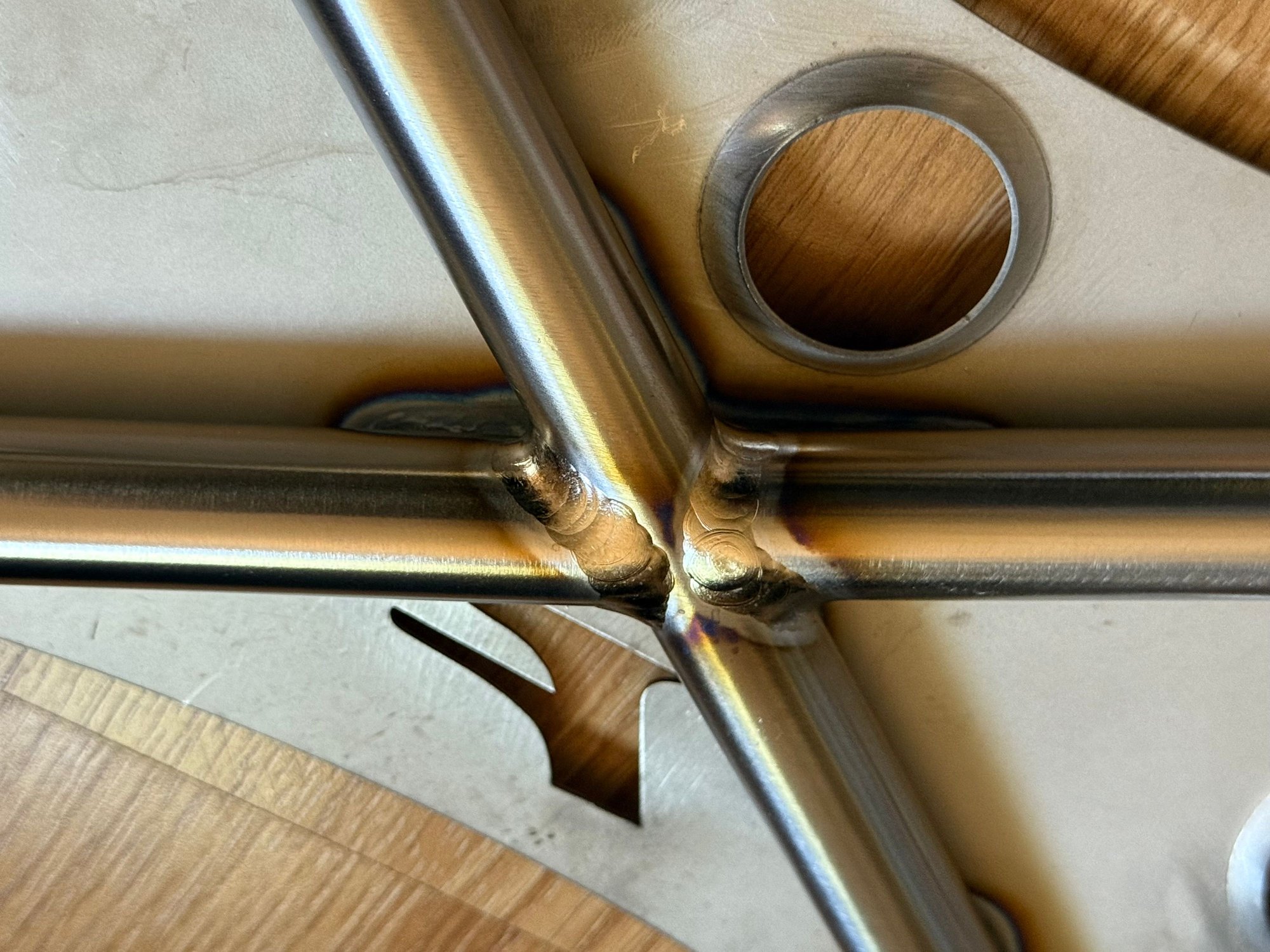

F Sport brace
F Sport brace, 12lb 12 oz.
Titanium brace
Titanium brace, 6 lb.
