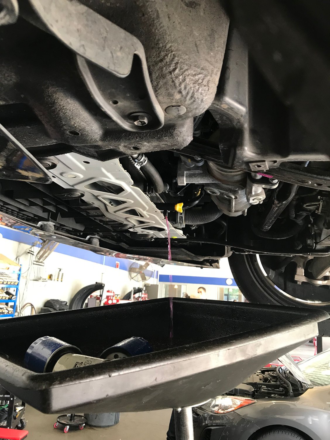

Just for grins I swapped out some coolant.
Figured 27k hard miles.
Never tested the old stuff. It was probably just fine for street driving.
The system holds 12+ quarts I think but I only put back like 7+
Couldn't drain what’s in the head so it was a 75% coolant swap...

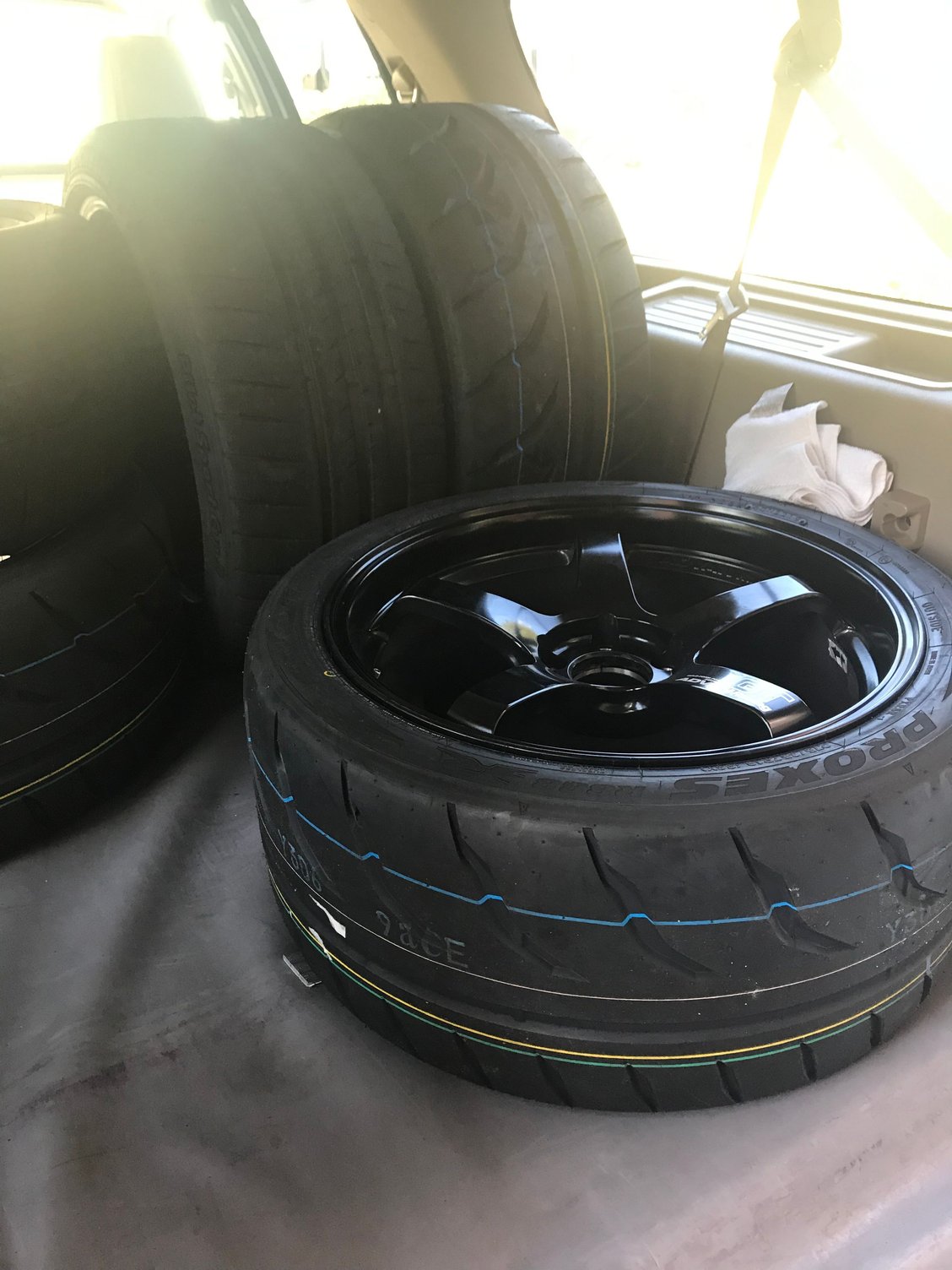

Didn’t like the Cup2s. Didn’t like em the 1st set. Thought I’d give a second try. But this time didn’t like neither so I’m done with them. It’s just my driving style I guess or possibly the small stagger.
For me, they grip till they don’t and just lets loose.
Went back with tried and true for me. R888r square 275/35
The Toyos have a much more progressive grip loss. Much easier to drive at the edge and know how much grip left.
Biggest trade off is the side wall. The Cups do have a better wall thus sharper turn in.

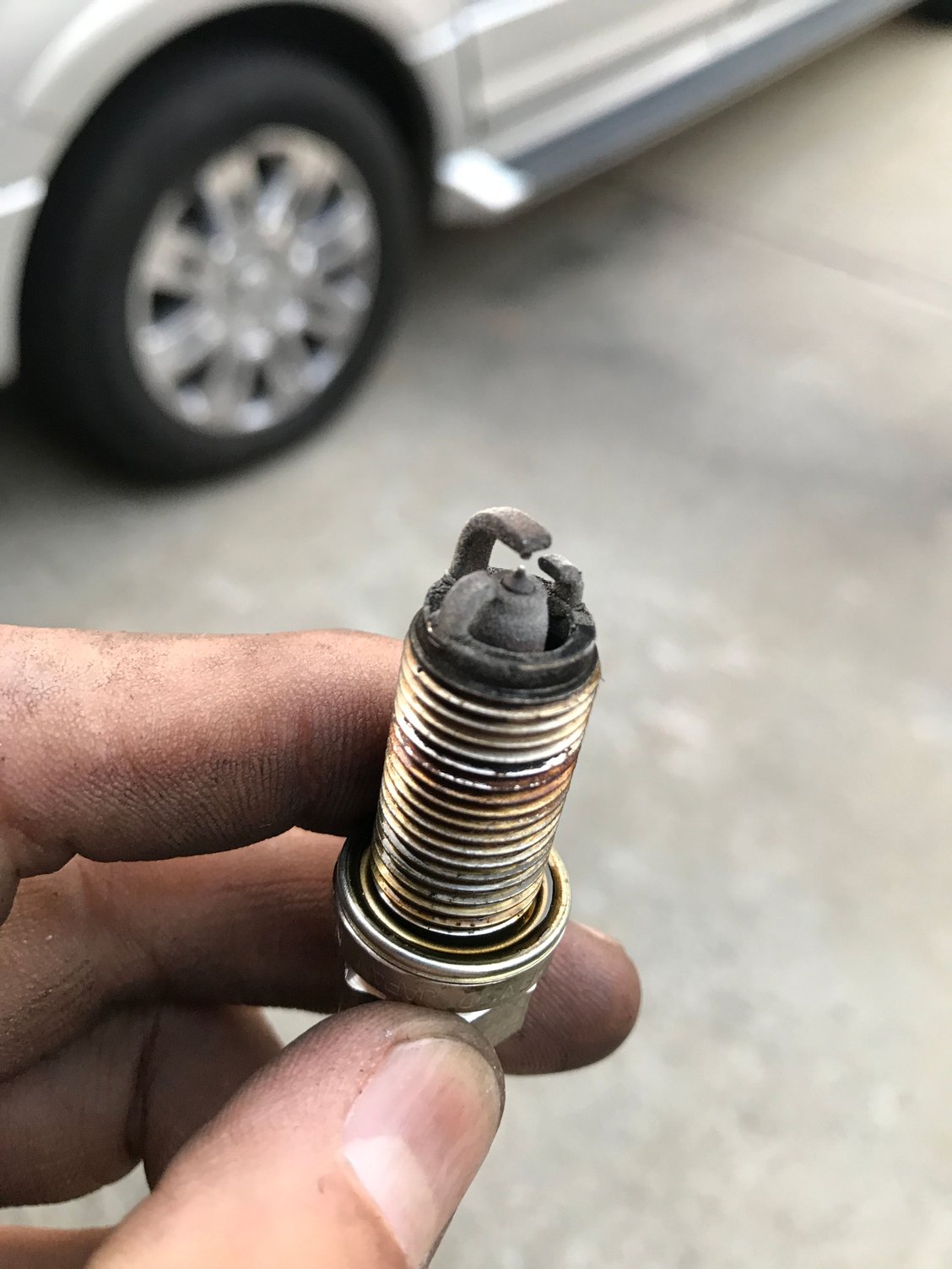

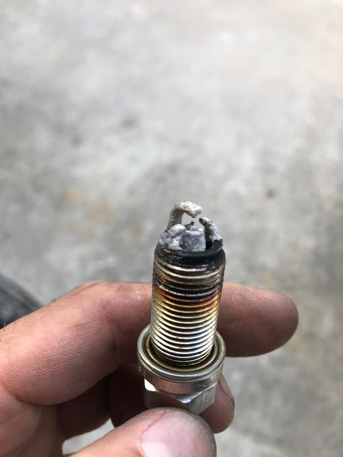

Left to right #1, #3, #5, #7
I swapped spark plugs today at 27k miles. Wanted to try those colder plugs that Konichiwa recommended.
Holy cow the old plugs looked terrible!! Heavily oil fouled plus grey buildup which I will assume is detonation from being lean...
I’ve always knew my motor had heavy blow by, due to the amount of oil I catch in the AOS, even though I used the highest possible grade oil and gas (amsoil and shell v power). Plus I do maintenance way way way before it’s due.
There were a little bit of Ti in the most recent oil analysis, which did clue me in that there were some valve damage happening, which is probably from being way lean. Wonder if RR tune needs to be tweaked or I got a faulty fuel pump or something fuel related.
No good. Big track day next weekend at NCM too...
Guess I’ll have to start data logging to find out. Car feels fine & idles normal before and after plug change.

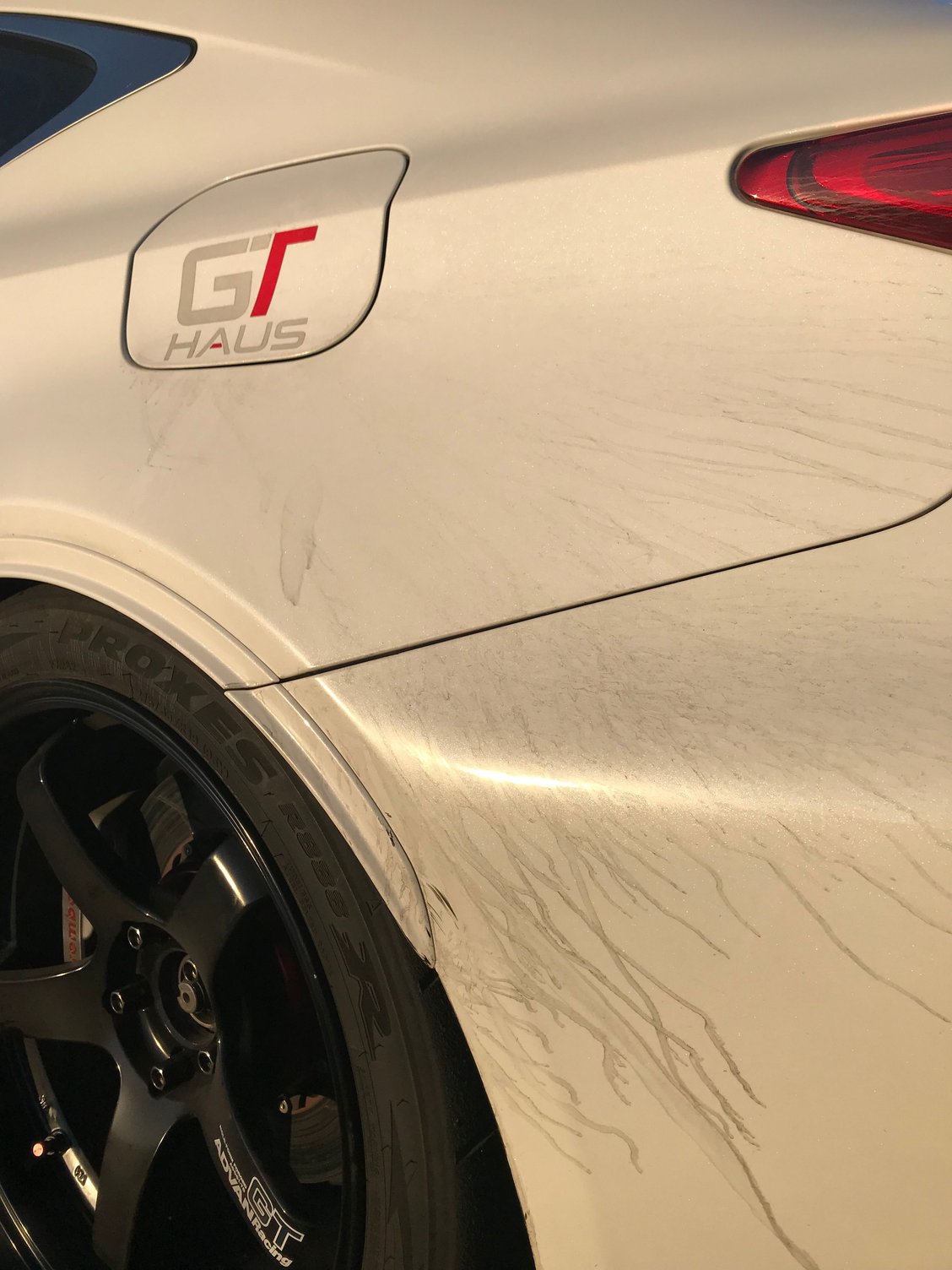

Had a track day at NCM this past Saturday. Super fun. Most awesome track!
But on the last two sessions, I noticed fuel leak out the gas flap. Couldn’t tell if it came out of the evap vent hole or the cap itself. Bummed that I’m dealing with these issues since the F isn’t that old. Hoping it's just a failed gas cap. Other wise I’m guessing it’s gonna be a purge solenoid/check valve type issue.

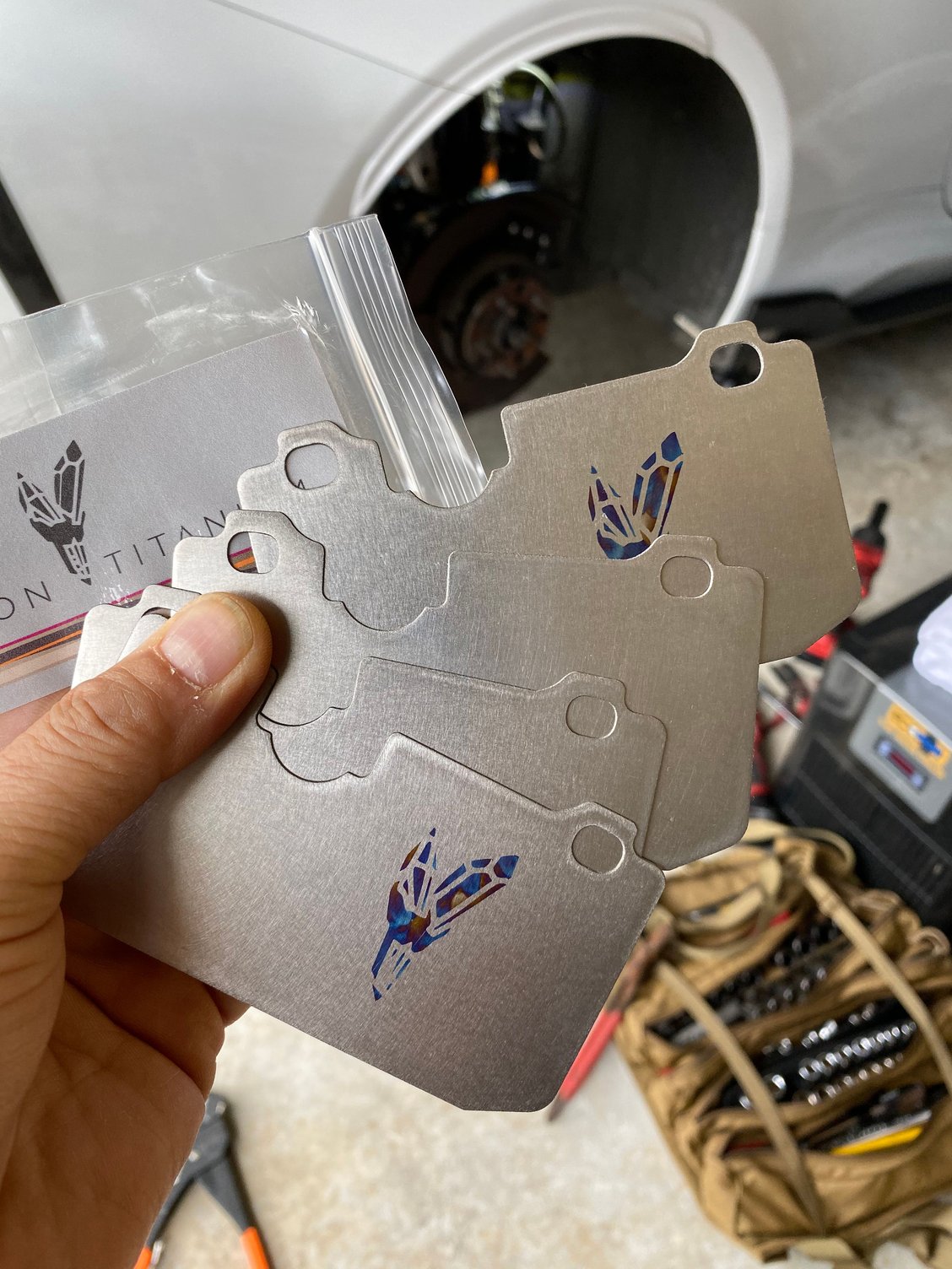

Added these Ti brake pad shims from Yperion. what a huge difference!!!
Think the pad temperature was just never quite high enough before due to heat loss through the pistons & calipers. Mind you that I’m running endless ME race pads that need more heat than the typical street/oem pad.
The braking power increased dramatically this time on track and with zero fade. Typically I get a little bit of fade at the end of the session at Road Atlanta since it’s so brake heavy.
For serious track guys, it’s a must have!

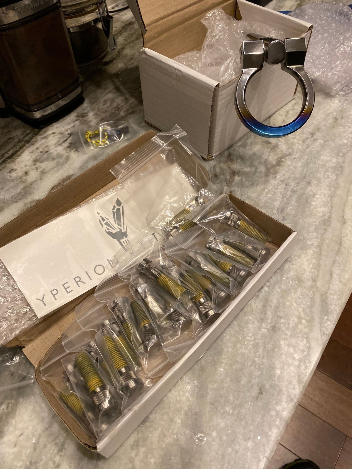

Finally got my custom Ti studs in. Just gotta find time to install.
Will weigh all the oem studs once I get em out and see how much rotational mass was saved.
They have a special coating on them so the Ti lugs won’t seize up on the Ti studs.
Got the custom Ti tow hook too but the shank threads were wrong.
Yperion is making a new one so I’ll have to wait another few months...

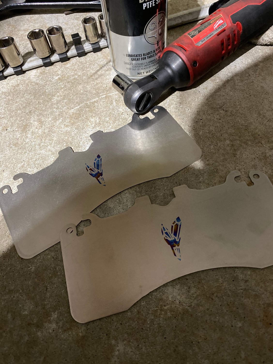

Default Since it’s almost new year, it’s out with the old and in with the new!
Oem rear shims
New Ti rear pad shims.

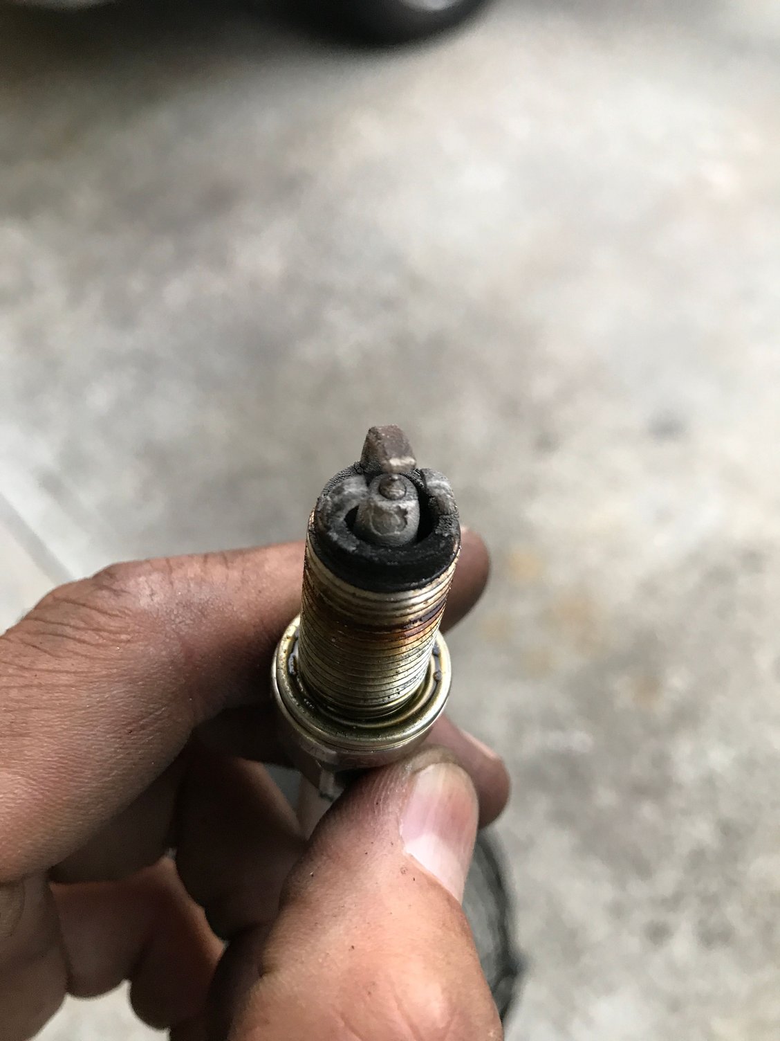

Which plugs did you switch to?
