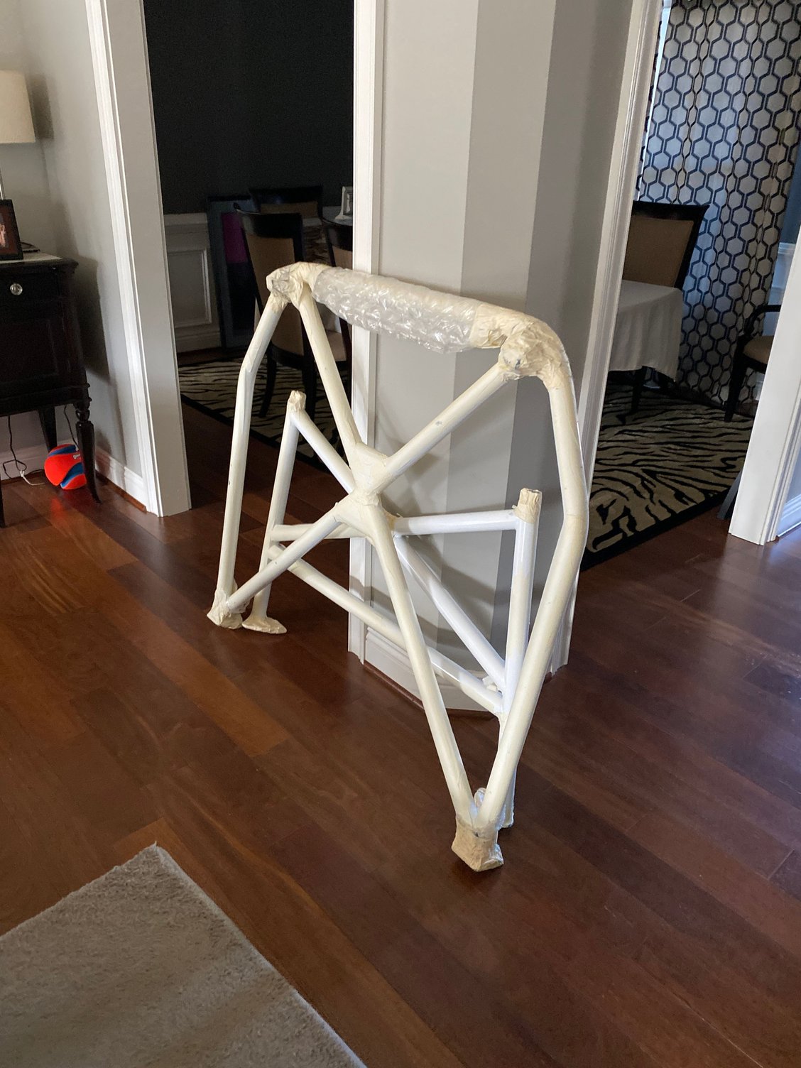

Wing is done. This is next! Same half cage as Lammyy’s.

Excited to see this installed! I have one coming as well! Any chance you'd be willing to post pics of the mounting locations and how it's bolted to the floor?
Also, that wing looks gorgeous! Beautiful build!
Thanks for the compliment.
Yeah man, I’ll try and document cage install as I go.
