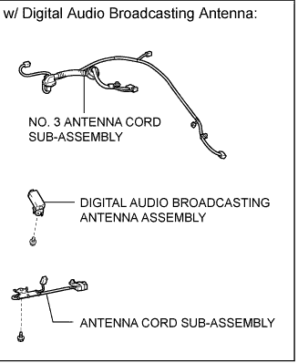

Default Installed the JuNa JRDAB-05
Today I've installed the package, and all works fine.
It's all plug and play.
Most work is running one of the cables from the back of the center console all to the middle of the console.
To get access to the center console, you need to remove the passenger chair, and remove the console panel, to run the cable.
Edit: just added original Lexus installation instructions.
The device is especially for Lexus/Toyota.
