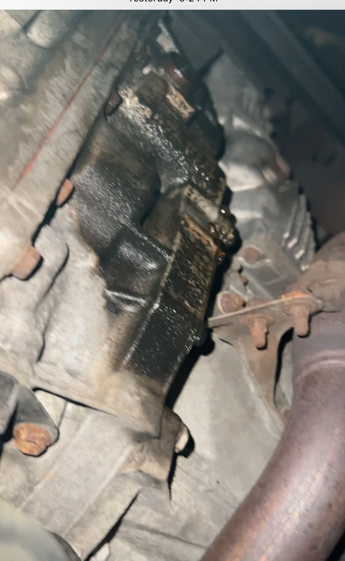

So my 2013 Rx350 F sport with 77k started leaving oil spots overnight.
Since ownership underneath the Rx has been oil free. Recently, my oil was changed at the Lexus dealership in November, and the alternator went out on me three weeks ago and was changed by an independent mechanic. I started noticing the oil droppings four days ago.
I can’t locate the leak from the top of engine bay.
From doing some research over the pass couple of days, the leak could be the rear main seal, or the timing chain cover.
With no warranty it looks this is a $3k plus repair.
In some instance some owners have had recurring leaks after having the dropped and the seal replaced.
How have some of you guys who have experienced this handle it?

Clean it off with some spray brake cleaner (when the motor is cool) and watch to see where it starts leaking again, or if it does leak. I would also get a wrench and check all of those bolts for looseness. Others have found loose bolts on the timing cover.
To see the timing cover leak you have to remove the passenger side front tire, get a flashlight and look through the wheel well at the left front side of the engine timing cover. But your photo is of a different area of the engine, it looks like the side near the exhaust manifold down pipe.

Your pic is at the cover plate for the torque converter to flywheel access bolts, which is in the RMS area, but as suggested above, do not assume it came from there. Oil fles around a lot and seems to accumulate in that location. My 2GR-FE had same oil residue there, and since I had the engine out anyway, I replaced the RMS, but it was bone dry, that residue must have come from some other place in my case. Even a sloppy filter change can do it...

Hello Gents,
Over the weekend, I was able to get under the vehicle and further diagnose the source of the leak with help from a friend.
The leak is indeed coming from the rear main. The funny thing is the amount of oil that's dripping down overnight onto the cardboard cut-out that I placed under the vehicle has reduced. My drive miles are still the same. The oil level on the dipstick remains the same. I will continue to monitor the dipstick.

That's bad news. You can buy a lot of oil for what it would cost to replace the RMS. If you do, be very careful to put some grease on the spring of the seal before tapping it in, it can jump off and end up in the crankcase otherwise, and you'll never know it, the new seal will just leak. If you go that route, I would R&R and reseal the RMS retaining plate/holder, which avoids spring jumping off problem as well since you can mount the seal in it outside of the engine.
Retaner:
Old Jan 9, 2023 | 01:27 PM
Mesquite77's Avatar
Mesquite77
Joined: Mar 2017
Posts: 616
Likes: 276
BTW, note that the seal holding plate is also sealed with RTV around the perimeter, and that may be source of a leak instead of, or in addition to the RMS.
