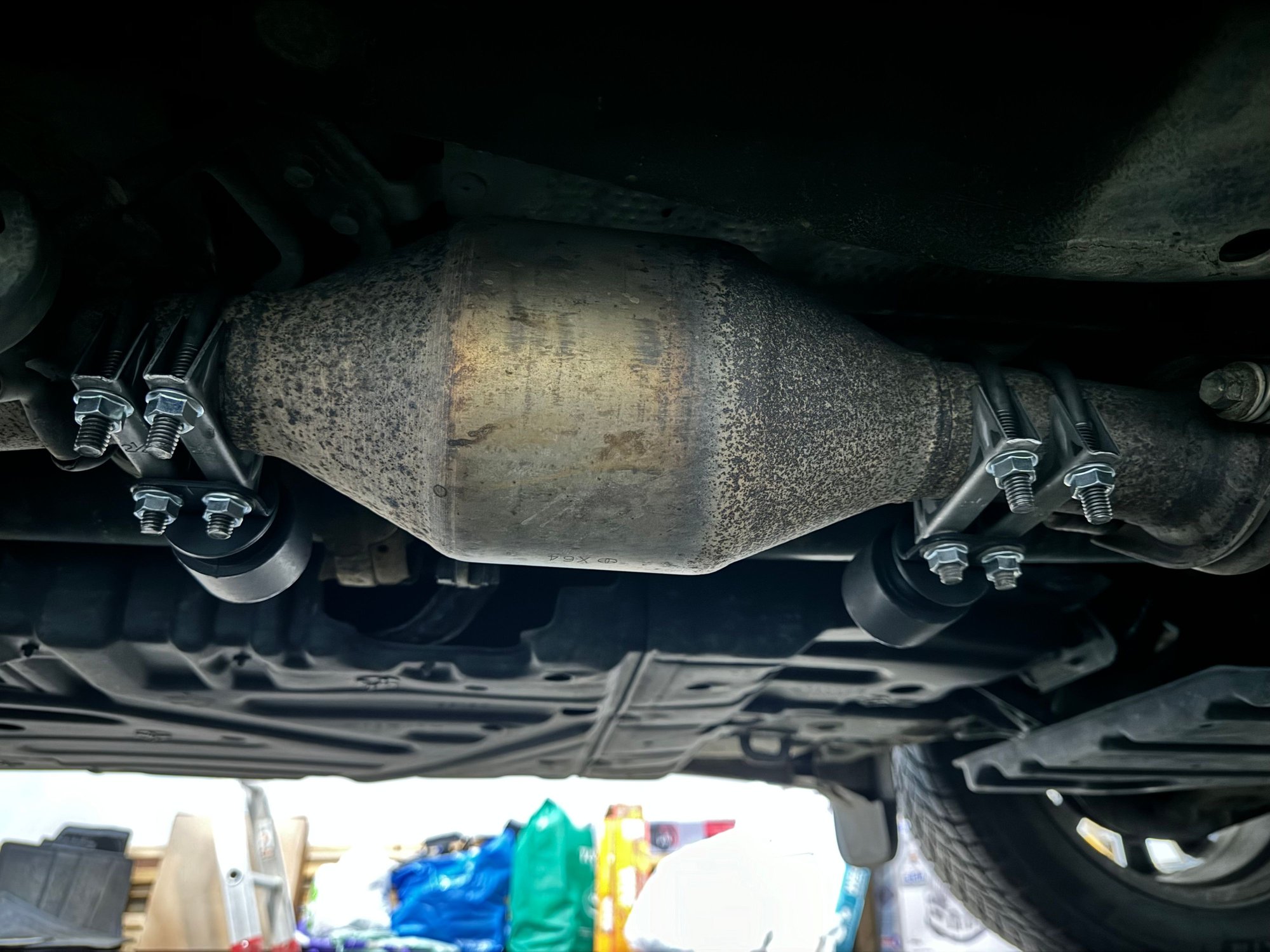

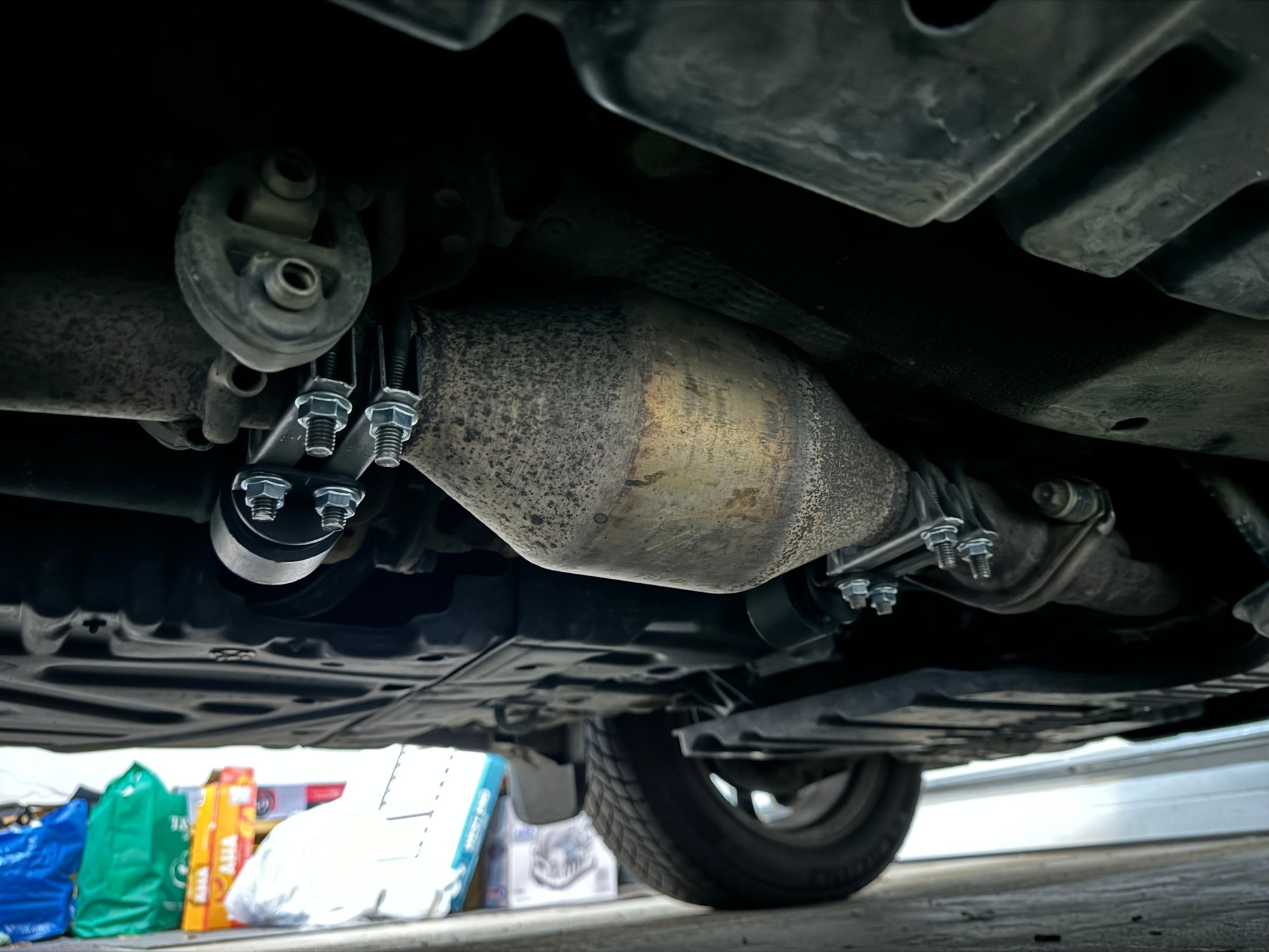

Thanks. So I got the appropriate clamps and completed the installation. Noticed that the drone at 1500 rpm’s have definitely vanished. However, some higher rpm drone still exists. Along with this, I now hear a little bit of a rattling noise.
How tight has everyone torqued down the nuts? I feel like I can keep tightening but don’t want to risk bending anything. Also, what can I do for my drone at higher rpm’s (2800 ish)? Hopefully I’ve installed them in the correct locations.
See below for photos of installation.

It looks good and should be tight enough so they don't loosen up. You can always put on another nut as shown in the photos in prior posts. Or use some lock washers or Loctite thread locker if really worried about this issue. I would just leave as is and check them in a month or so.
You probably have to just live with the other drone as part of the RX350 experience we all endure.

You can try to change the mounting angleto offset one from the other. That might help with the higher rpm vibes. Tighten them good and tight. Locktite won’t work due to very high temps from the cat converter.
