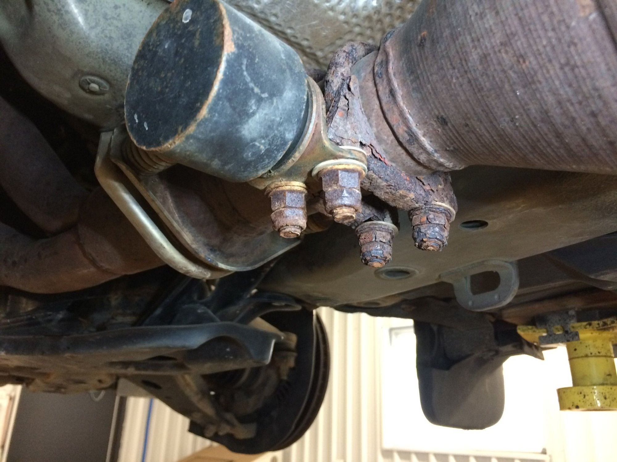

The clamps are rusting quite a bit from the high temperatures. Should have used S/S clamps

Even with the rust they will last as long as the exhaust system is in the car.

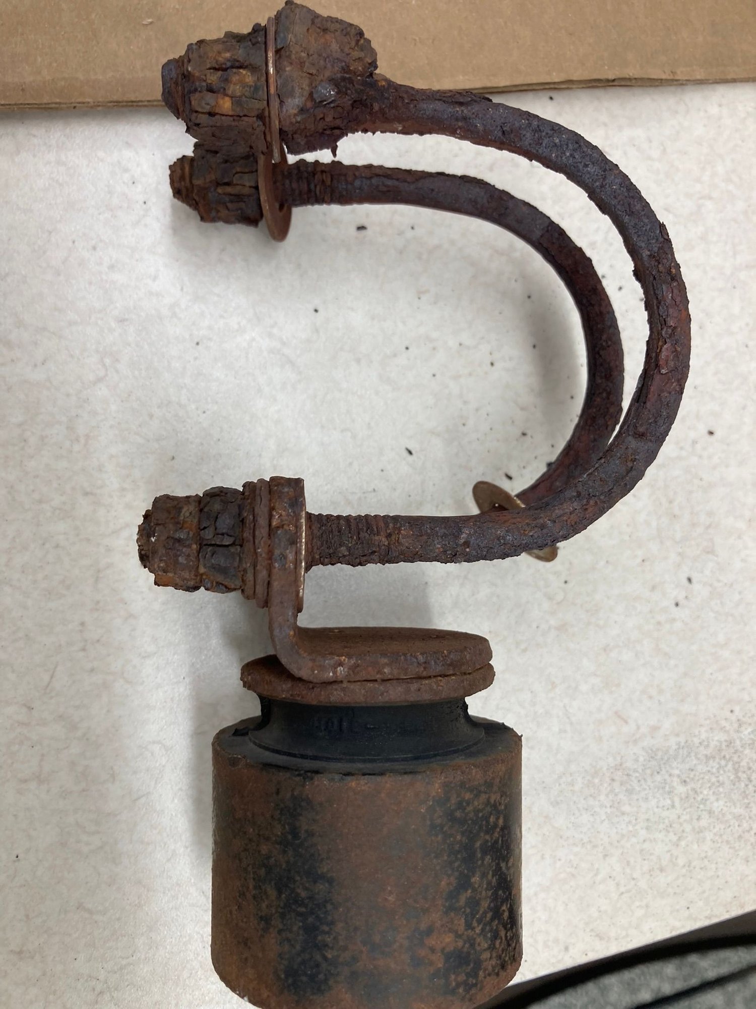

Nope!! The steel saddle clamps completely rusted away on the one upstream from the converter! Fortunately it didnt fall off.
S/S clamps coming up.

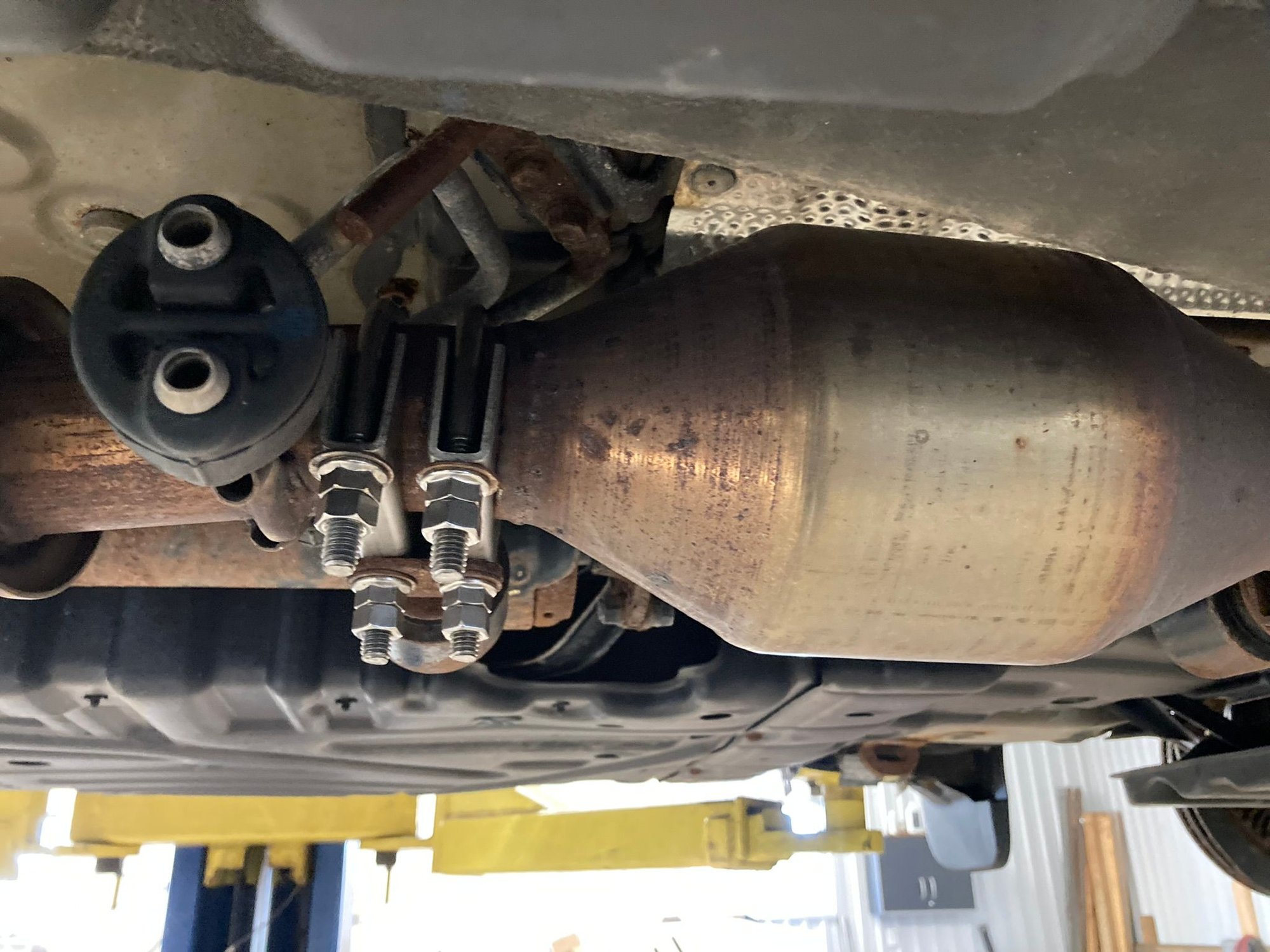

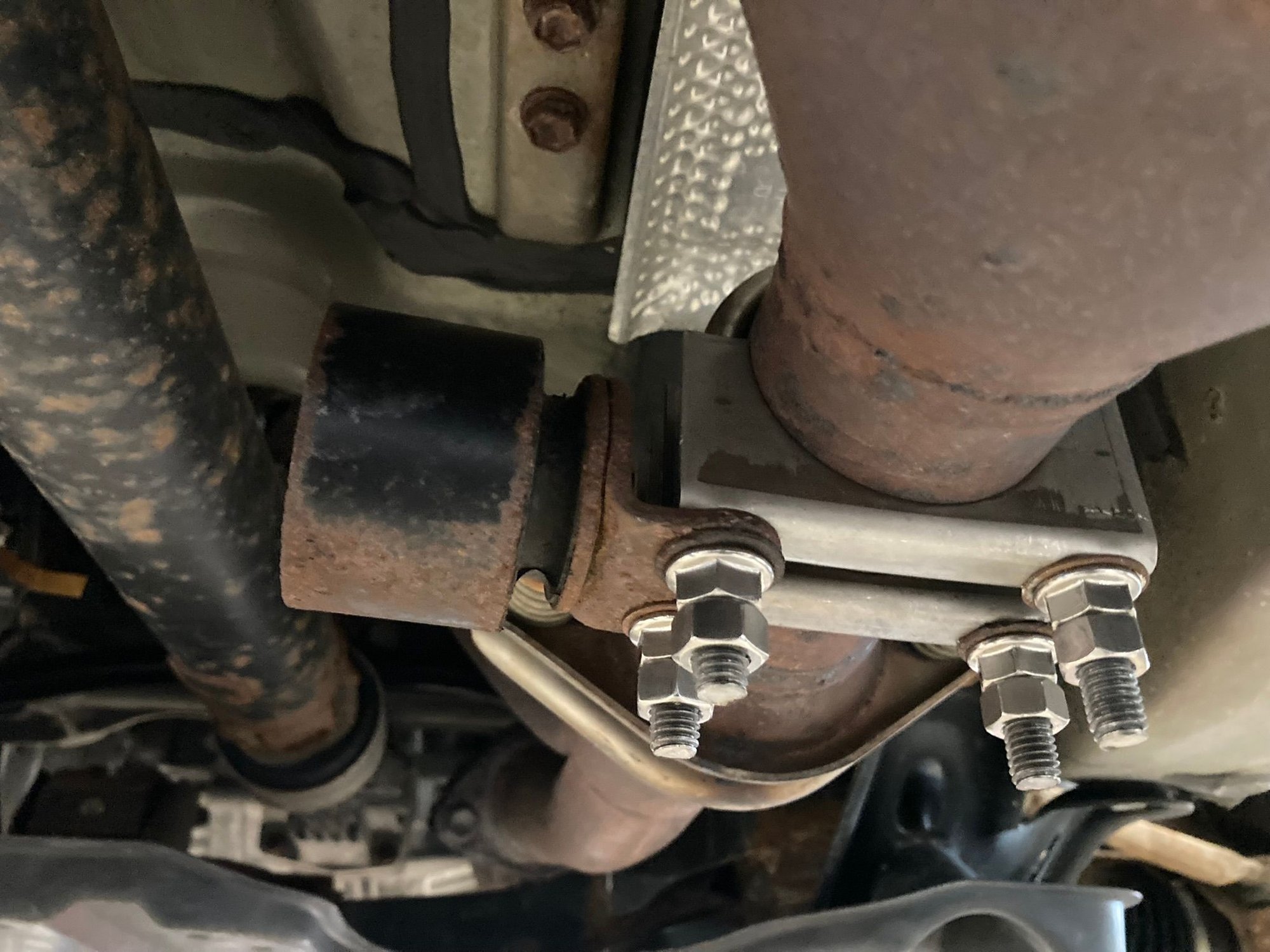

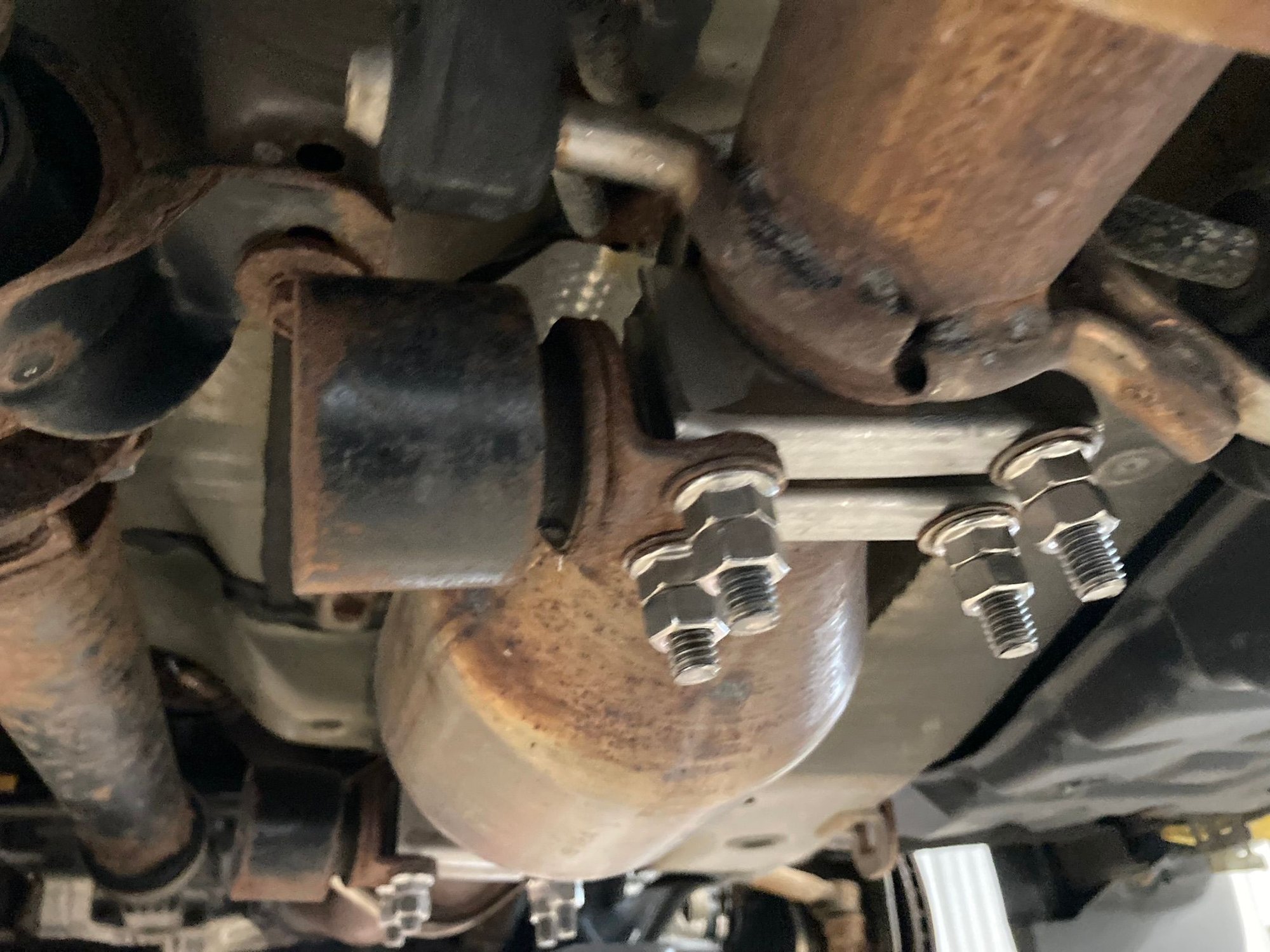

Reinstalled the 2 dampers with 2.25” SS clamps from Summit Racing. Drone gone again! Should last a very long time now.

Picked up a 2010 RX 350, initially didn't notice anything, but after a couple days of driving I noticed the droning sound. I decided to start with one damper and see how that goes, I installed it between the hanger and the resonator. I'm questioning if it did much and with more drives I'm convinced it has helped, though the drone is still there. I'm tempted to order another one.
Anyone here install one damper only and are happy with the results ?
I found that I need 2 dampers. See post 129
