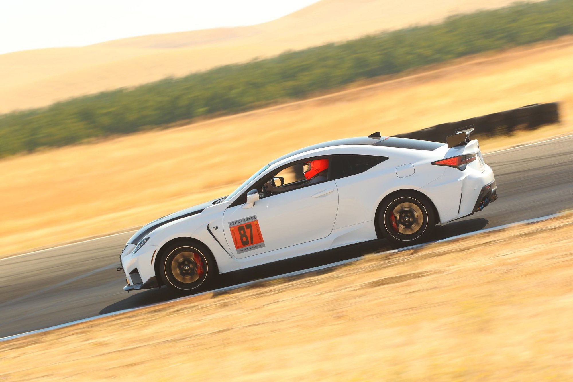

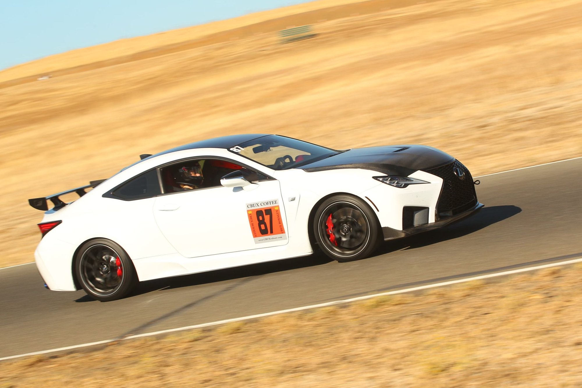

First track impressions this weekend.
Car needs to be lowered to drop center of gravity and I’m sure penskes will help with overall weight transfer.
Stock PS4S configuration was the main limiting factor in my opinion. The rear loves to slide when aggressively ramping up throttle upon exiting turns. This is worse the sharper the turn is. Front tires are also lackluster due to the large amount of weight on a 255mm contact patch in the front. Plenty of understeer. This was made worse by the fact I’m pretty big and had a passenger in the car all day. Penske’s and lowering will help there too and so will the wider R compound tires.
Was a 100F day here at Thunder Hill and I had to air down the tires quite a bit. Got them up to 48psi on my first session (from 34psi) so I aired down to 28psi and they would peak at 34-36psi. Brakes handled tremendously well but the front tire contact patch does not allow full braking potential with the weight of the car being transfered forward. That 255mm contact patch wants to slip! Heat was a bit of an issue on the engine. Both oil and water gauges inching higher. Hopefully rr-racing heatshield will help but I’d be concerned about overheating if there was boost on the engine. I ran with the hood vent open all day and no engine beauty cover.
Looking forward to trying it with the mods. I averaged ~4-5 gallons fuel consumption per 20 minute session on track. Was able to heavily pressure a c8 corvette but I feel they weren’t a very experienced track driver. No noticeable oil consumption over the course of the day and I don’t have the catch can installed yet.
I did overshoot a braking point at one point when trying to be more aggressive and drove a tiny bit off track. Car came out perfectly fine though. Just picked up a bit of dirt.
Old Aug 29, 2022 | 06:58 AM
  #83
05RollaXRS's Avatar
05RollaXRS
Joined: Oct 2005
Posts: 10,351
Likes: 2,745
From: Calgary, AB
Great write-up. Thanks for sharing. You are right about the front tires. You have to go a lot more aggressive on the tire compounds (like. Cup 2 tires or R888 or Advan A052 etc.) and/or go wider than the 255 mm front. You can also add some toe-out as well for more front end grip. I used to have some toe-out and the front-end would grip like crazy before I got an alignment and Lexus put the toe back to zero. I went with a lot higher load rating on my PS4S (Extra Load) and it made the front end a lot more planted.
Old Aug 29, 2022 | 12:12 PM
  #84
konichiwa3's Avatar
konichiwa3
Joined: Dec 2015
Posts: 484
Likes: 319
No doubt the Penske will totally transform your car. It's like day and night. Car will be totally planted and it will dial back the understeer, even without wider tires.

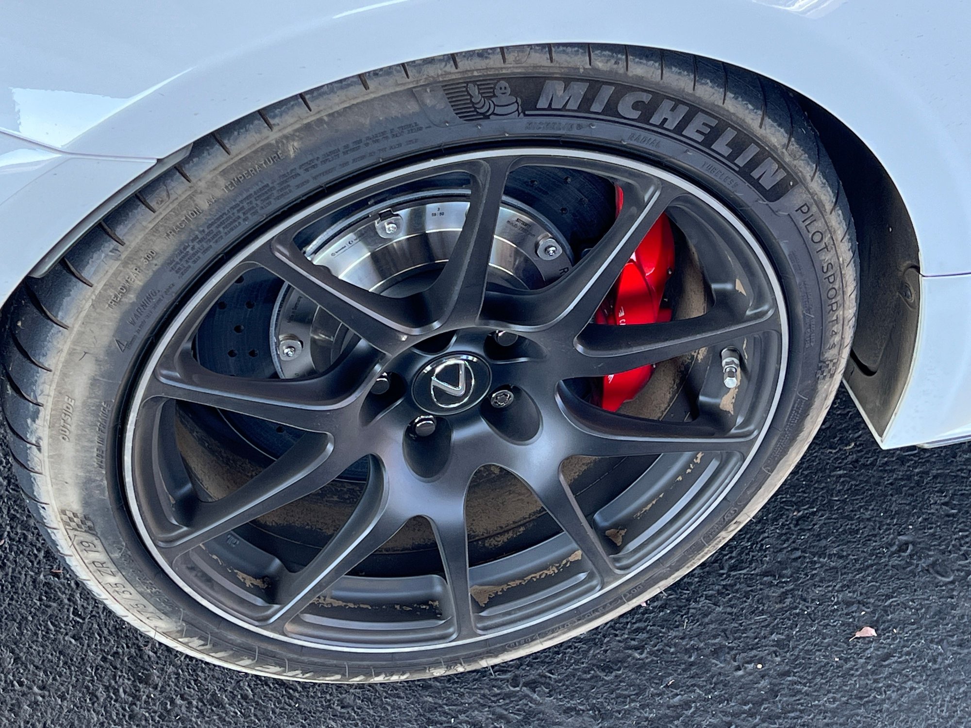

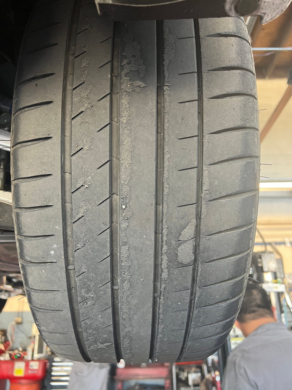

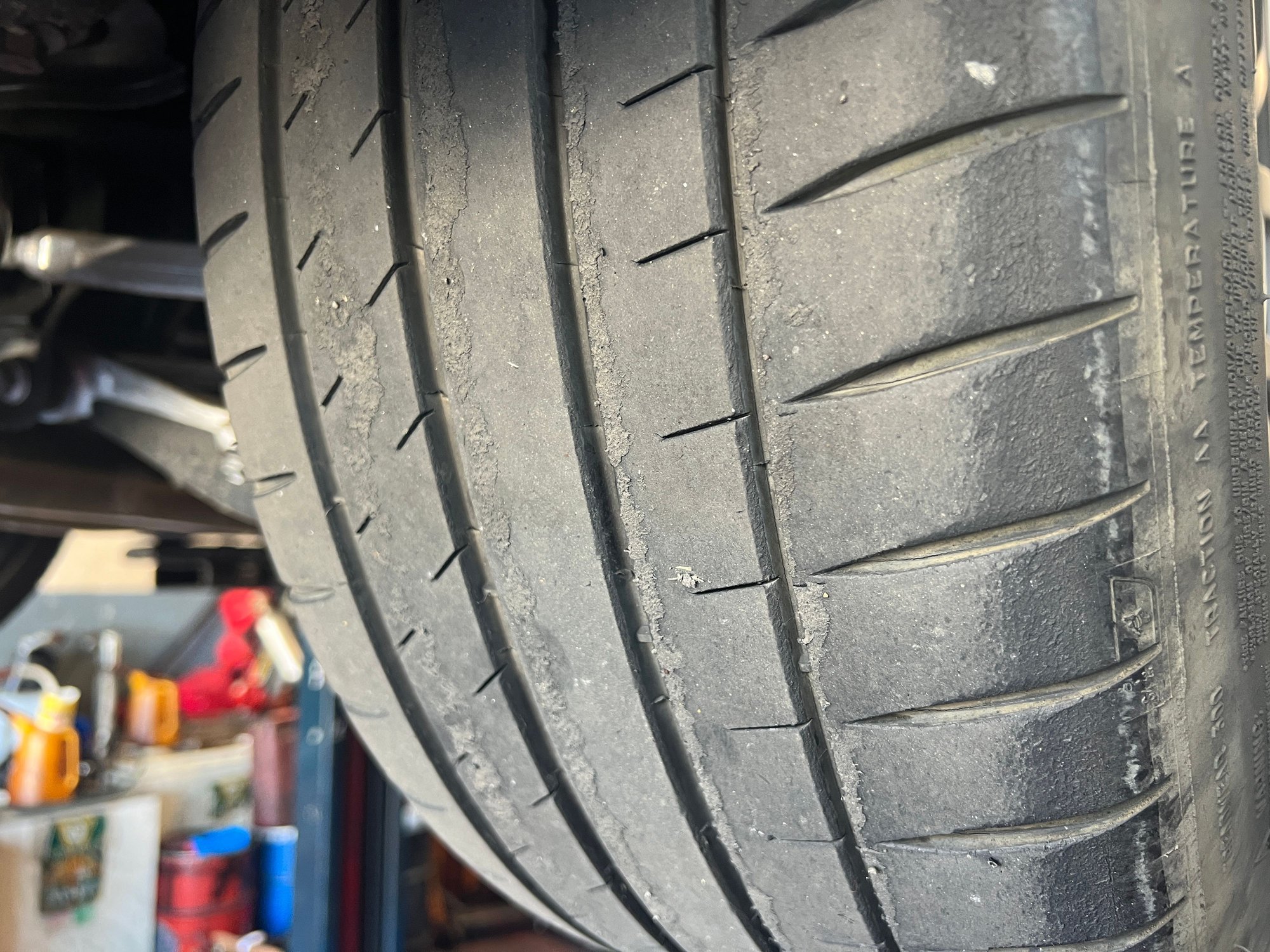

This is what tires look like after 9650 miles and one day of hard use on track.
Includes the burnout from @rp2000r before he traded in. My apologies for poor lighting on the front.
