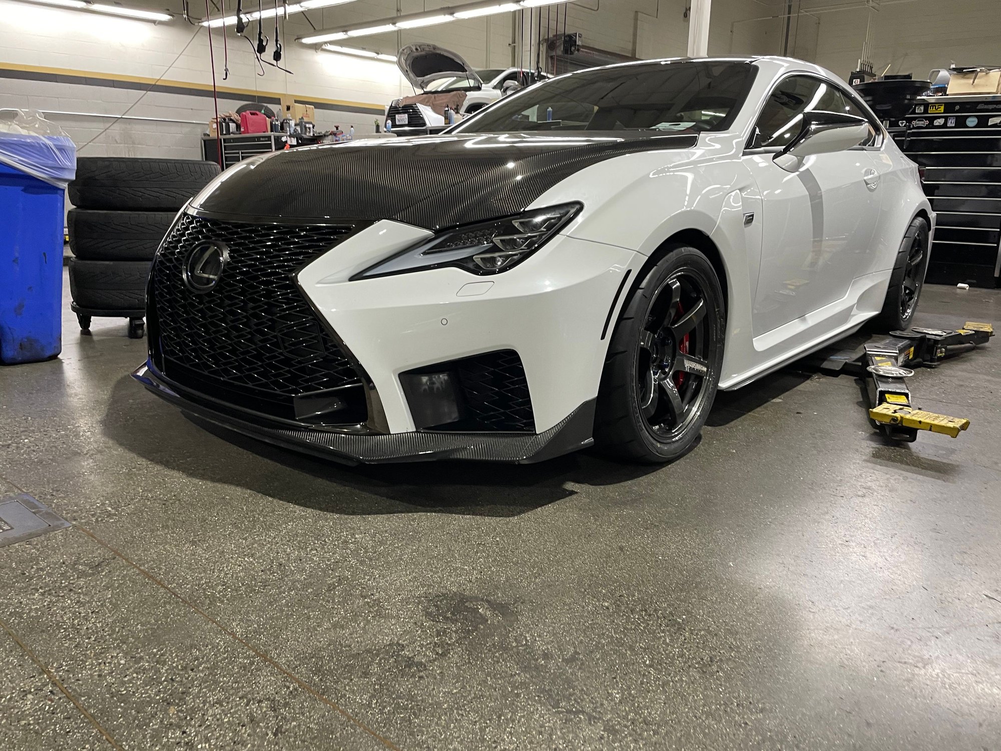

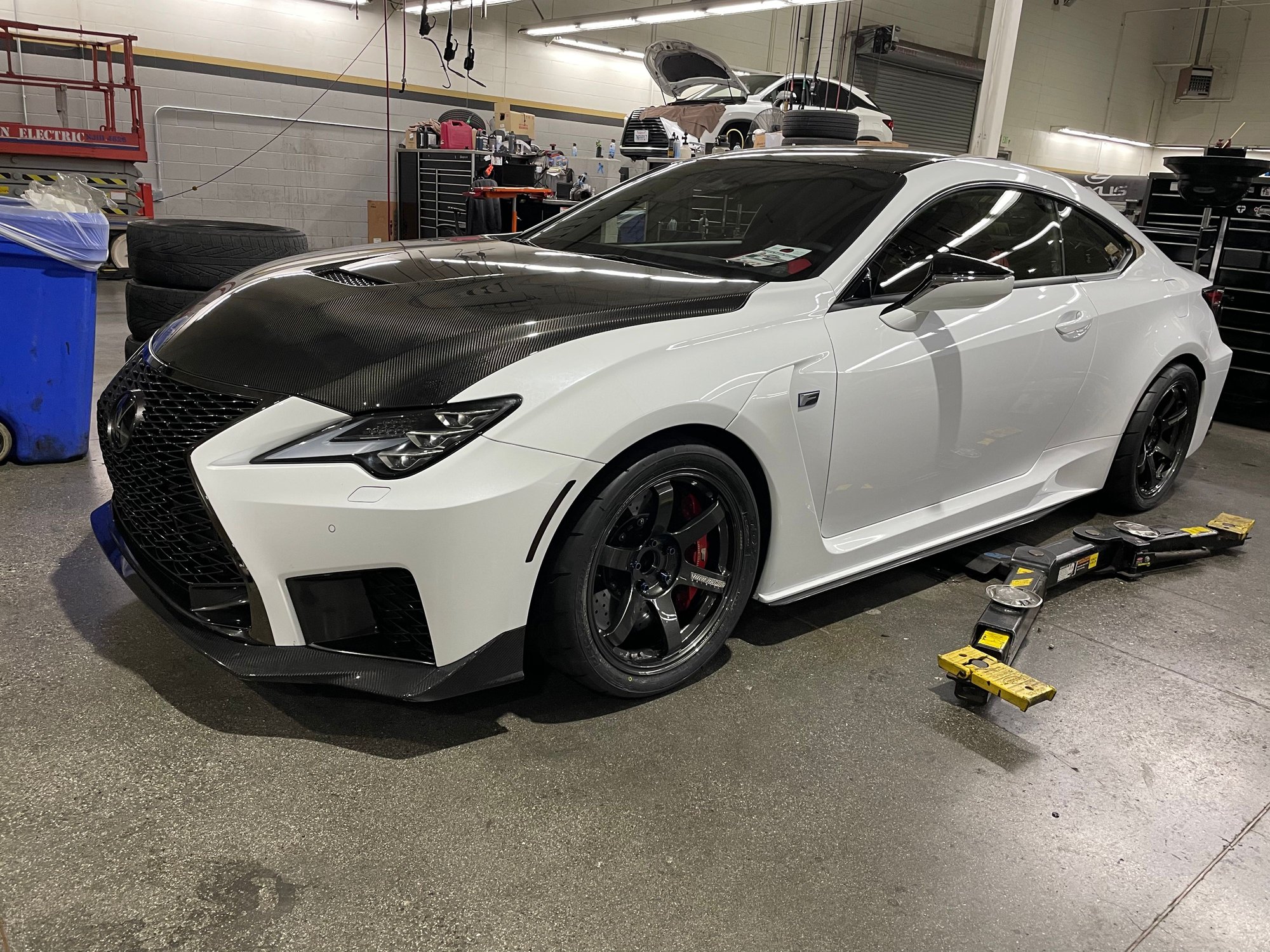

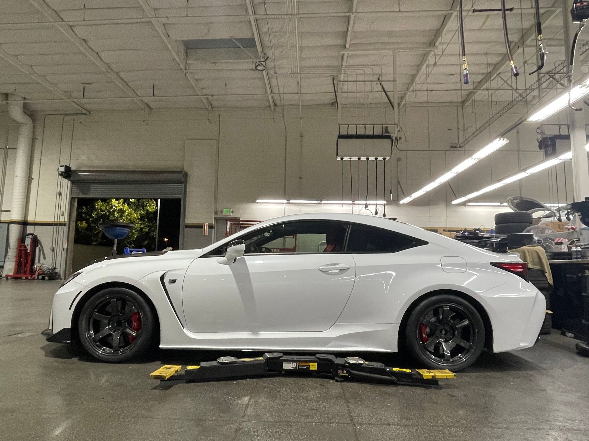

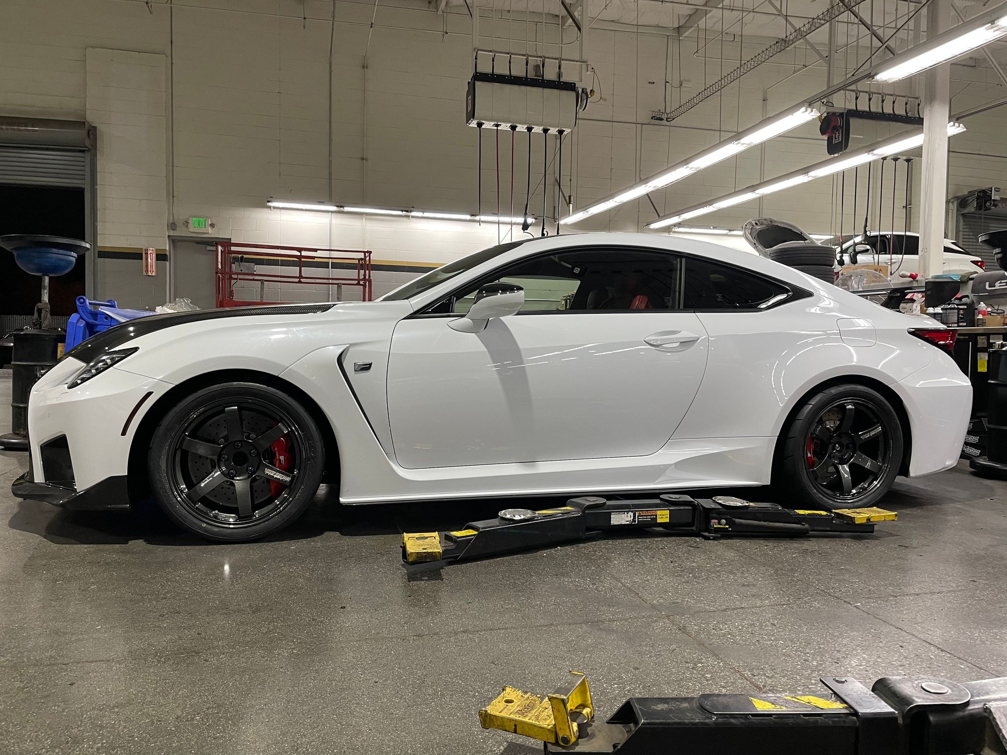

Work started on the car!

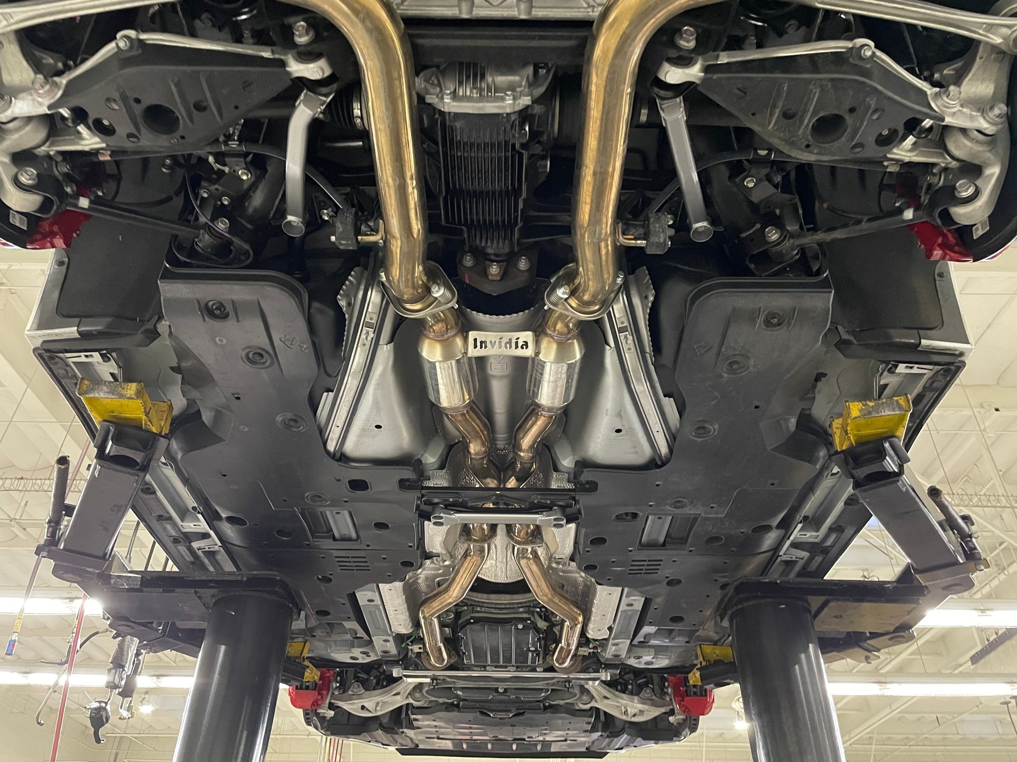

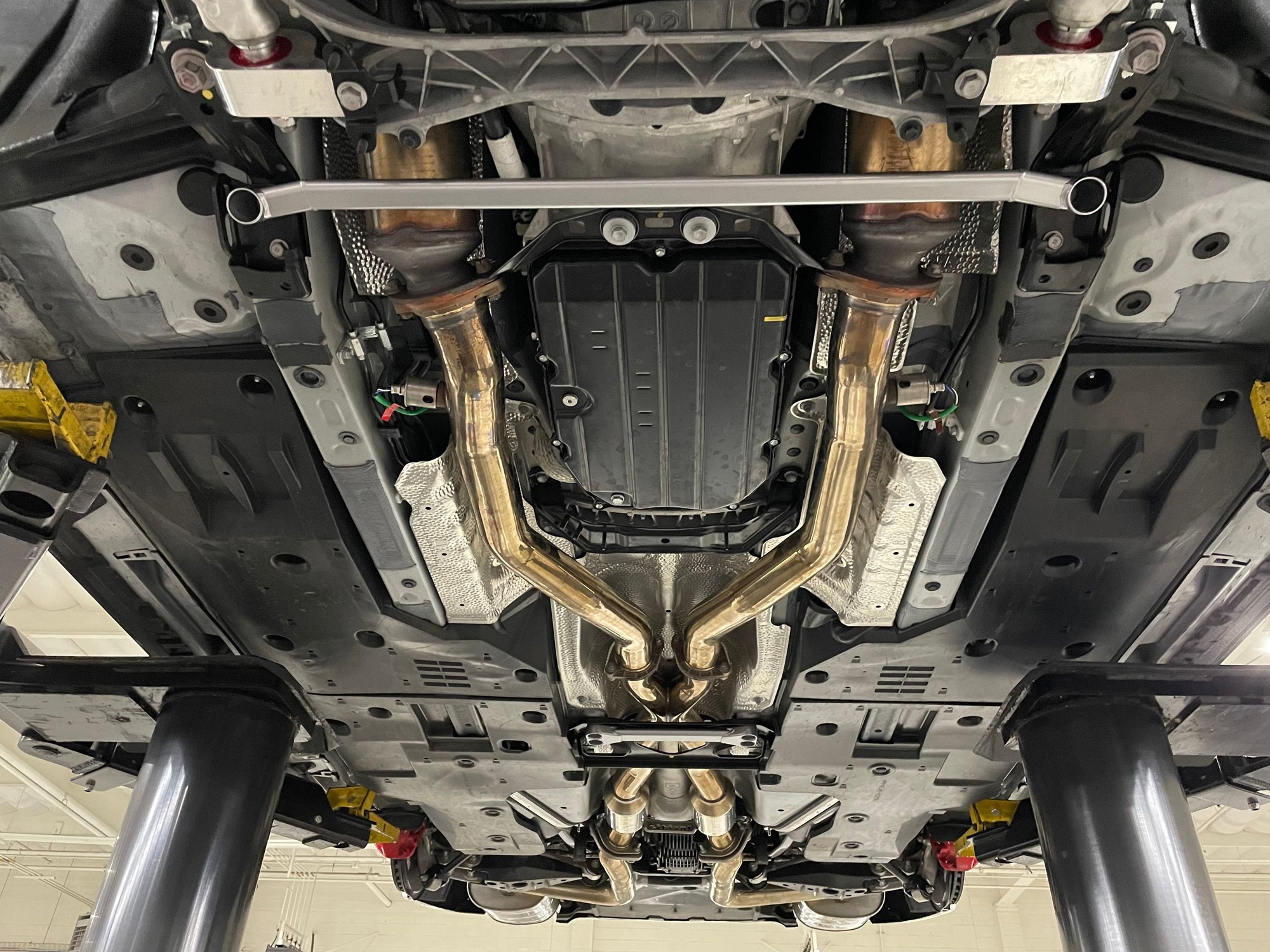

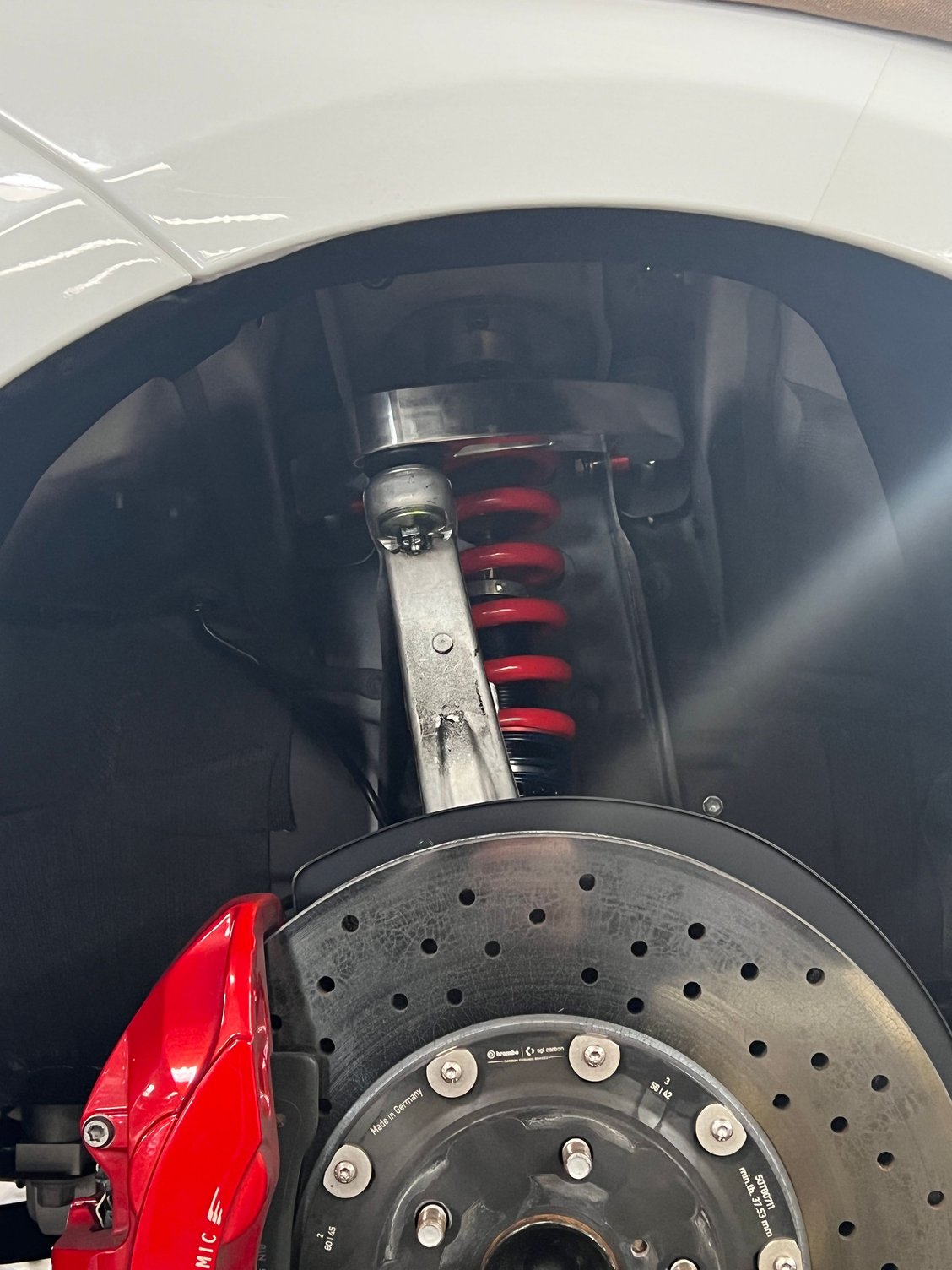

The “hats” that go on top of the front shock towers to protect the connector for the active suspension wouldn’t safely fit with the shorter stud length on the penskes which means losing the brace to the firewall.
Rafi from RR-racing was able to come through by powder coating a brace this morning on short notice and should receive it tomorrow with overnight shipping.

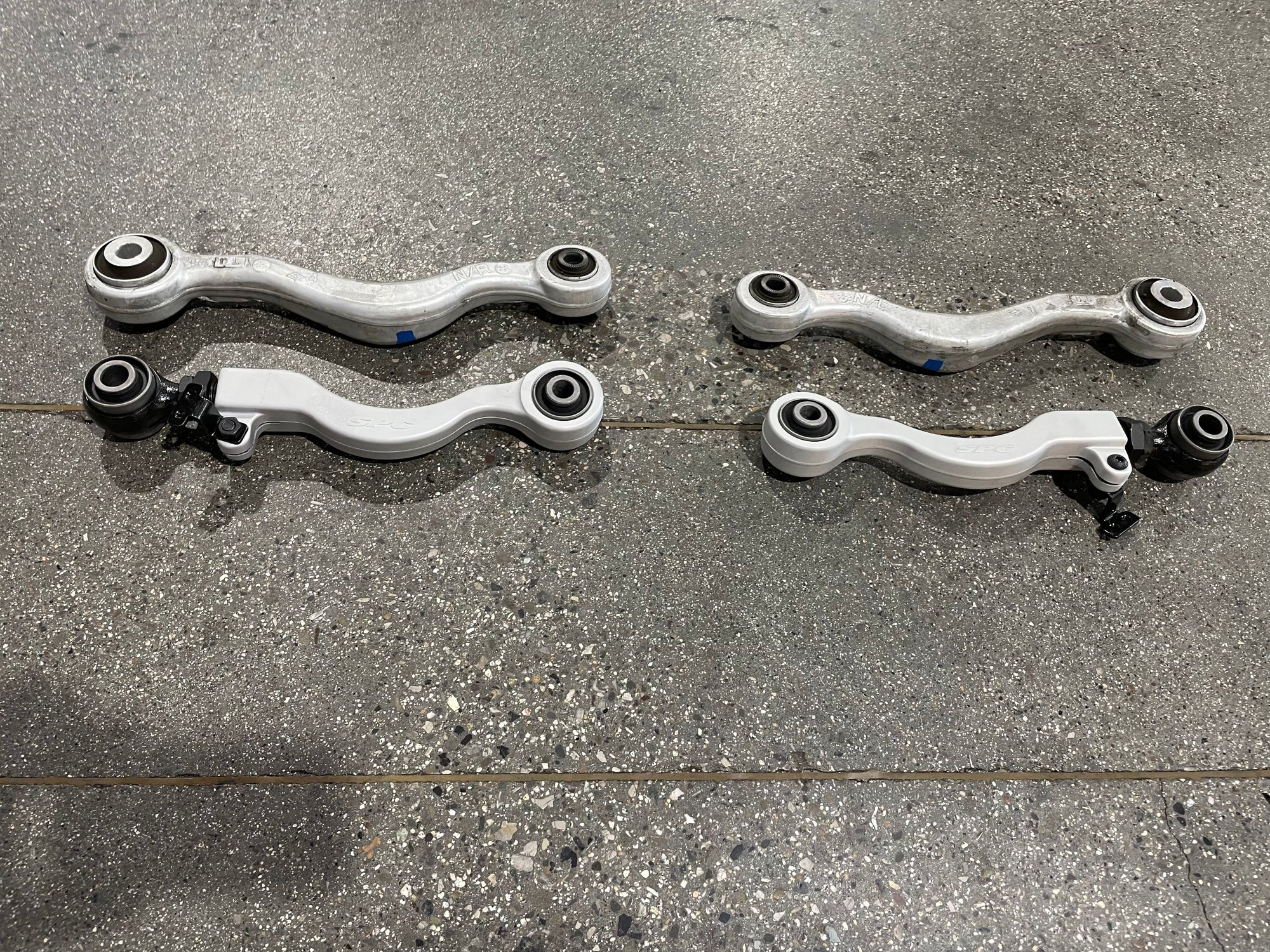

Small update.

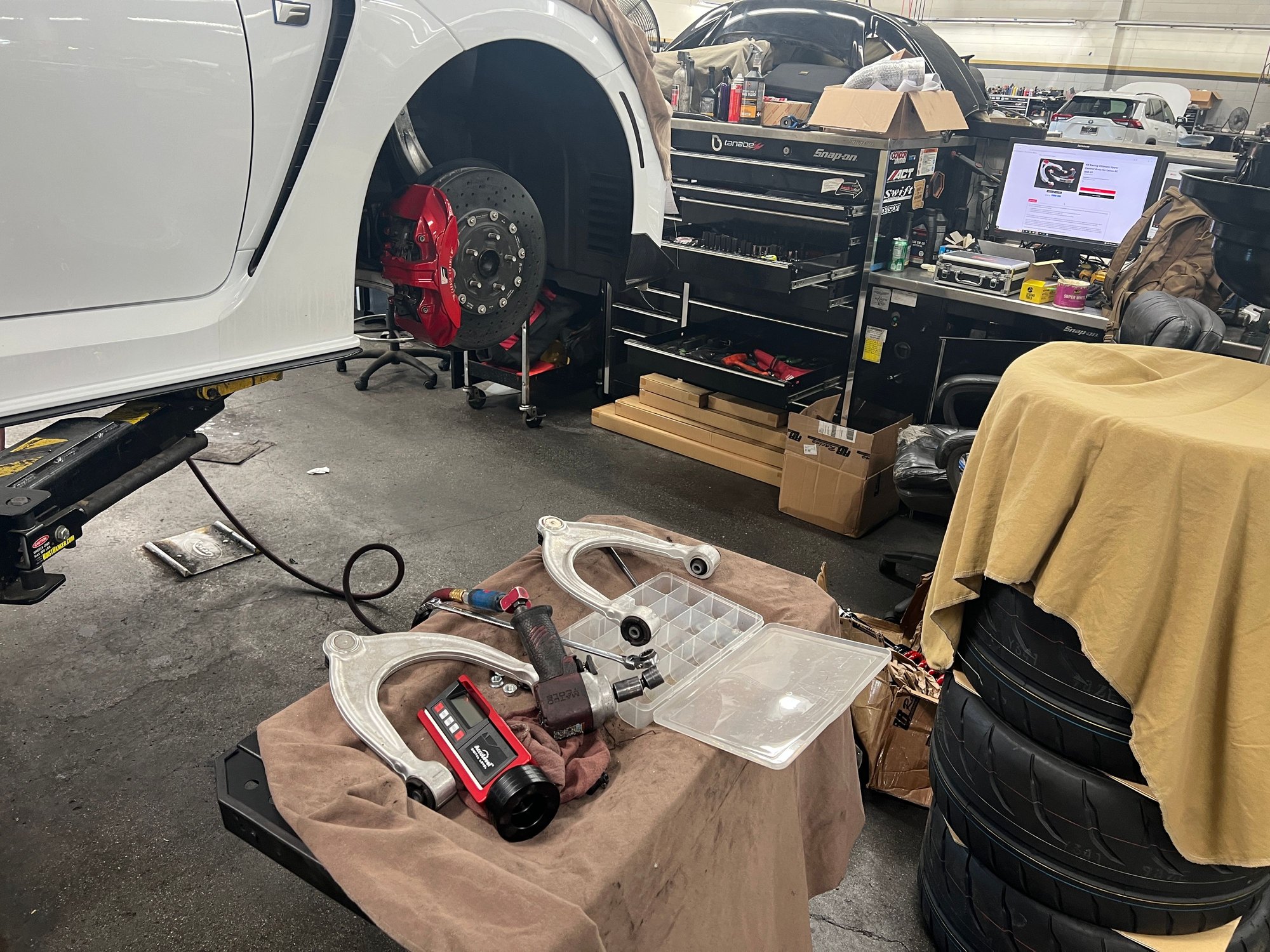

Rear camber needs adjustment to tuck in. Currently at ~+2deg. Setting this to ~-2deg will tuck in the top of the tire by 26.1in * sin(4) = 1.80in which is right about what we need. Adjustments and alignment should happen tonight.
Part of the toms bracing is in. Rear brace and rear top strut brace remain. RR brace arrived this morning and should also go tonight.
