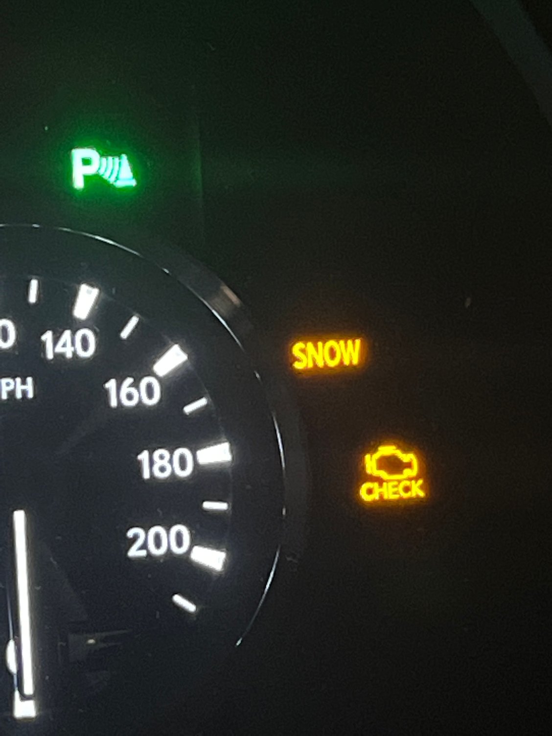

Swapping to the 2016 ECU made launch control map to "SNOW" Mode which my car doesn't have... But it has the light in the instrument cluster for it! We also could never get rid of an ECM/PCM communication error code thrown by the TCM module. Other symptoms were unavailability of drive mode selection, TRAC OFF light persistently on in the dash. Engine ran but unsure if transmission would've shifted as expected so I didn't move the car in this state.
