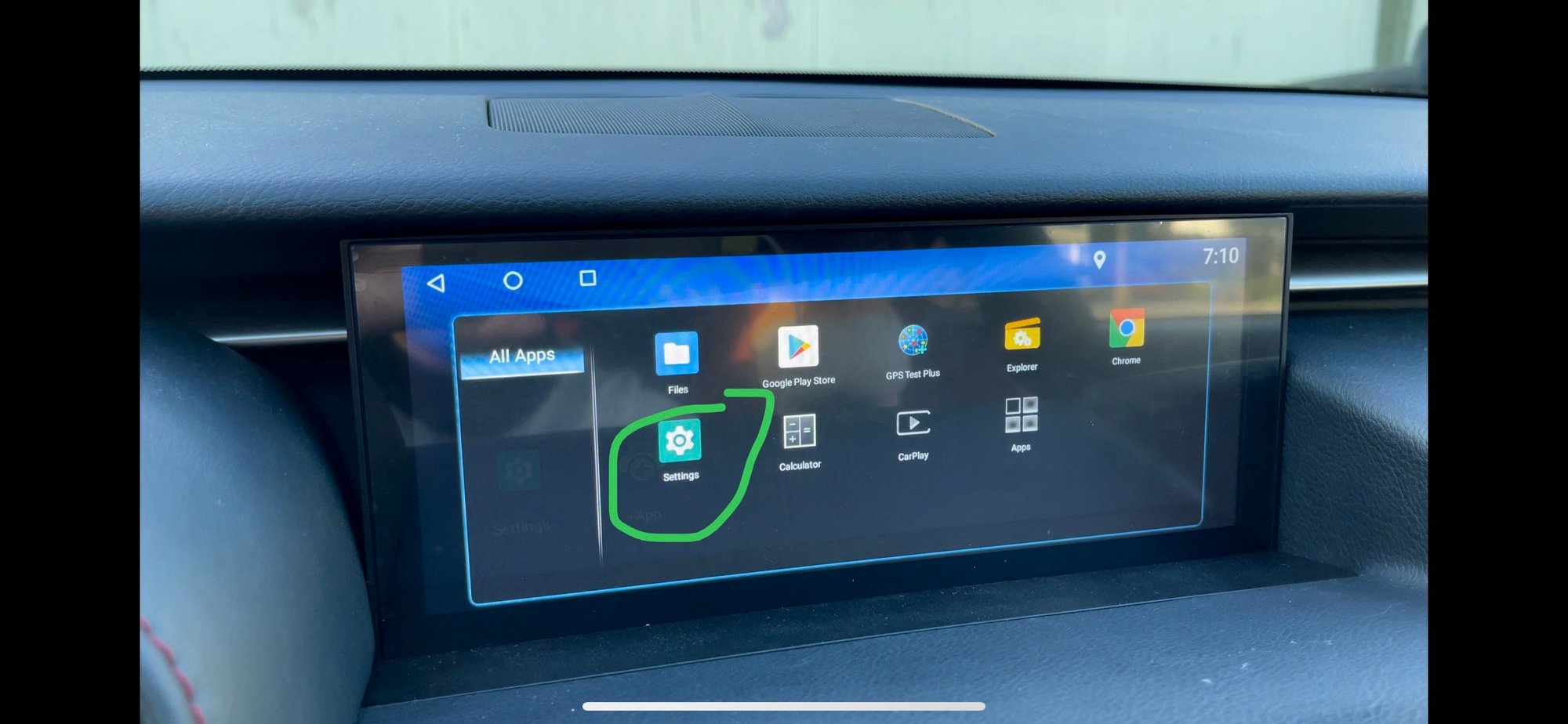

Update: I was missing it, and it fixed the issue!! Thanks man!! For those with the spazzy mouse issue go to the android settings and select "system," then "input," scroll to the bottom and click "advanced," and then "pointer speed." For me, 1/3 speed or less gets rid of the jumping.

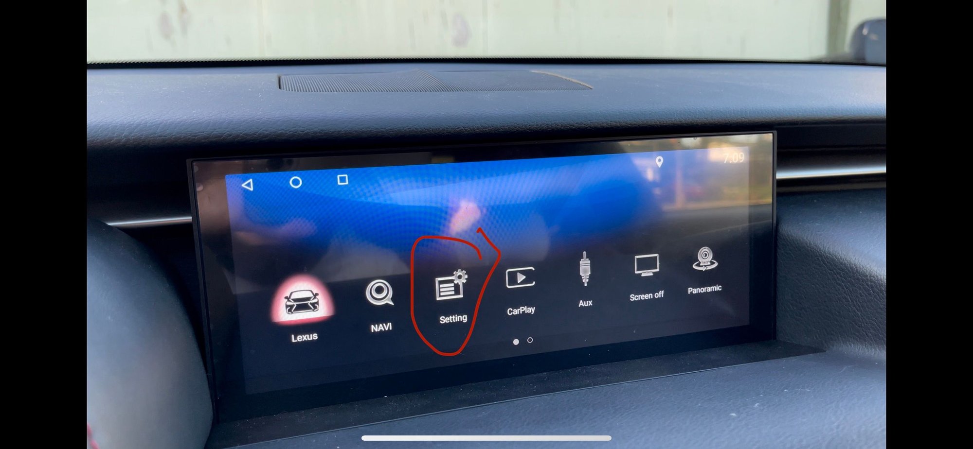

Confirmed, this fixed it! For anyone else that is confused (like me at first), rcJten is referring to the actual android settings located here, on the "+App" menu located on the 2nd page of the Lexion menu, not the "SETTING" menu located on the home screen, the steps are straightforward once you find the correct settings menu:
