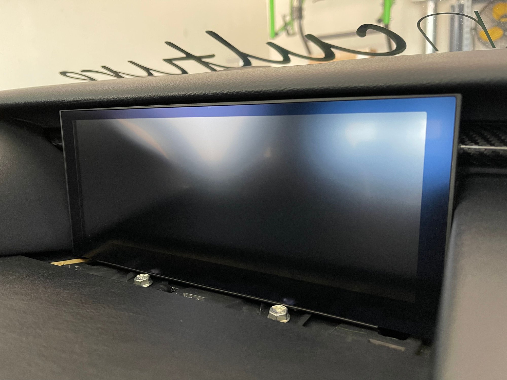

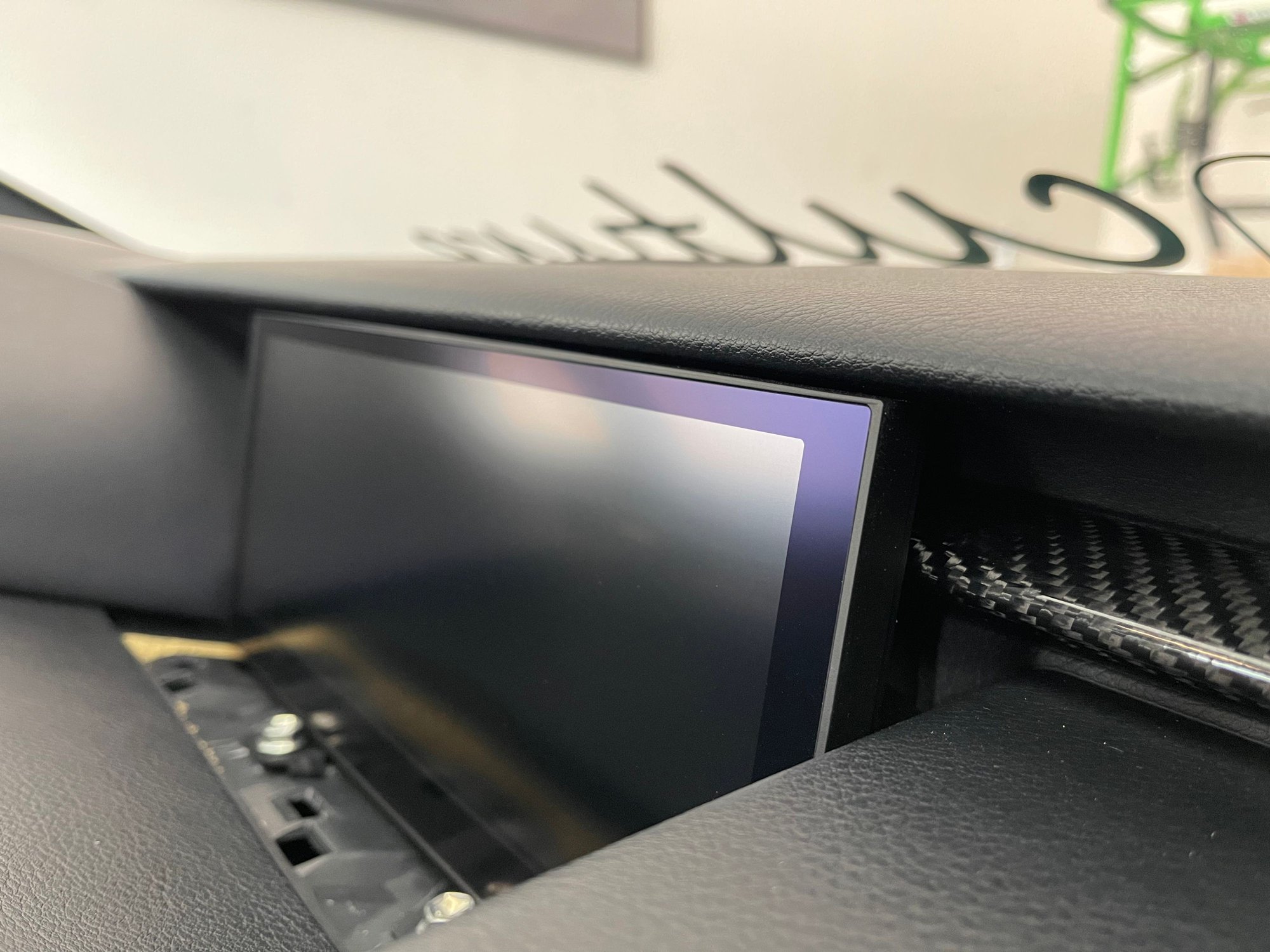

i have had mine for 2 months now no issues. You can use the OEM bolts to bolt it down screen sits flush. The OEM cover doesn’t fit because this screen is a bit thicker. They supply a replacement cover trim piece which doesn’t fit perfectly as it’s a little small. I had debating on trimming down the OEM trim piece but didn’t do it.

1. The trim piece that covers the bolts. yes that’s the supplied one from Lexion. It’s more black than the OEM color but since you can’t see it while driving or in passenger seat it doesn’t bother me that much. The usb still works meaning it charges but doesn’t interface with the new screen. I ran a usb cable from the unit to the side of the center console to have access to the wired CarPlay. I’m sure I could have ran that cable to the glove box and replace the OEM one but I didn’t do it.
2.yes this screen does stick out a bit more but still looks good.
3. Original bolts still work fine, a little bit tight to get them in there but if you’re careful they will fit just fine.
4. Reverse camera works perfect.
- parking sensors still function perfectly
- the reverse lines still move when turning, I my self have them turned off as I don’t like them. I have simple ones one where it just shows two lines.
I hope this information helps.
