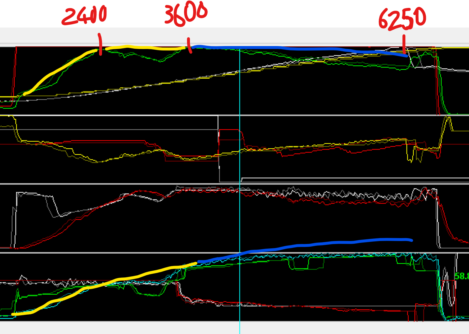

For sure. I understand what you mean, though the OV tune on mine makes the car pretty quick above 4k rpm, as another user mentioned a few replies back. If anything, I hope OV/VF or D3 can make the yellow parts of the engine load and MAF curves below possible someday. This can certainly be achieved using factory hardware.
The blue parts of the curves represent what I hope for in a hybrid turbo upgrade, once boost controls have all been figured out. In the absence of such, a hybrid turbo would probably let actual boost readings reach target boost levels, lower the charge air temperature a bit (through greater efficiency), and allow a little more aggressive timing. There can still be gains, but $/hp and/or $/tq probably wouldn't make much sense.

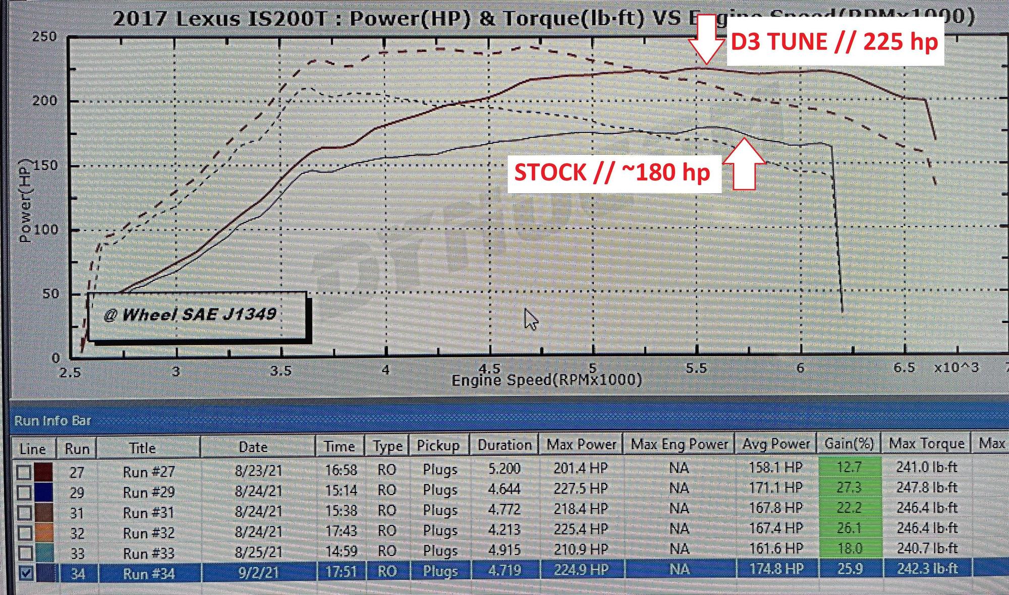

BIG NEWS
D3 cracked the code. (figuratively and literally)
Been running their tune for a little over a week and damn. It kicks. I hit the gas, downshift, and it launches.

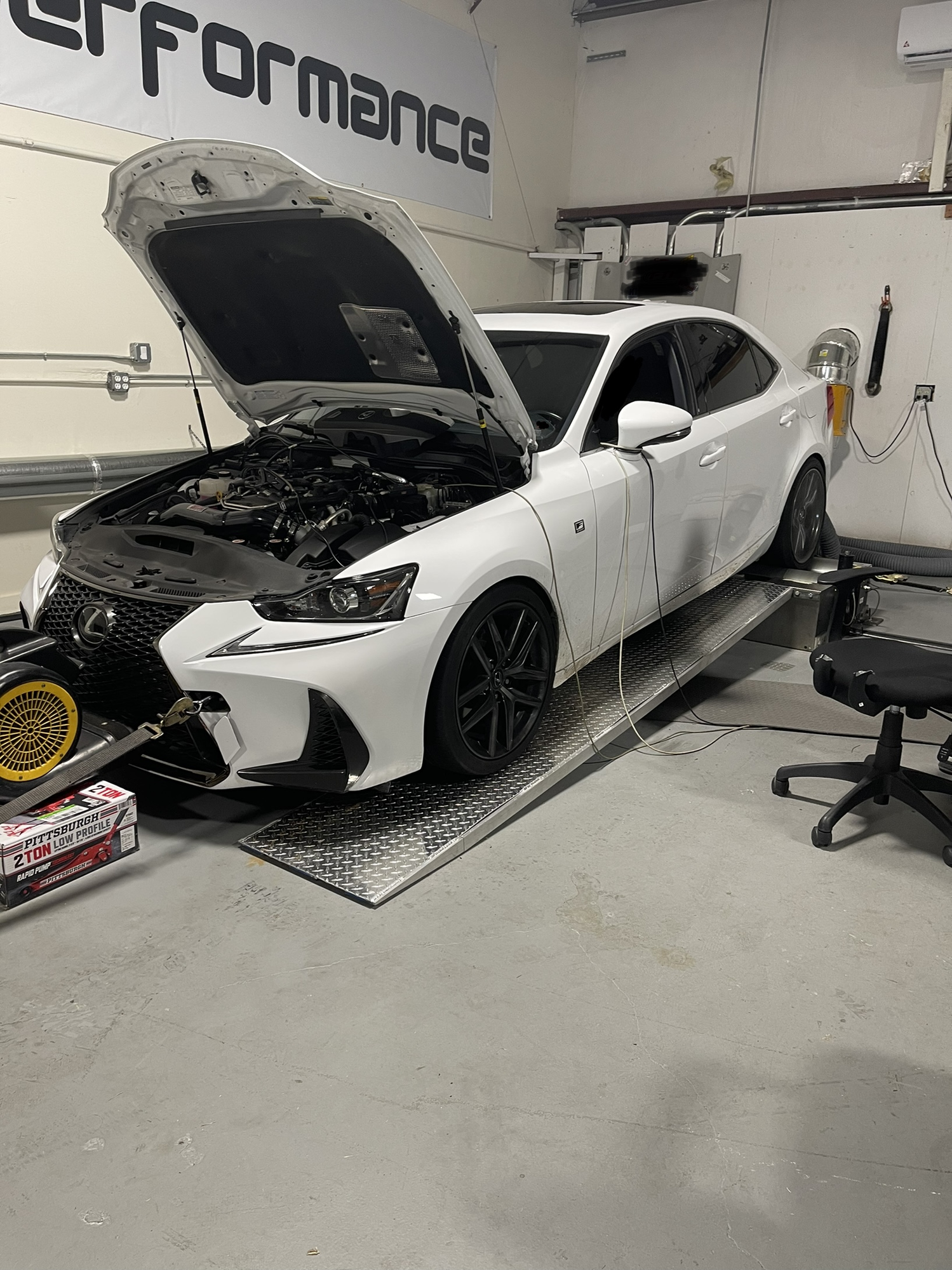

The guys over there dyno'd my car and pushed it to the limit and the thing nearly hit 250 hp to the wheel, basically stock.
Only mod i have is bolt on, INJEN short ram intake.
Waiting on an HPS charge pipe to push it further. currently running the tune they sell on their shop and i swear i havent seen a single upgrade with this much cost to performance ratio.
We're talking ~25% increase in power and torque for half the price of an exhaust.
Heres some dyno graphs and ill let them speak for themselves.
If you're looking for power, grab their tune. great team and great customer service.

Cool progress. Looks like they found a way to lift boost limits, seeing how gains were sustained past 6k. Anyone running a hybrid turbo like the one from GotTuned on a D3 tune?

Fazzi, thanks for the update, 45hp gain over stock is really solid. I am quite interested in moving from my current OV tune to the D3 tune.
