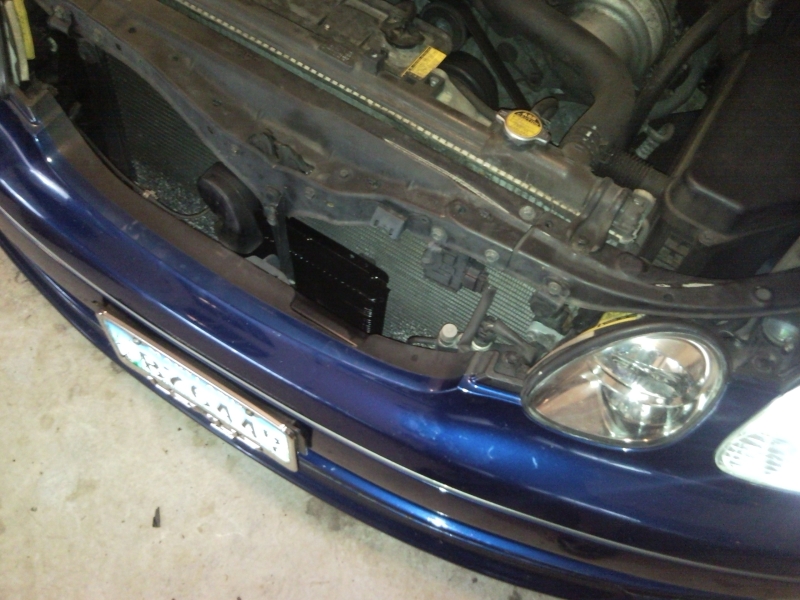

i just installed mine today guys.. it went well.. longer than expected but well.. taking bumper off was most time consuming lol n mounting cooler.. but i dont get it do you guys take out the condenser to attach the tranny coolers to them.. cuz the radiator is behind that then the fans lol.. so i assumed you guys take the condenser out then mount the tranny cooler but i did mine a diff way.. i got the B&M70264 kit but might wanna get a taller but same width cooler.. we'll see.. runs great tho!!

You don't need to take off the condenser and didn't need to remove the bumper. Me and most just install it in front of the condenser.

here's mine installed...
