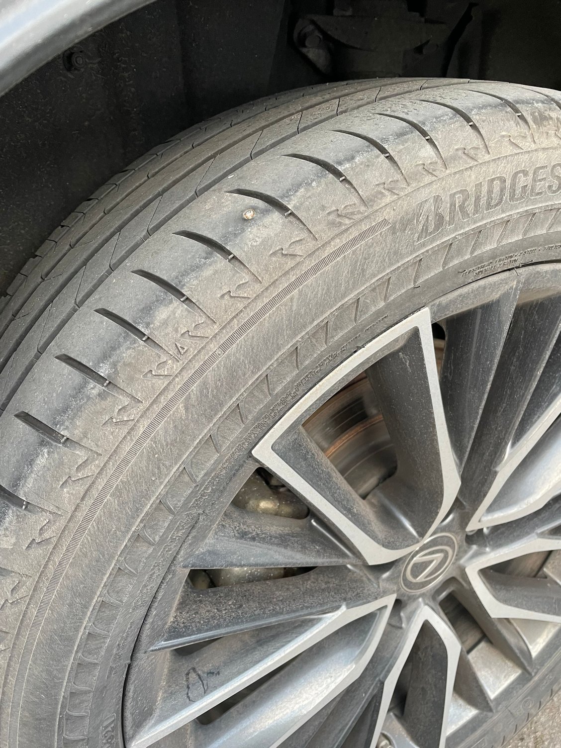

I had a screw in my 20 inch Runflat in Feb 23 when the car was a year old and had 10k miles on it.
The tyre was unrepairable due to the closeness to the edge.
I replaced just the one tyre with an identical Bridgestone tyre but the other 3 tyres remained on the car. I would not have agreed to replace both.
At 30k miles (last November) I replaced all 4 with fresh Bridgestone RFL tyres.
PS My wheels and tyres are not normally that dirty! I had just driven 460 miles in freezing wet conditions and tons of salt on the roads. 😱
