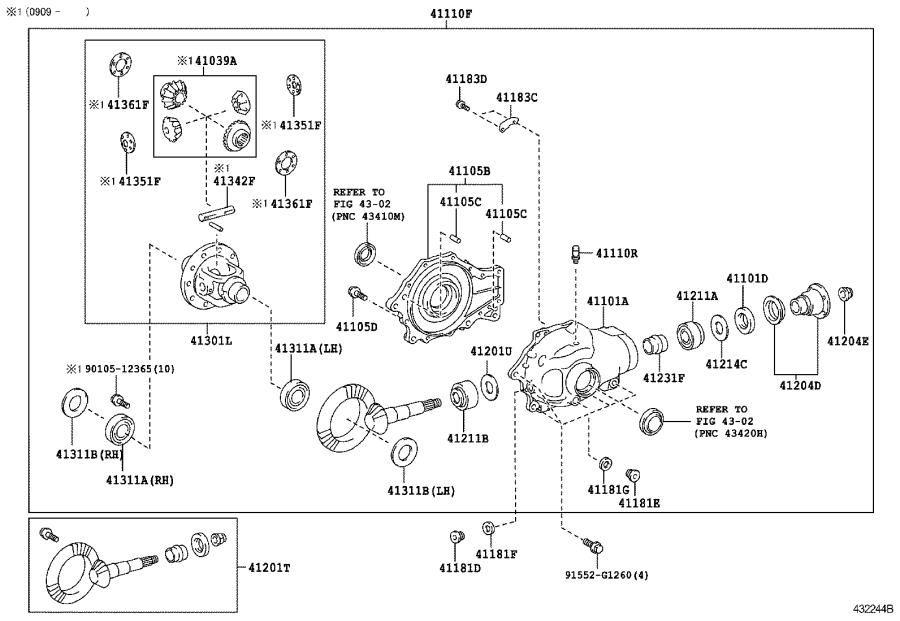

No, I had so little time to finish. The front differential fill plug is marked as 41181D and the rear one is 41110H on the attached diagrams.
Things I learned: you have to remove protecting housing from power steering wire harness, unbolt the same harness from the frame to allow aligning 10mm hex with the plug, and the diff needs to be raised a little bit. I used a stock jack for that. Don't be in hurry, it is very easy to round off the plug.
