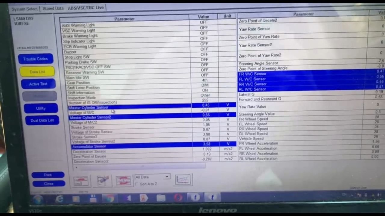

So I've performed a brake bleeding as per tutorial using "Actuator has been removed" function. Everything went smooth except last step bleeding RL contour.
While I held a pedal depressed, and my fellow opened a bleeding pot, compressor started running and there was a knocking noise coming from actuator.
However procedure went well, all calibrations were ok and DTC cleared.
But after test ride all codes went back, C1246 C1364 and now C1365, stating there is a trouble with accumulator pressure sensor.
So I checked Data via Techstream and found out that accmulator pressure sensor voltage is 4.8V, far beyond 4.0V limit. But at the same time, compressor keeps on building up the pressure, i.e. starting by itself every 10sec or so. And that's not clear to me. I undertsand if the pressure was low, so it tried to buid it up again, but what is the reason to pump fluid if it's already excessive?
Anyway, other thing I decided to do, is to disconnect the actuator and ECU harnesses to check resistance (found some tutorial for electronically controlled brakes diagnostics on Prius)
Then I discovered that ECU harness is different from that used on Prius, and just reconnected them back and voile, brakes feel good again.
So, can this DTCs be caused by a faulty harness connections?
I did test ride with Techstream connected and observed that from time to time there is a difference beetween Master Cylinder pressure sensor 1 and 2, and also benwee W/C sensors, and I think that's what triggers C1246 and C1364 codes. From time to time however I still have this barking noise from actuator, when coming to stop and starting from standstill. Here is a screenshot with Techstream Data List.
Glad that you performed the "Actuator has been removed" brake bleeding procedure successfully, but sorry to hear that it only temporarily solved the problem. The possible causes for all three trouble codes C1246, C1364 and C1365 are faulty actuator assembly, faulty skip control ECU, or bad electric wire connections to and from the actuator assembly. Your observation of accumulator voltage is outside the normal range of 4.7V - 5.3V confirms that the issue is within the actuator/pump assembly. Since the "Actuator has been removed" bleeding procedure didn't revive your actuator, at this point, I'd be more leaning towards that you brake actuator is giving up. Can C1246, C1364 and C1365 be caused by faculty harness connection? Yes, they could be, but given your description of the problem, I'd think that your brake actuator has more to do with the trouble codes than faulty wire connections. However, I am no Lexus certified technician and I am sharing with you what I'd do at this point if it were my own car, but I can be wrong here.
