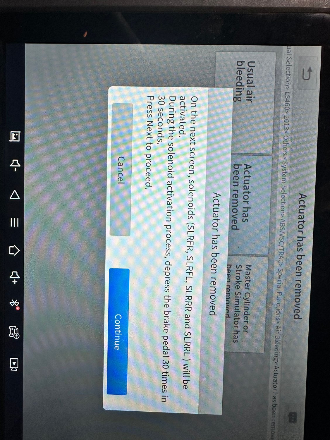

So unfortunately i ran into the C1256 and Code C1345
i do not have a Tech stream but have a xtool d8, it seems to have all the screens everyone is discussing here.
I was planning on bleeding the brakes and followed these procedures
1) disconnect 2 connectors to brake accumulator
2) zero down
3) Disable ECB
3) then went to the Usual Air bleeding option
Before i started any actual bleeding it mentioned someone holding down the pedal so i gave up and clicked cancel without performing anything.
that's when i started getting the codes and ive tried looking at posts 61 and 98 to follow those steps but have had no luck. i had purchased a battery charger so i dont believe it has anything to do with the battery voltage.
when trying to use the actuator has been removed feature i always fail the bleeding procedure right after the "on the next screen solenoids (slrfr, slrfl, slrrr and slrrl) will be activated during the solenoid activation process, depress the brake pedal 30 times in 30 secs"
any suggestions would be greatly appreciated!
2) zero down
3) Disable ECB
The method of clearing DTC's C1256 and C1345 is described in Postings 61 and 98 of this thread. And the instruction is attached. You need Techstream (preferably Version 15 or above) to perform this procedure. Please note that the precondition is that your brake hardware is good (i.e., your accumulator and pump are functioning properly).

I did follow the instructions in the two posts, when I choose actuator has been removed it brings me to a few steps to start the bleeding process, which I am not going to do, the third step is where it fails, it asks me to pump the brake 30 times in 30 seconds then says air bleeding failed
