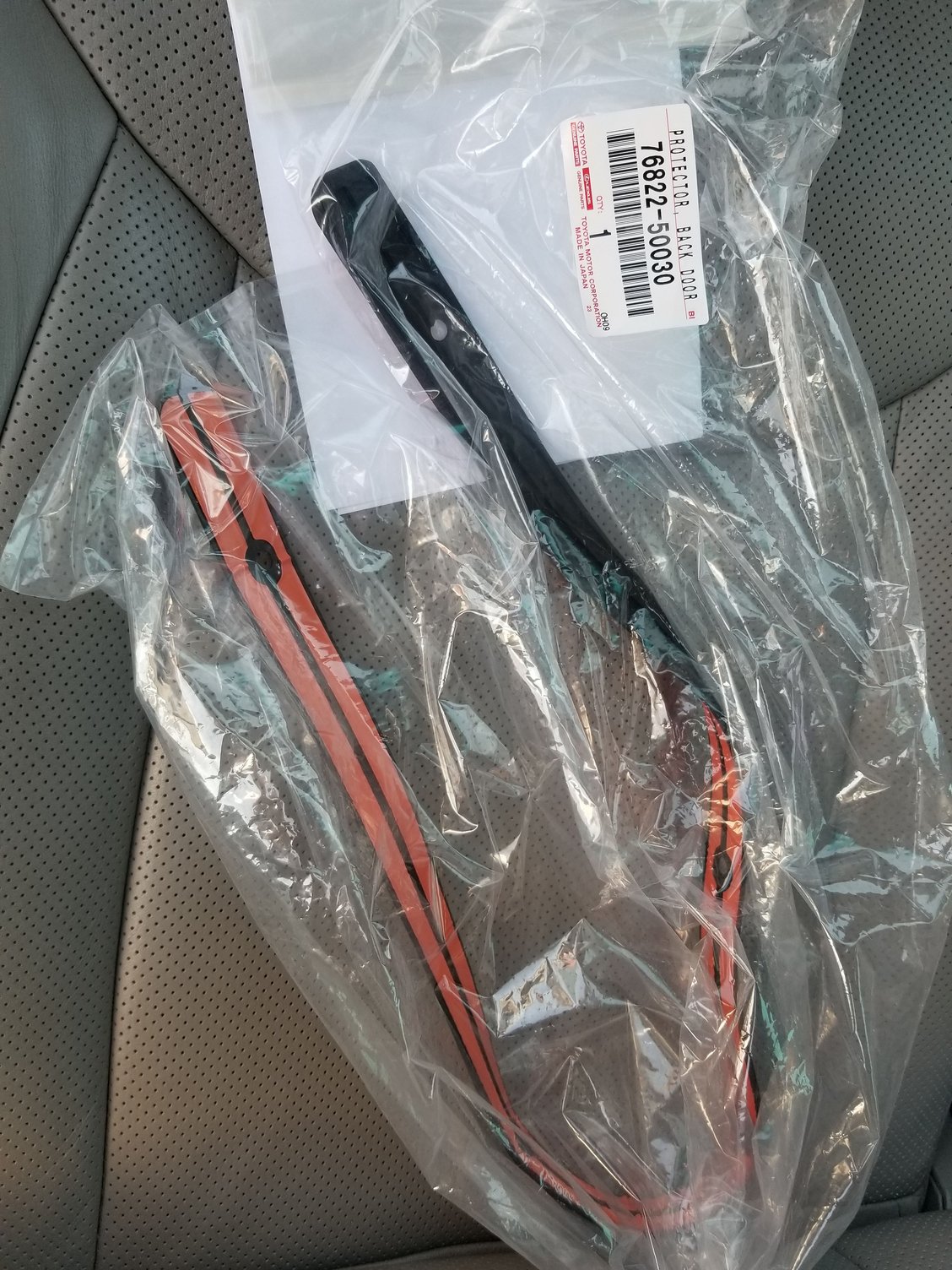

Thank you for the photos, aw001. Well, that is disappointing to hear about the drips still occurring, although it is a mystery why some 2014s have the rubber molding and some do not. Comotiger may have a point about time of build.
I picked up the part today. Below is the part number. It is pliable and appears to adhere with just adhesive. I had to take my 460 in for a coolant leak and wont have the car back for a few days.
Thanks, Fto1. The adhesive must be pretty strong.
If you are up for it, can you do a simple test? Record short videos of the drip before and after
installing the trim piece. If there is an appreciable improvement, I would install it too.

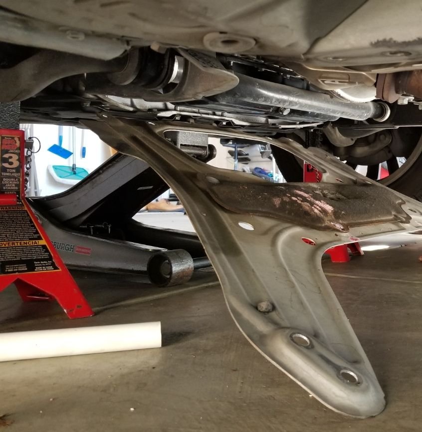

Oddly enough, no puddles...ever! And I think the car may have had this problem when I bought it at 70K miles but evaded discovery during the PPI. I don't fault my mechanic though because it is difficult to spot.
When I bought it, we would add a small amount of coolant every 5-10K miles. It seemed odd to me but not alarming. From time to time I also noticed the AC running super cold and I thought the auto-climate system was just trying to cool the cabin quickly during 100+ degrees outside (and much hotter inside).
At the last oil change, at 96,874 miles, I requested a tranny fluid drain-and-fill. That is when my mechanic noticed some dried coolant around the transmission bell housing. He suspected a leaky valley plate at the center of the vee. I trust my mechanic but didnt want to part with $500 just yet until I could confirm some things on my own -- in case it was just residue from a water pump change or something.
I detailed the series of investigation in the following thread:
https://www.clublexus.com/forums/ls-...96k-miles.html
In short, my mechanic was correct and will make things right soon. There was never a puddle nor any indications of problems the past 27K miles of ownership. We went on a 500-mile roadtrip on Labor Day, including up hills while carrying four bicycles and the engine temperature never wandered away from middle. Even my first pass at scoping around the engine, with a wireless endoscope, didnt reveal anything. Now, a full coolant reservoir will deplete below the low line in four days, yet still no puddles. I suspect some of the underbody coverings are catching the drips and preventing puddles. Once I confirmed that then I brought the car in.

Thanks, Fto1 for the info and the other thread. Hope the fix works well. That's an expensive repair.

Below is the part number (for 2015-2017 LSes). I just got the LS back today after the coolant fix and haven't had time to apply the trunk molding yet. I will post a before-and-after video tomorrow with some water tests.
