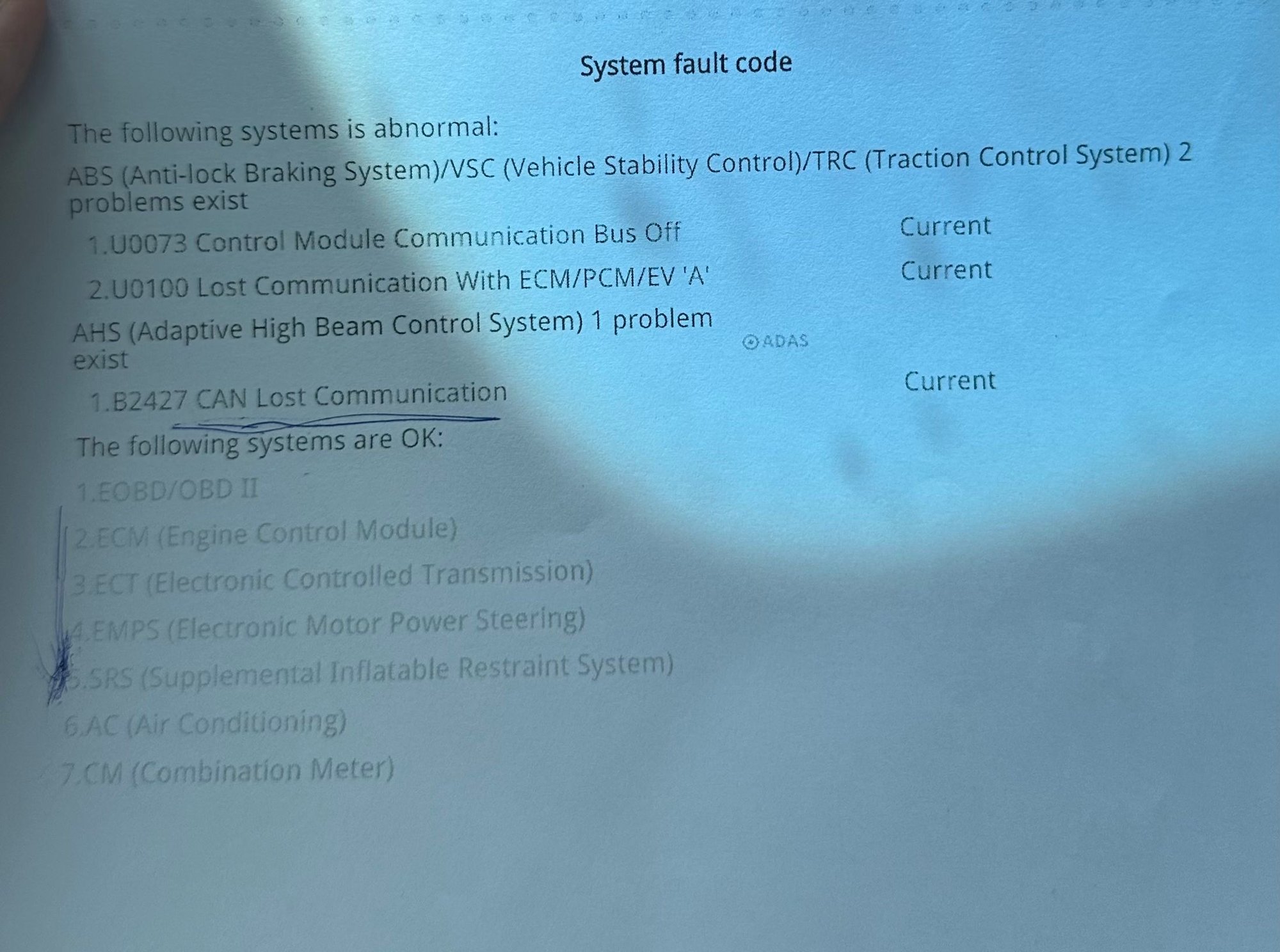

Did an OBD scan, and got these three codes:
U0073 Control Module Communication Bus off.
U0100 Lost Communication with ECM/PCM/EV.
B2427 CAN Lost Communication.
I think it has something to do with the wiring and connectors, but would really appreciate any advice.
