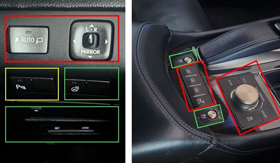

UPDATE:
On an added note, as another poster commented, cabin temperature seems to play a role - problem goes away when the cabin is warm.
This is how it appears when everything is working correctly: https://drive.google.com/file/d/1fgA...ew?usp=sharing
This is how it looks when the issue occurs: https://drive.google.com/file/d/18xk...ew?usp=sharing
Legend:
RED = Not working at all when issue is active
YELLOW = Button isn't working (but the actual feature is still working tho if I had it on by default)
GREEN = Working as intended even when issue is active
UPDATED: FIXED
Replaced the mirror switch assembly (I bought a used one from beforward as I'm on RHD) and it resolved all the issues above.
Last edited by dansonted; Aug 6, 2025 at 10:49 PM. Reason: Added links to symptoms

Good to know thanks! I'll keep you posted once I send mine to the autoshop. In the meantime, I’ve uploaded two video links and an image—just wanted to check if these are the same controls you're having issues with too.
Watched the videos and seen the pictures, having the same problem exactly.
