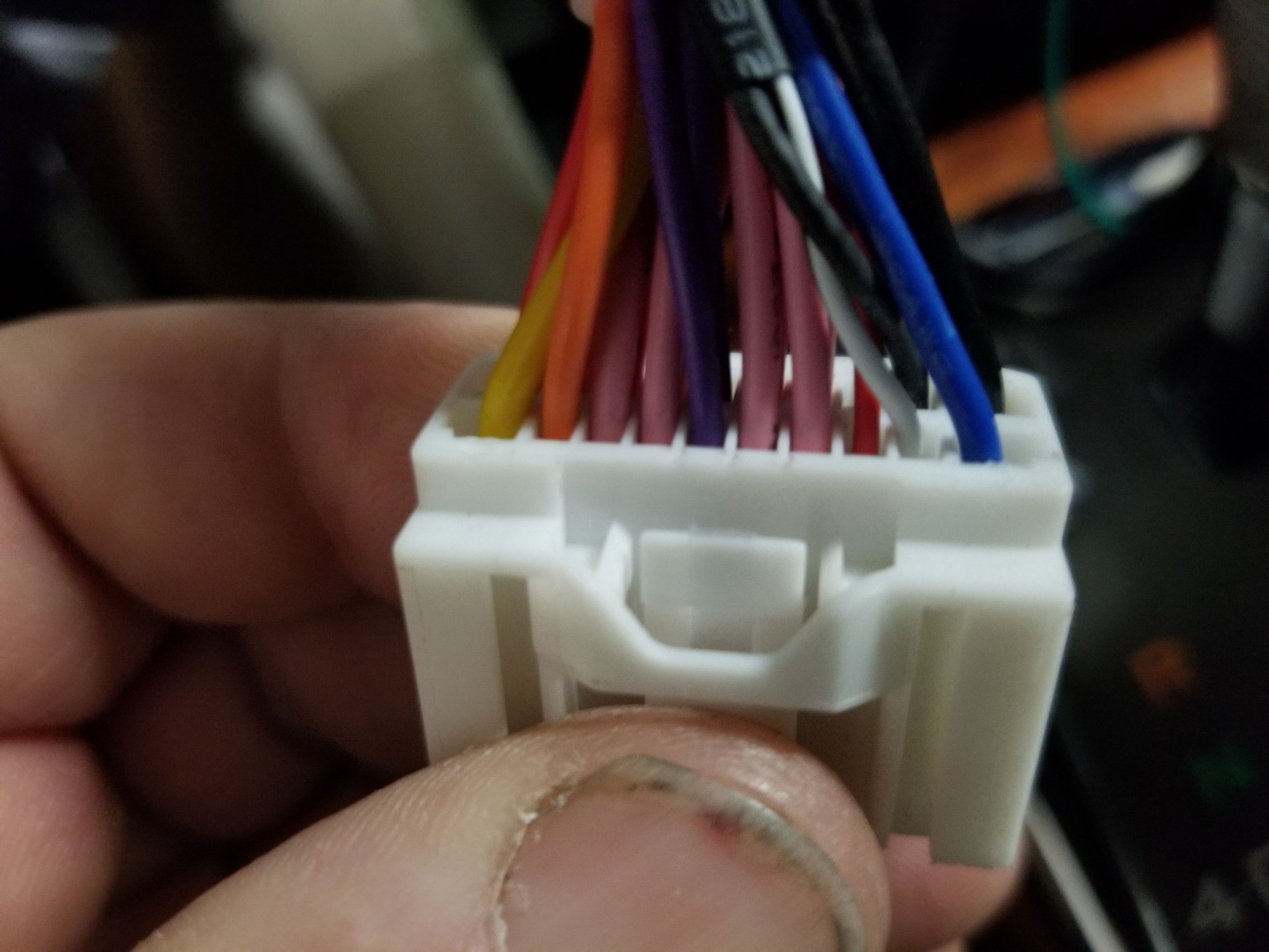

Originally Posted by almeshtaq
lovelexus3 , NL5
Can you please show the wires color of this connector and zoom in. if possible from top and bottom.
I need to figure out order of wires and which pin-out for each wire.
Thanks in advanced for help.
Without opening it up, I only have one picture now. I just deleted them all on Monday. I do have a radio adapter coming and if it looks like it fits I will go in this weekend and can get a better shot and/or video.
This picture is posted by me in previous post.
I'm thinking that I may have received wires with different pinout which makes audio mute when plug the connector of the unit.

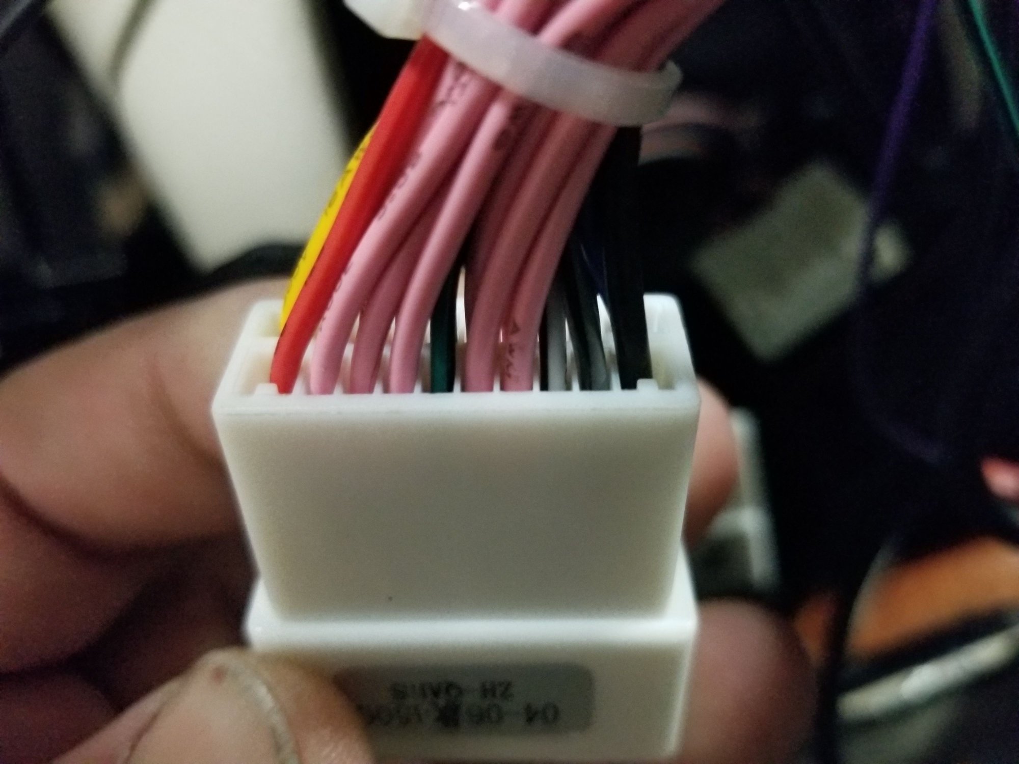

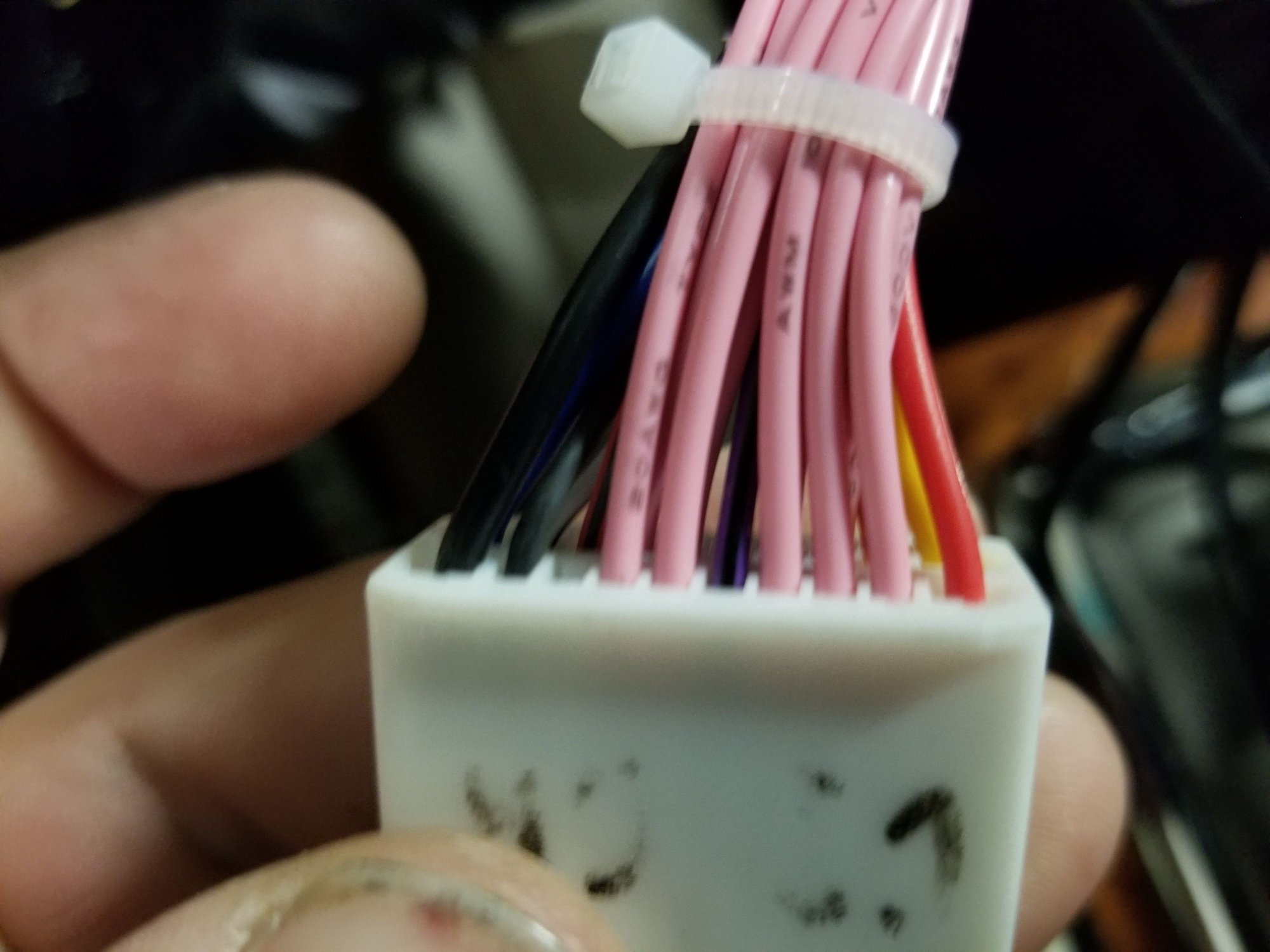

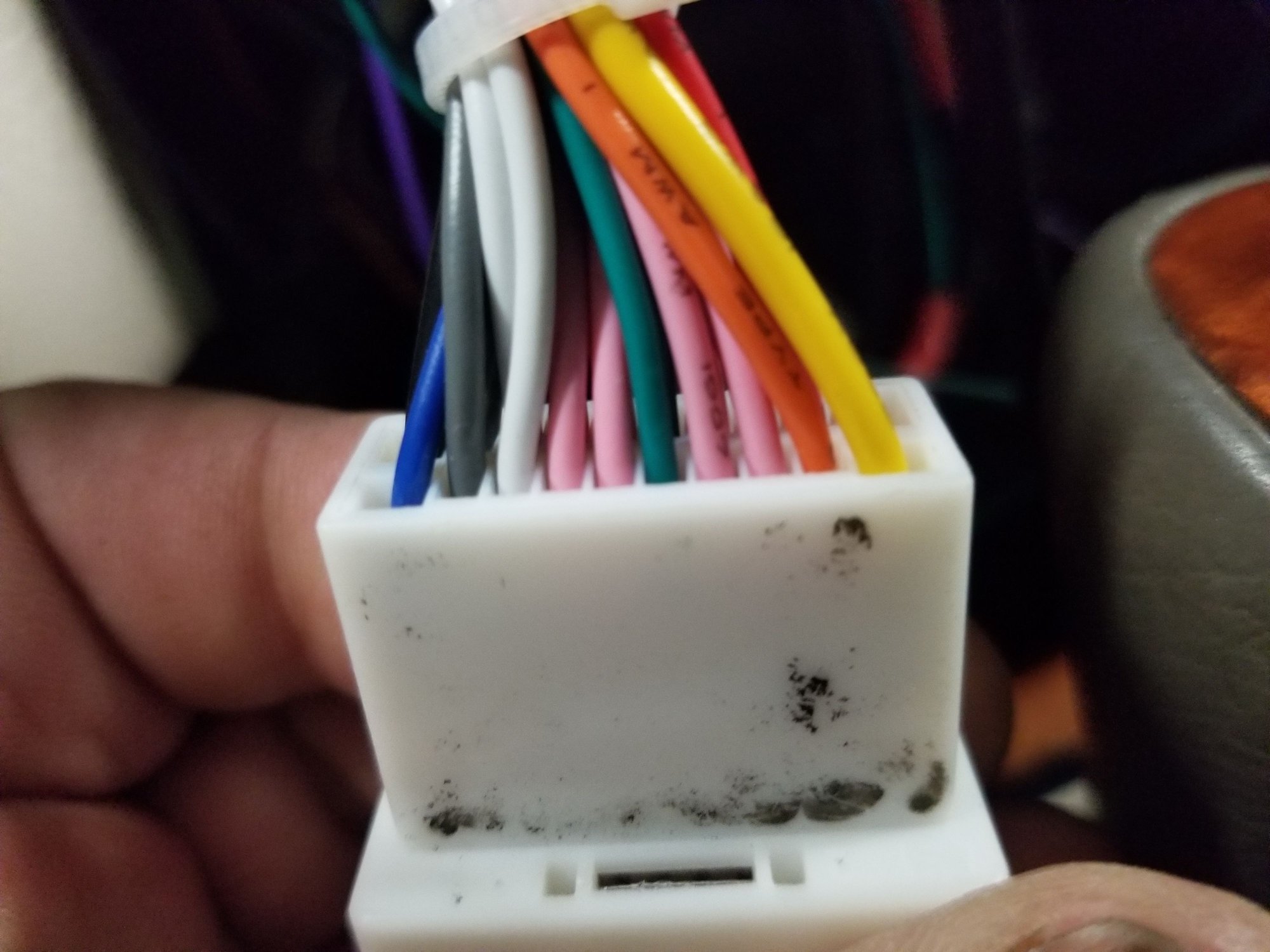

Hopefully this helps -
