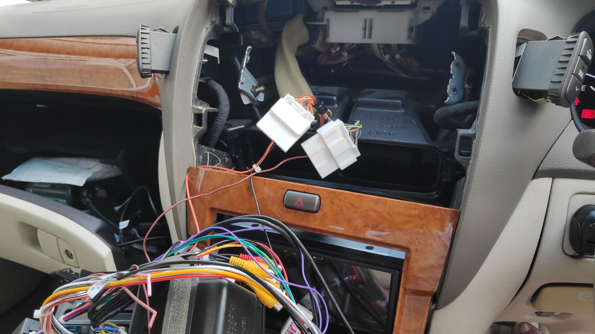

Hey guys so finally found the time to install the unit
it's been sitting at my house for about a week
it's 90° here in Philadelphia just been disgustingly humid but anyway I figured I had to do it while I have time
everything went smooth here are some pictures
I have a 2005 LS430 everything was Plug and Play
only problem is I'm getting no sound whatsoever
when I hit the CD player or the AM FM buttons no sound...
it shows that the disc is being read but no sound
and when I turn the volume up I hear a hiss
Any ideas guys?

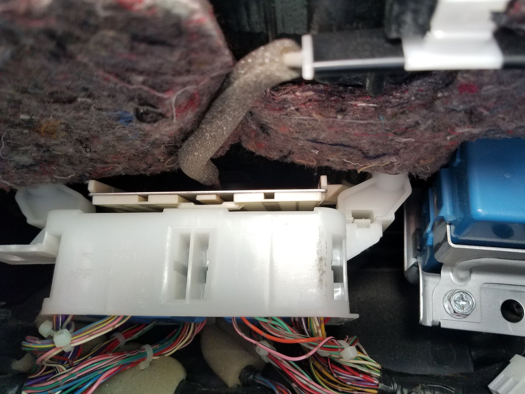

Hey guys so after tinkering for a while I was able to get sound to play through the internet and YouTube but I still can see the Factory CD changer read the disc but no sound comes out where you guys able to make sound come out from the factory CD changer or the factory FM tuner?
Also in my model are GPS antenna is right there where the new unit goes right behind the Old Navy screen would you have to do is buy an adapter and you don't even have to install the GPS antenna that came with this Android unit I don't know if anyone has mentioned it here's a picture
The OEM navigation GPS antenna sits right underneath the middle of the dashboard right behind the Android unit
In this picture it is the factory GPS antenna plug which will have to go to the Android literally couple inches I'm looking for an appropriate adapter now we'll post an update

Default OEM GPS antenna
2004-2006 Ls430 oem gps antenna located dead center inside dash /right behind oem screen... Disconnect plug to the right
2004-2006 Ls430 oem gps antenna plug antenna plug= square male
Thank you....
And here is another picture of our Factory OEM antenna location and the connector
I will have some time today to find the appropriate adapter that we need / will fit between the oem antenna, that's already sitting where it needs to be/ under the dash and the new Android unit
we need female Square on one end ( plugs into the factory GPS antenna) and a male round on the other end (plugs nto the Android unit)
