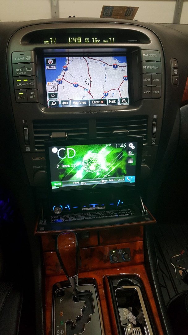

Old May 29, 2016 | 10:42 PM
toantran99's Avatar
toantran99
Joined: Jul 2009
Posts: 409
Likes: 32
You can remove the ML amp and your nav and AC will still work. You need the radio/cassette player
plug in. You can remove the 6 disc cd changer.

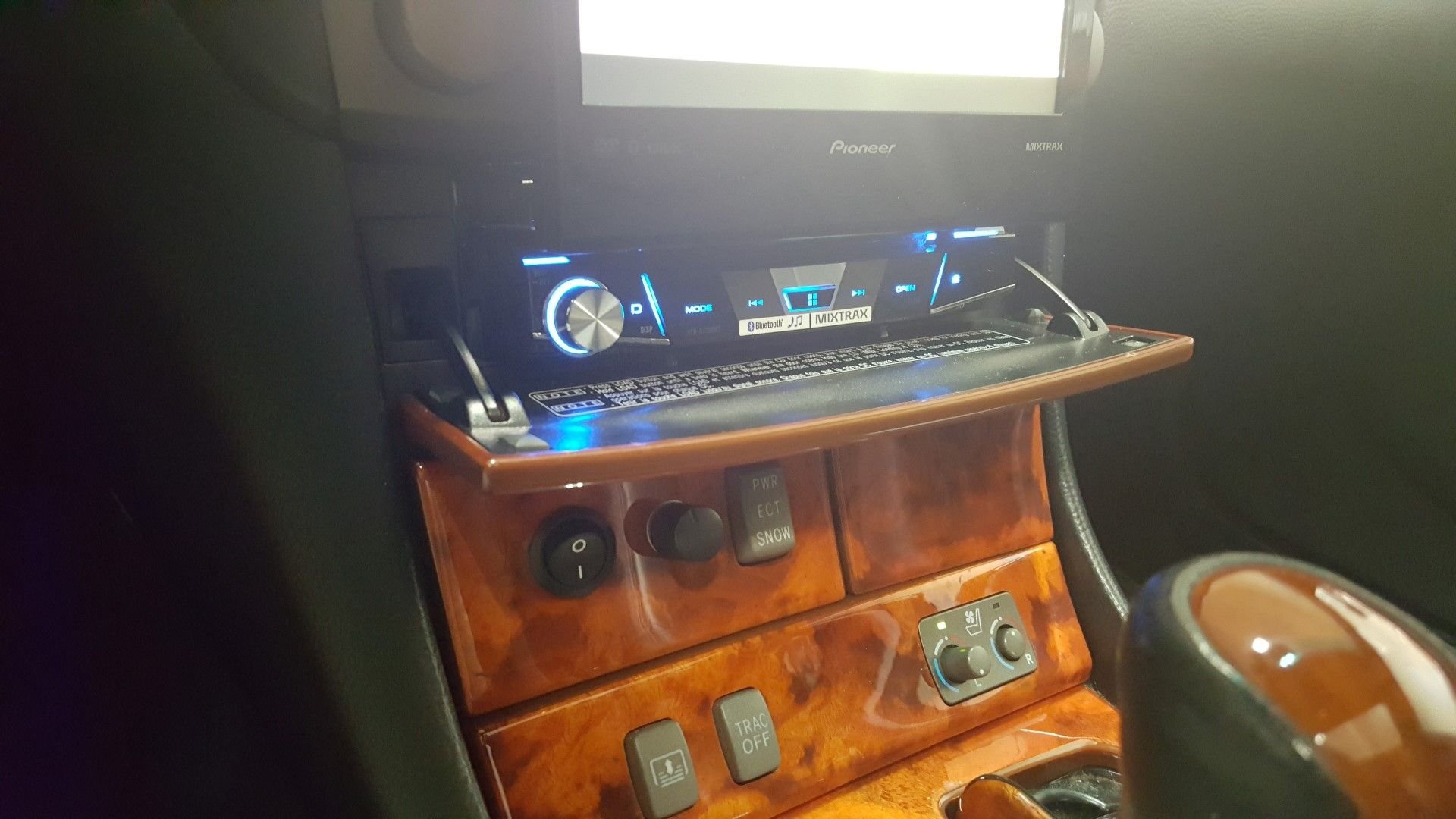

Old May 29, 2016 | 11:04 PM
toantran99's Avatar
toantran99
Joined: Jul 2009
Posts: 409
Likes: 32
My ML died and didn't want to spend $300 to $700 for a used one. Replaced all the speakers, tweeter in the rear, installed a JL audio W7, JL amp 2 channel for the sub, old Kicker 4 channel amp for the speakers, 100 rms watts. Front speakers I got Momo component and for the rear speakers, Polk db component speakers.
Added front camera, turn on with a switch that you see in the dash.
While I removed the amp, I dynamat pretty much the whole car.

Old May 30, 2016 | 12:48 PM
toantran99's Avatar
toantran99
Joined: Jul 2009
Posts: 409
Likes: 32
Originally Posted by PolishDude
cool thanks thats what i was looking for
Your welcome.
I did not use the beatsonic kit by the way. Lost steering wheel radio control but not a big deal.
