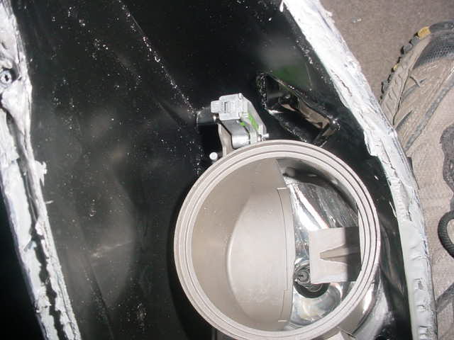

Ok, I may be a little late, but I have the answer to your problem. If you look at the inside of the projector it has not only a blocker plate to prevent the beam from shining high to prevent blind other motorist, it also has another blocker. What I did was take apart my lights, and took a grinder(the tab is cast ) and removed the upper, smaller tab. Now my lights focus correctly, it almost completely solved the problem. having a beam pattern like this, |_---_| sux. (I know you love my visual example there, haha). In retrospect I decided that it would have been allot easier to just use bmw projectors, in place of our halogen designed projectors. Although mine turned out fine in the end, You'll get a MUCH cleaner cutoff, and better color with a true HID projector. Ill take some pictures and attach them if you like. I'm planning on re-doing mine with new lenses, and bmw projectors, cause I fubared my lenses pretty bad in the learning process of doing this.

Took the words out of my mouth, just finished doing this project, here are a couple photos to look at to show what the tab looks like, before and after.
Attached Thumbnails Audi HID 9006 convert...Using new Audi components...Split beam problem...-mvc-013s.jpg

This solved my problem of split pattern, good luck its worth it, didn't take that much work, but that little tab is a pita to get out, metal casting is hard to dremel, or grind out.
Attached Thumbnails Audi HID 9006 convert...Using new Audi components...Split beam problem...-mvc-015s.jpg

yep, thats exactly what i did, nice work. Now, the question is, do your lights leak? cause i had to re-seal mine 4 times, and the left one STILL leaks a little. What i should have done is put a bunch of sealent in the channel where the lens fits in, where the factory sealant lives. But NOO, instead I assumed it would reseal without a problem, and just sealed around the outside after I realized my lights leaked live siv's!, hehe oh well. 96sc, How did you mount the bulbs? Once again, I should have ground the back edge off the lens and used a true HID bulb holder, but instaed I just ground the 9006 notches into the HID bulb, and epoxy'd it in place. But hey, at least those HID bulbs last a little while, hehe
