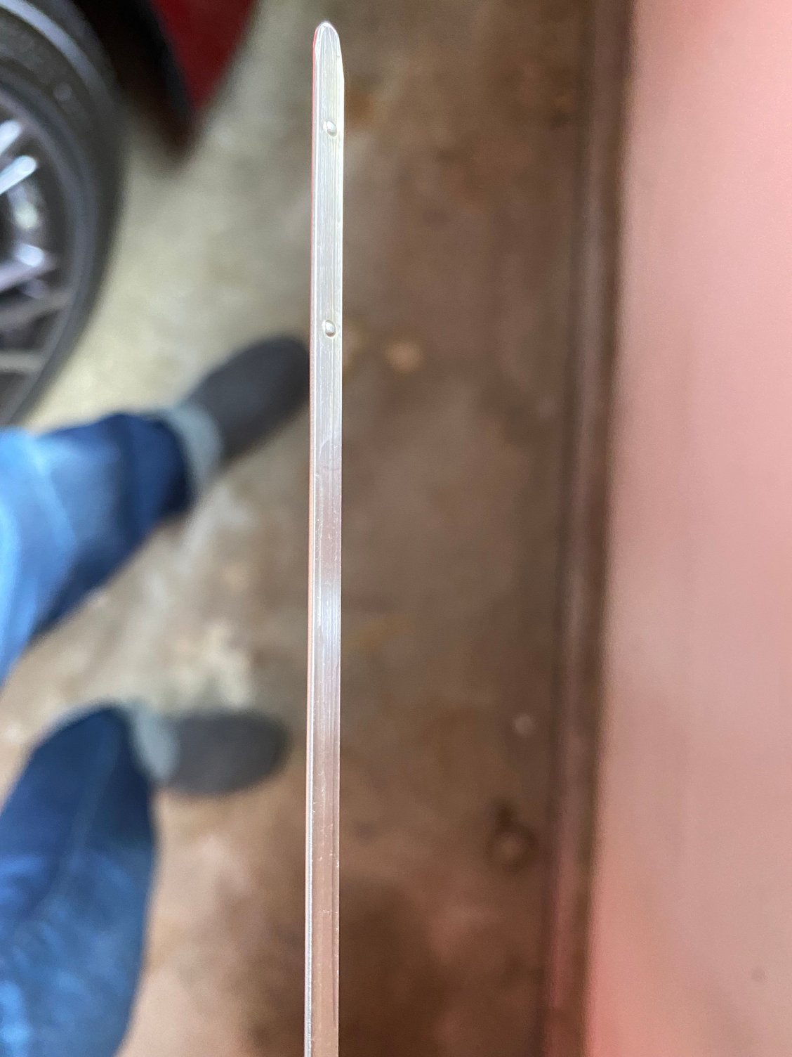

appreciate the concern, but how do you think i determined it was overfilled? i read the dipstick with clear oil after it was changed, well not right after, probably at least 150mi. after
one 'factor' may be i put ALL of the thin tubing down the dipstick before doing the extraction. maybe that goes into the bowels of the engine somewhere and gets something less pristine?
because the dipstick STILL looks i'd say 95% clear.

I think I can shed some light on this 9.1 qt Owners Manual spec VS the service computer screen saying 10 qt.
1st, they are using bulk oil fillers. Not individual quarts of oil. Now, I do not know whether they just push the 2018 LC 500 button OR if they actually have to dial in the number of quarts.
But what I think I CAN prove is that the 10 quart figure is DEFINITELY In THEIR system.
See below. I doubt very seriously anyone had to ask the tech how many quarts they used. I'm sure once they hit Oil Change, LC 500, Their SYSTEM pulled up the 10 quart figure.
You betcha I'll be asking their Service Manager why they feel the need to use .9 quart More Than The Factory says they should use.
Bruce in Fl.
