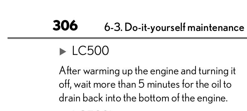

Originally Posted by sickpuppy
^^^^Oil should be checked with a cold engine. This allows the oil that's in the drivetrain to drip down into the pan.
decided to check the manual.
so you DO warm up the car, but then let it sit 5 minutes for the oil to drip down as you said, but apparently not a COLD engine.
so you DO warm up the car, but then let it sit 5 minutes for the oil to drip down as you said, but definitely not a COLD engine.
I have read this statement, and respect other people's opinions, but the direction provided is way too vague, as is alot of other info in the manual. I had also noted previously that the measured level was essentially the same whether the level was checked after a waiting period, when the engine was warmed up and when the level is checked with a cold engine. When all of the oil has drained back into the oil pan, in my opinion, this will provide a more accurate depiction of the volume of fluid relative to waiting 5 minutes after shutting off an engine.

FSM says this:
If you don't understand what this means, you probably should leave this to the shop. They do understand it.
For reference, the first time I can find this procedure in any Lexus service manual is in the 2001 LS430 manual. Prior to that it was far more vague, and basically said pull the dipstick and ensure the oil is between the marks.
