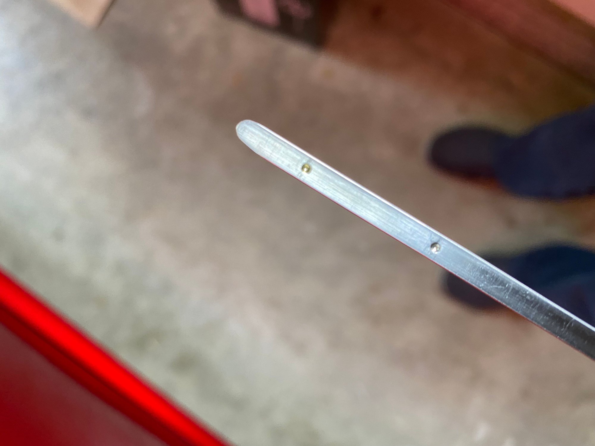

I decided today, to take matters into my own hands. The oil extractor was a good idea and I found a manually actuated device to purchase.
As is indicated in the pictures, I needed to remove just under 1 litre to get back into the normal operating range. I recognize that the level is almost impossible to see, but it is just below the full mark now on the dipstick.Everything is good again
