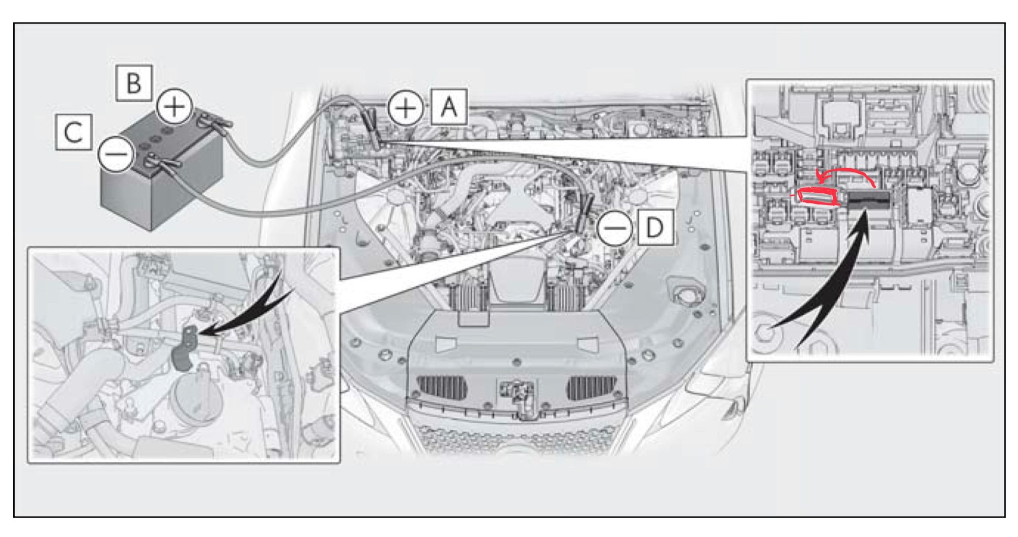

the pump has red/black clips to go positive/negative and they're not that long and coiled up, so i had to uncoil some of it and separate the red/black further because the distance needed between connections i used was about, i dunno, 3 feet. i picked these after reading the 'jump start' instructions in the manual.

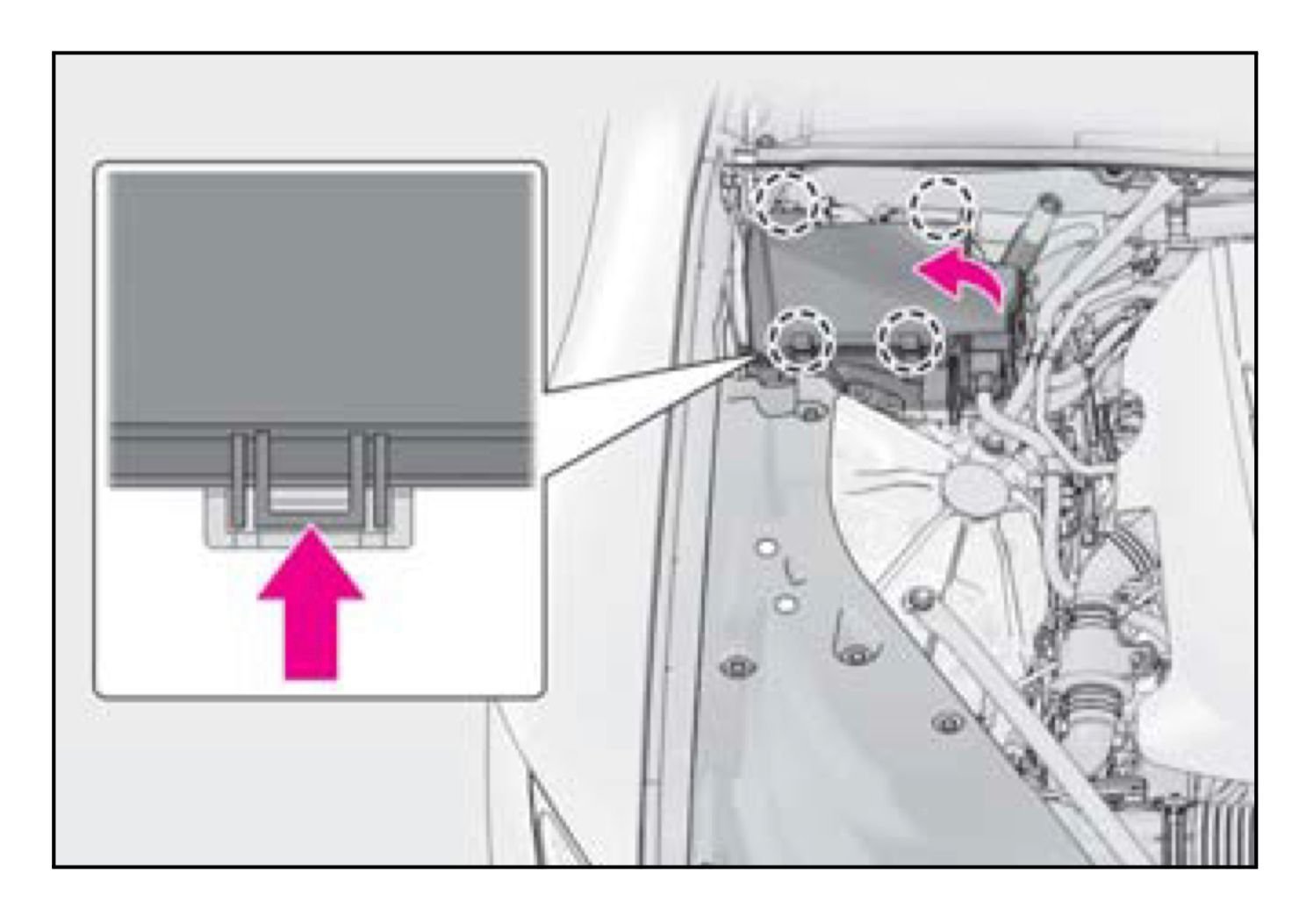

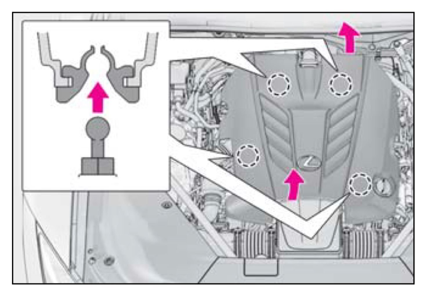

1) remove engine cover. (just pulls up off 4 posts, gently)
2. remove fuse box cover near passenger area (squeeze 4 clips and it lifts up)
3. there's a red small cover with a clip (i highlighted red cover in red). you press clip away from the cover and the cover hinges right to left to 'open' revealing a metal bar that the positive (red) pump clip will attach to. the negative black clip attaches to the post shown in the poor quality illustration below. it's not hard to find.
4. once the pump is hooked up, the 'thicker' tube goes into a container (i used an old quart plastic soup container). the thin tube goes down the dipstick hole.

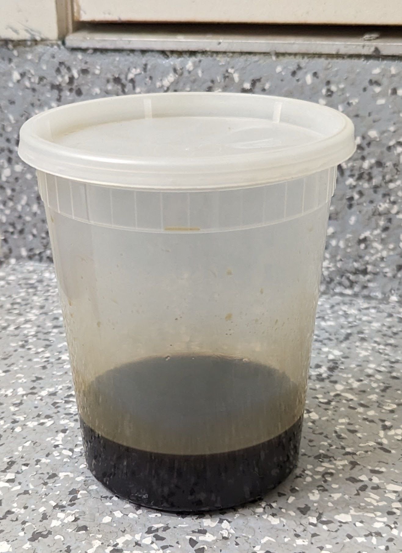

i didn't remove a ton of oil... here it is.
but now the dipstick reads at the high dot, rather than about 1/4" above it.

bit, i think you should change the oil. that looks really dark.
Would have been easier to maybe just change out the oil and add in the correct amount instead of sucking it out.
Old Oct 16, 2022 | 06:51 PM
  #71
Posts: 80,796
Likes: 3,990
i knew someone would post that, too.
edit: oil has been in the car for only 450 mi.
oil gets dark quickly.

Old Oct 16, 2022 | 11:09 PM
  #72
Brinylon's Avatar
Brinylon
Joined: Jun 2021
Posts: 192
Likes: 84
From: South East England
Well done but I agree that oil looks very dark and especially so after only 450 miles. Is it mineral or synthetic? I'm not wishing to worry you any further but even after my synthetic has been in for say 3000 miles, I struggle to see it on the dipstick. Perhaps yours went into the engine that or near that colour?
Old Oct 17, 2022 | 05:08 AM
  #73
Posts: 80,796
Likes: 3,990
nope, it was completely clear when it went in. and it's synthetic, i believe.
not sure how your oil is clear after 3000 mi., but then yours is a hybrid. ?
Old Oct 17, 2022 | 05:49 AM
  #74
Badhobz's Avatar
Badhobz
Joined: Mar 2015
Posts: 1,189
Likes: 823
From: Vancouver BC
Yes mine as well. When I dumped the initial oil from the factory at 1800km it came out pretty much clear. And those were some semi hard miles that should be quite brutal.
im worried that the yahoos in your dealership didn’t even change the oil. You’re absolutely sure it was clear before ? I don’t think it’s possible for the oil to turn that bad in 450 miles.
