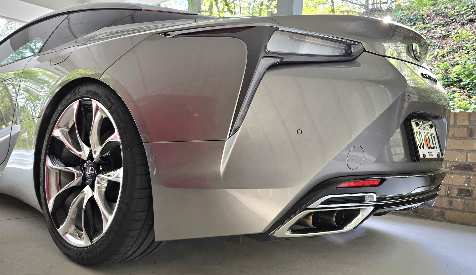

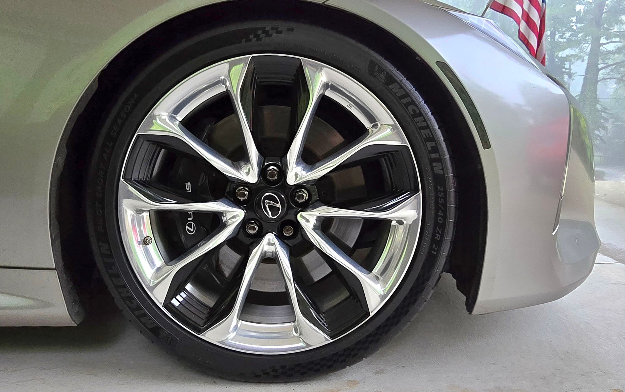

Just got these 2 weeks ago from Tire Rack, mobile install...
255/40/21.
295/35/21's on the rear. They had a good inventory when I ordered a few weeks ago.

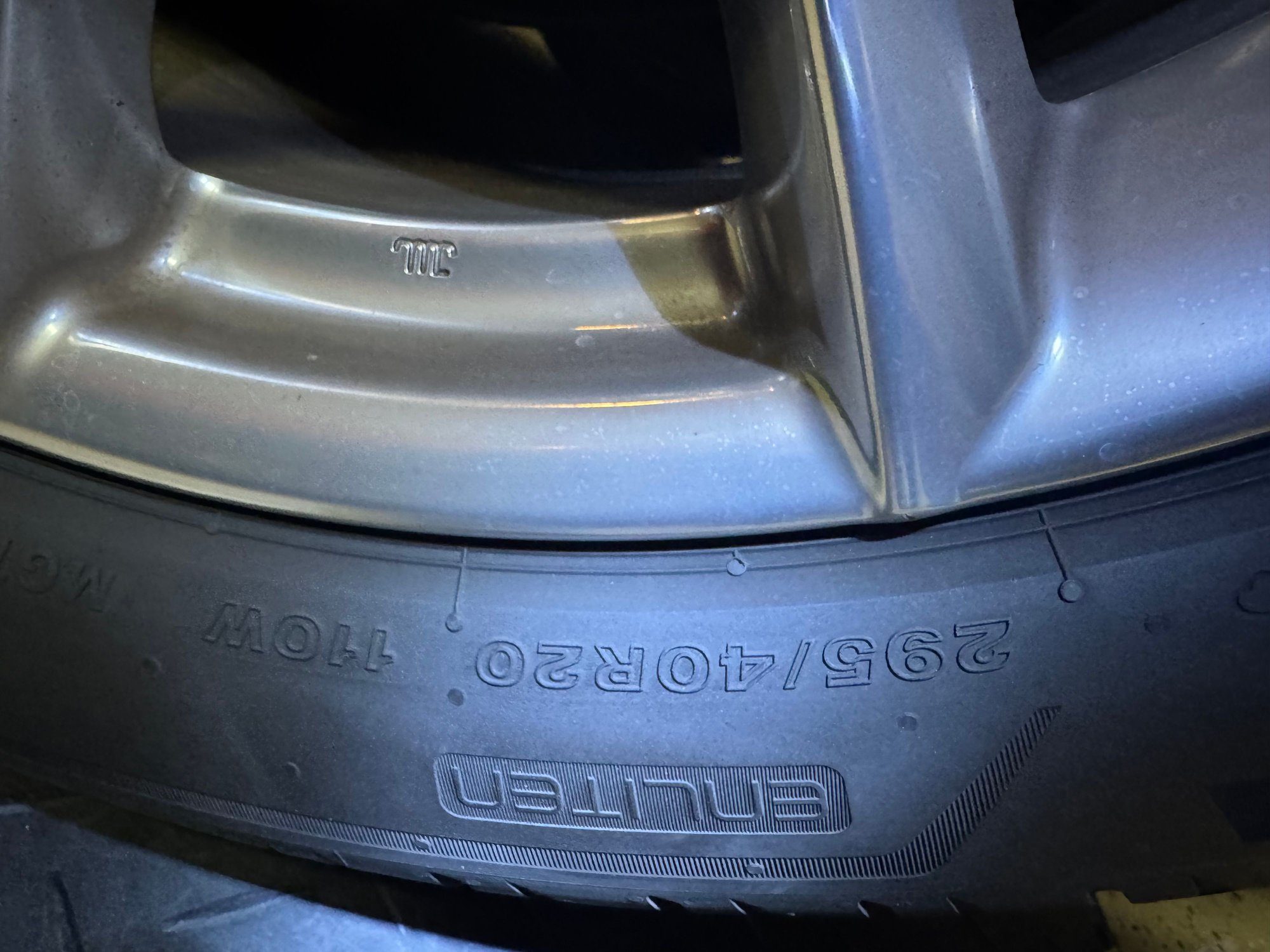

I would and did, on 20
I would and did, on 20" OEM wheels without any issues. Imo it's a much better look as well.

A 295 series tire, (20mm wider than a stock 275 series tire-about the width of a dime), is perfectly normal on a LC500 rear wheel.
Keep in mind that you're only adding 10mm, (about half the width of a dime), to each side/half of the wheel.
It's more about preference/availability as to which you choose.
This is a none issue with regards to safety.
