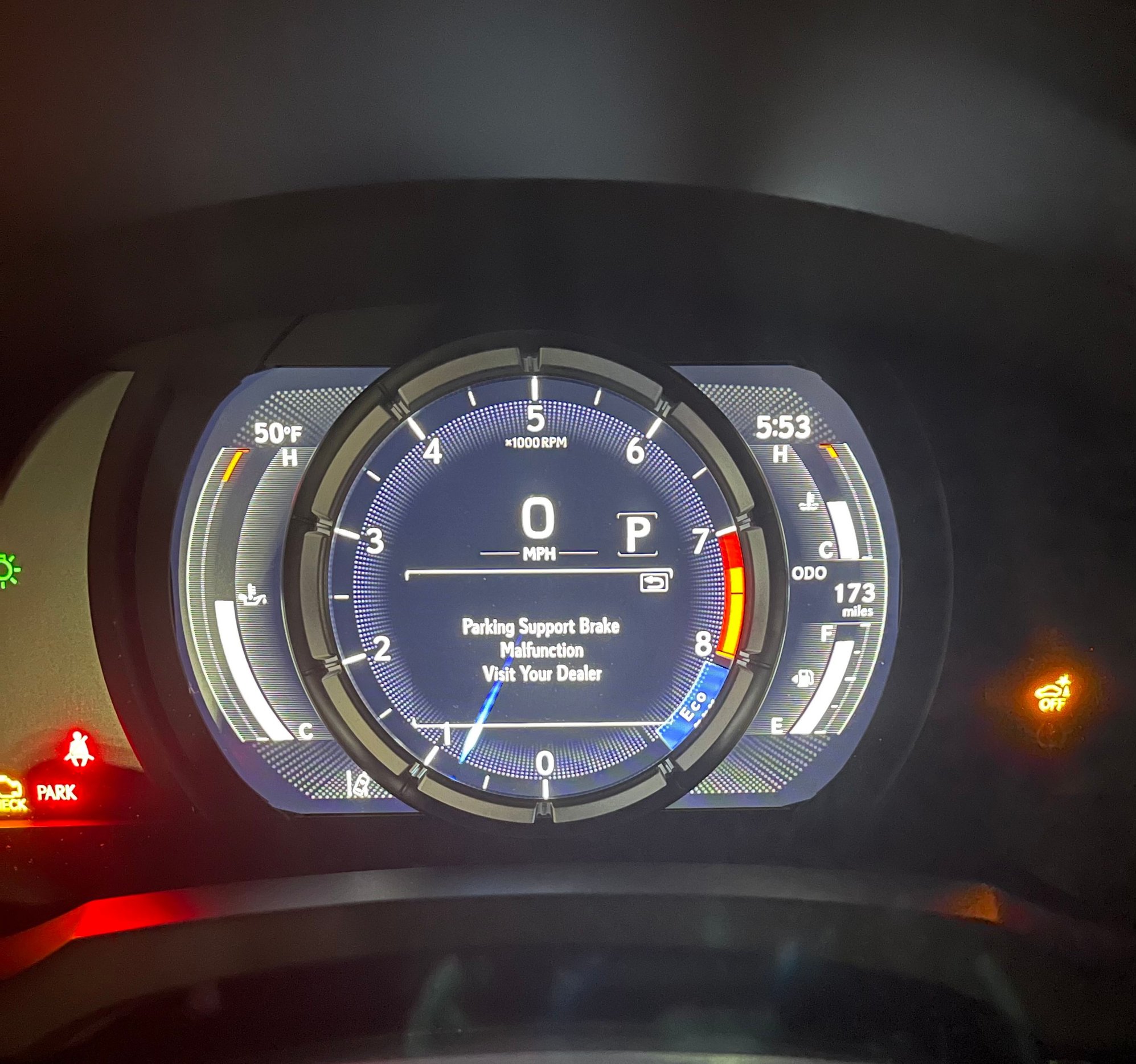

Well had #66 Launch out of the garage today for 3 time since I bought her. 127 miles CEL went off. Called dealership and made appointment for next Wednesday.
I point blank told them what the problem is going to be. and how to fix it. I am curious to see how fast I get it back. I live 1hr and 15 minutes from the dealership. Got setup for a loaner. I just want it fixed and no damage to the car otherwise ( I had that happen at a dealership before).
I know these are great cars and I am glad I was able to get one. Thank you all for this forum because I was aware of this issue before it occurred and it sure helps knowing it isn’t something serious.
cheers!
#66 today before CEL went off. Wanted to drive and enjoy the day before pollen got nasty. Guess it’s at least good I found out now to get the fix done.
***UPDATE***
I took the car in to Hendrick Lexus in Charlotte on 3/30/22 at 0730hrs. I had printed several posts from this thread to ensure they didn’t question what the issue was. Due to the rarity of the car the service manager was actually present when I was talking to the service rep. They told me that they had one other IS500 with the issue so far and may have the gaskets in stock. Sadly they only had one gasket but did overnight the a new pair and I picked up the car yesterday 3/31/22.
I have driven the car 50 miles so far with no issues. (Photos below) thanks again to all who contribute to this forum it was very helpful. They did note they found an exhaust leak.
